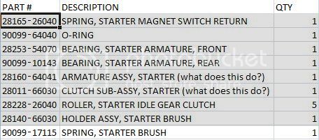

What does the Armature Assy do, and what does the Clutch Sub-Assy do?

I priced everything out and decided which parts to get, but I have another question. Thinking out loud, the grinding noise it makes when cold is likely from the gear attached to the clutch sub-assembly starting to spin before it shoots out and engages the flywheel, so that when it shoots out to grab the flywheel it grinds. The whirring noise it makes once the engine starts is likely from the same gear failing to disengage quickly enough from the flywheel. To me, it seems that where the gear moves back and forth on this clutch sub-assembly might be sticky or have some obstruction preventing it from shooting out and pulling back quickly, or whatever mechanism controls that might be worn out. So question is, does the clutch sub-assembly (28011-66030) itself control the up and down motion of the gear, or is it just the internal spring of the plunger that controls that up and down motion, and perhaps my existing spring is worn out? I just like to understand how stuff works.
The plunger gets pulled down by the coil in the magnetic switch, the thin shaft of the plunger then pushes on the end of a larger shaft in the center of the drive assembly which has the pinion attached to the other end, forcing it out to engage the flywheel. That drive assembly has springs internally; if they are broken the pinion may not retract as it should. But also if the plunger and contacts are worn the plunger may not make good contact and might chatter possibly causing the pinion to not be pushed out or held out properly. Do you have the starter out yet?
