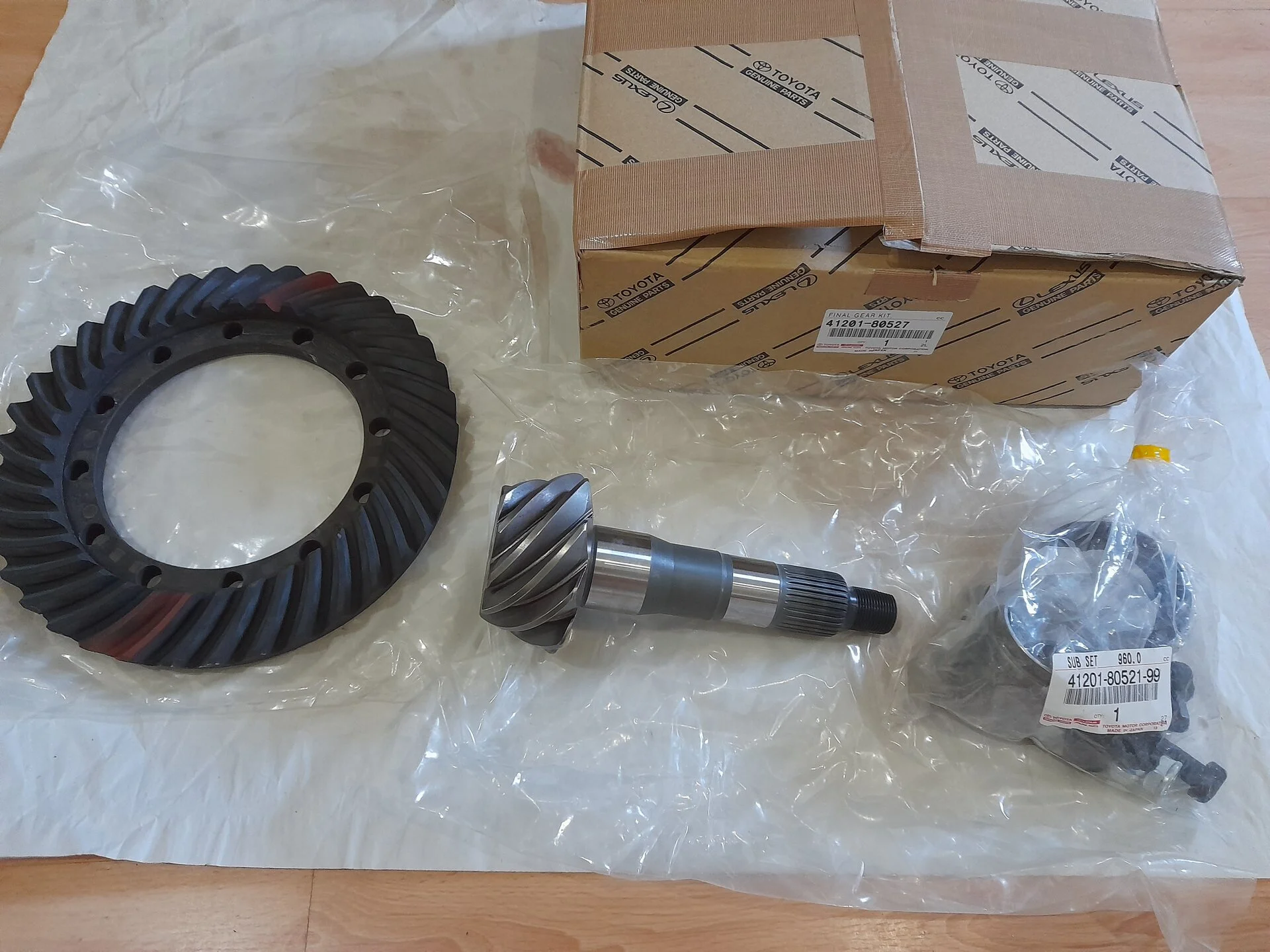

So, back to 41201-80527. After careful cross-referencing checks in the EPC, I am pretty certain that this is compatible with the old 60 hpusing/diff carrier, with all the additional hardware. Amayama advised me that there was no official supersession and even returned the first set to the supplier. But given my options I decided to go ahead and run with it.
And here it is.
The additional hardware bag (bolts, nuts, oil seal 90311-45028, crush tube 41231-60040, pinion shaft nut 90179-22029) gets its own label.

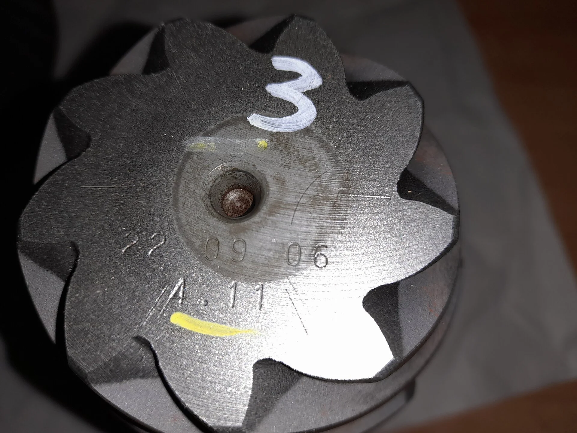

Factory has run a pattern in some red lead.
4.11 ratio, production date 6th September 2022.
I heated up the ring gear and dropped it onto the rear LSD carrier (actually from a late 80 series) and can confirm that it fits perfectly.

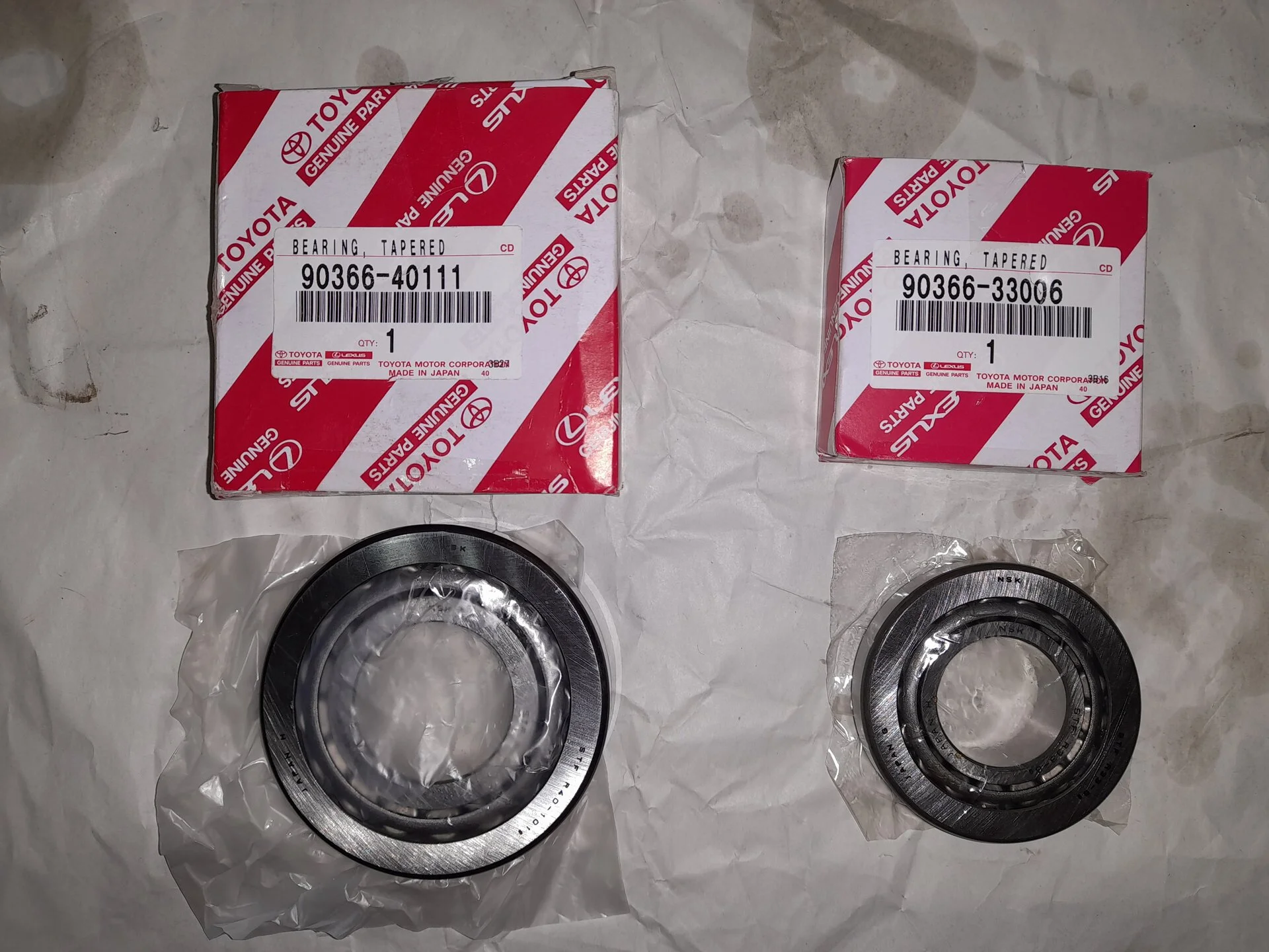

The main difference between 41201-80527 and -69166 is that the pinion shaft has been beefed-up to 100 series specifications, that is, an increase in width at the outer pinion shaft bearing journal from 30 to 33 mm, and an increase in spline count from 29 to 32. This, in my opinion, is a welcome upgrade as these splines seem to be the weak point of the rear diff.
The tapered roller bearings have therefore changed:
The inner bearing is still 40 mm, but the outer is now 33 mm. Both have a steeper taper angle, and are therefore taller. The outer width remains the same however, so they fit the 60 housing perfectly. These bearings are made by NSK, compared to the Koyo originals.

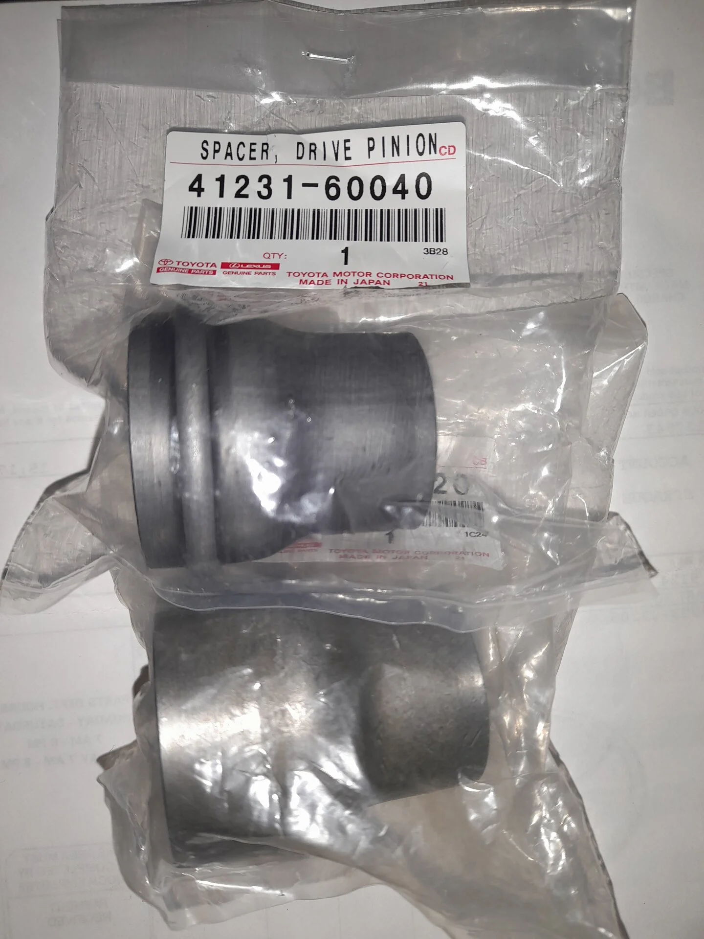

Taller bearings, same housing means a shorter crush tube. Here the comparison of 41231-60040 (100 series) with -60020 (60 series).

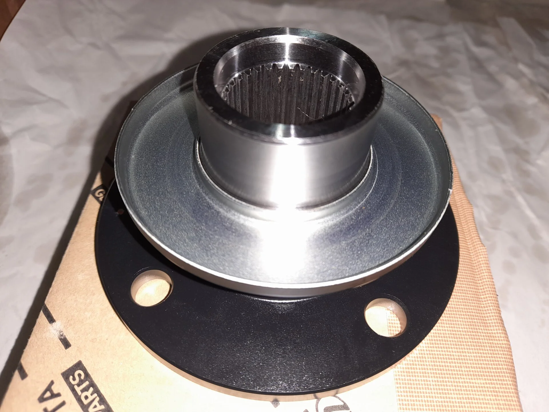

The drive flange obviously needs to change too. Here is my only uncertainy. 41204-60060 is the 100 series drive flange, but for some reason dear Toyota have already discontinued this.
-60060 seems to supersede to -60080 which is from the very latest 70 series and 200 series Landcruisers. The bolt hole pattern is the same as the 60/70/80/100 series. The difference seems to be in that low profile dust deflector which has no swage for the oil seal lip. The flange is 32 spline, with a 45 mm diameter sealing surface, compared to the 38 mm of the 60/80 series flanges.

With the bearings all pressed on and the pinion shaft installed, here is what it looks like at the flange:
It's not a perfect fit but good enough. I bought a 100 series dust deflector to see if I could put it on the 200 series flange, but no chance, the 200 series flange is wider where the deflector presses on, plus the 100 series deflector is much taller. But that's the only downside (apart from cost) of this arrangement of keeping it original ratio, all genuine parts.
So that's a 60 Series housing with -80527 ring an pinion, 100 series bearings, crush tube and pinion shaft nut and 200 series flange and oil seal (though it hads not yet been fitted - this is the interim fitting of the shaft/flange to set the ring gear backlash and carrier bearing pre-load.
