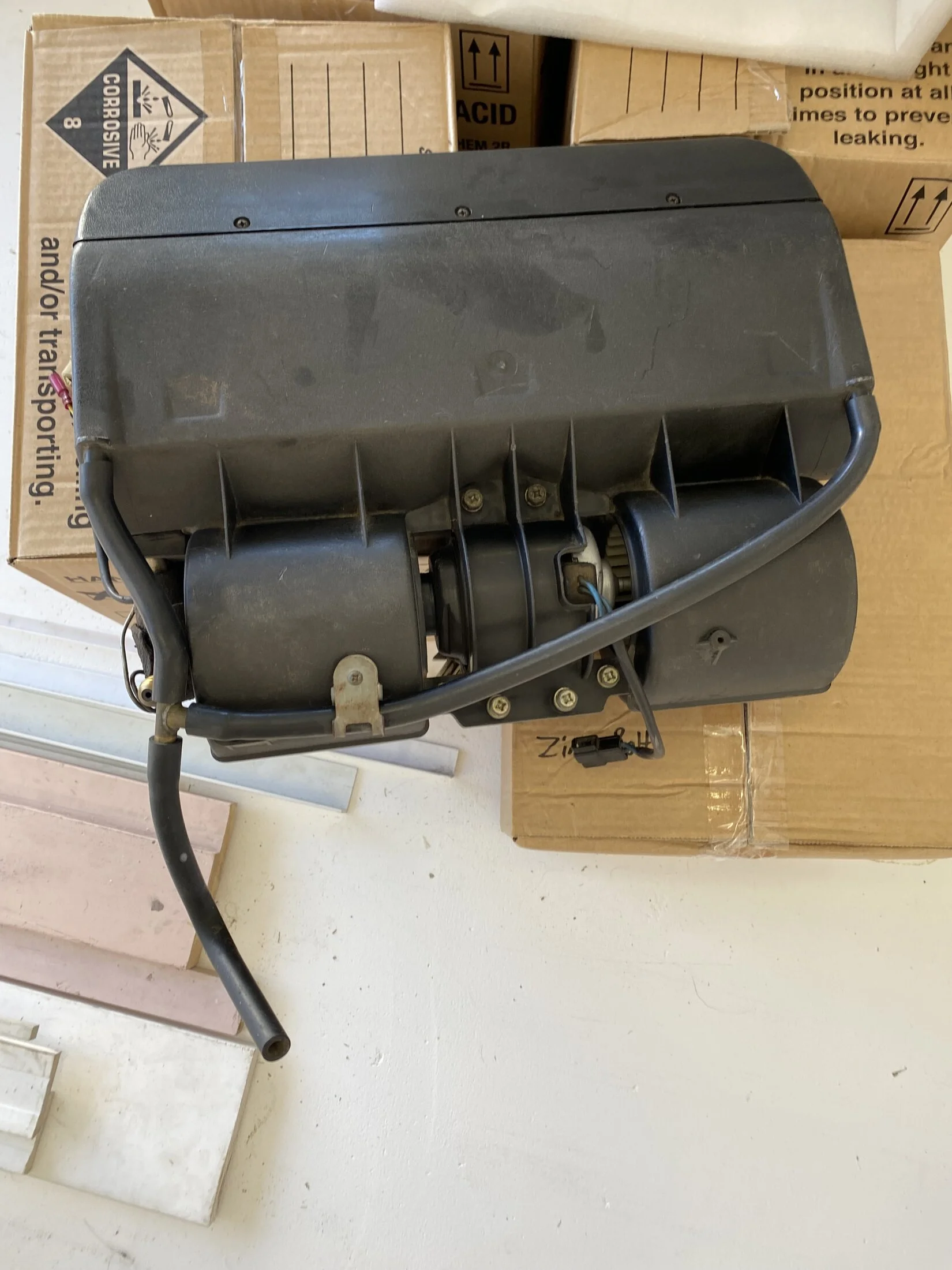

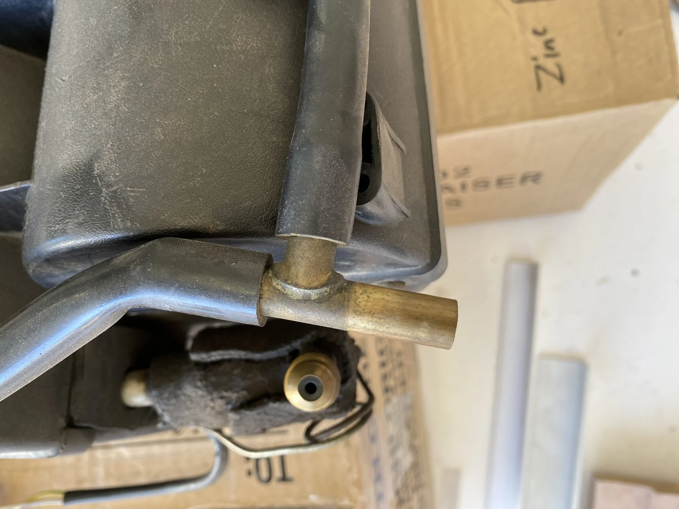

Yes it’s just a T piece to connect the both sides in to one hose. I can grab a photo for you as I have a couple here. I’ll just have to find it as I’ve been moving garages and all my parts are in unlabelled boxes, so I hope you’re not in a rush!
A picture would be great. The diagram really just shows there is a T. Definitely not enough bends shown in the diagram.

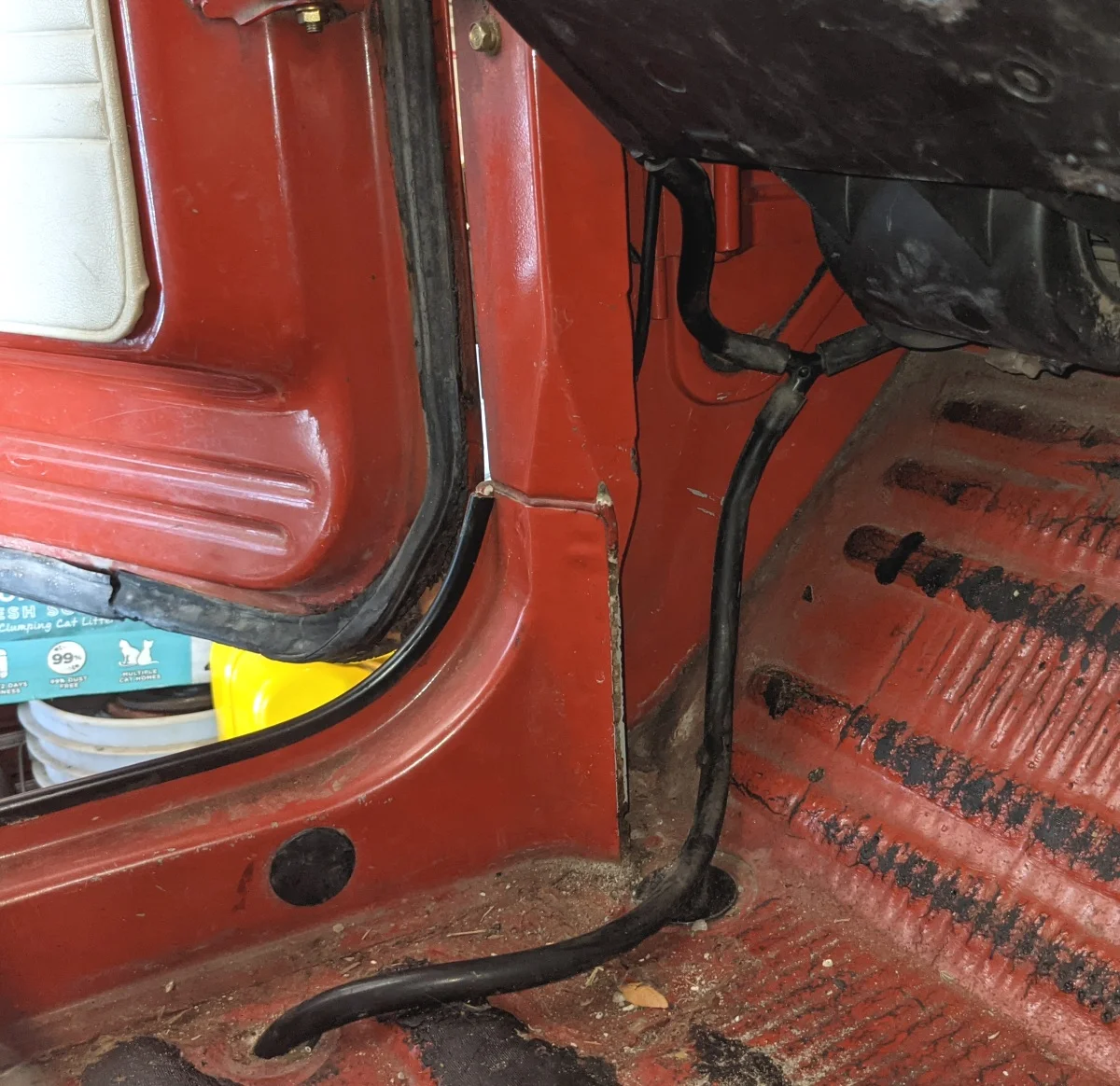

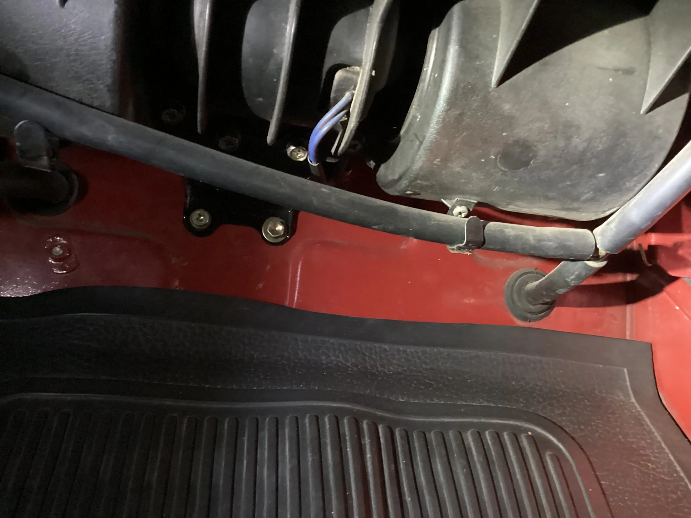

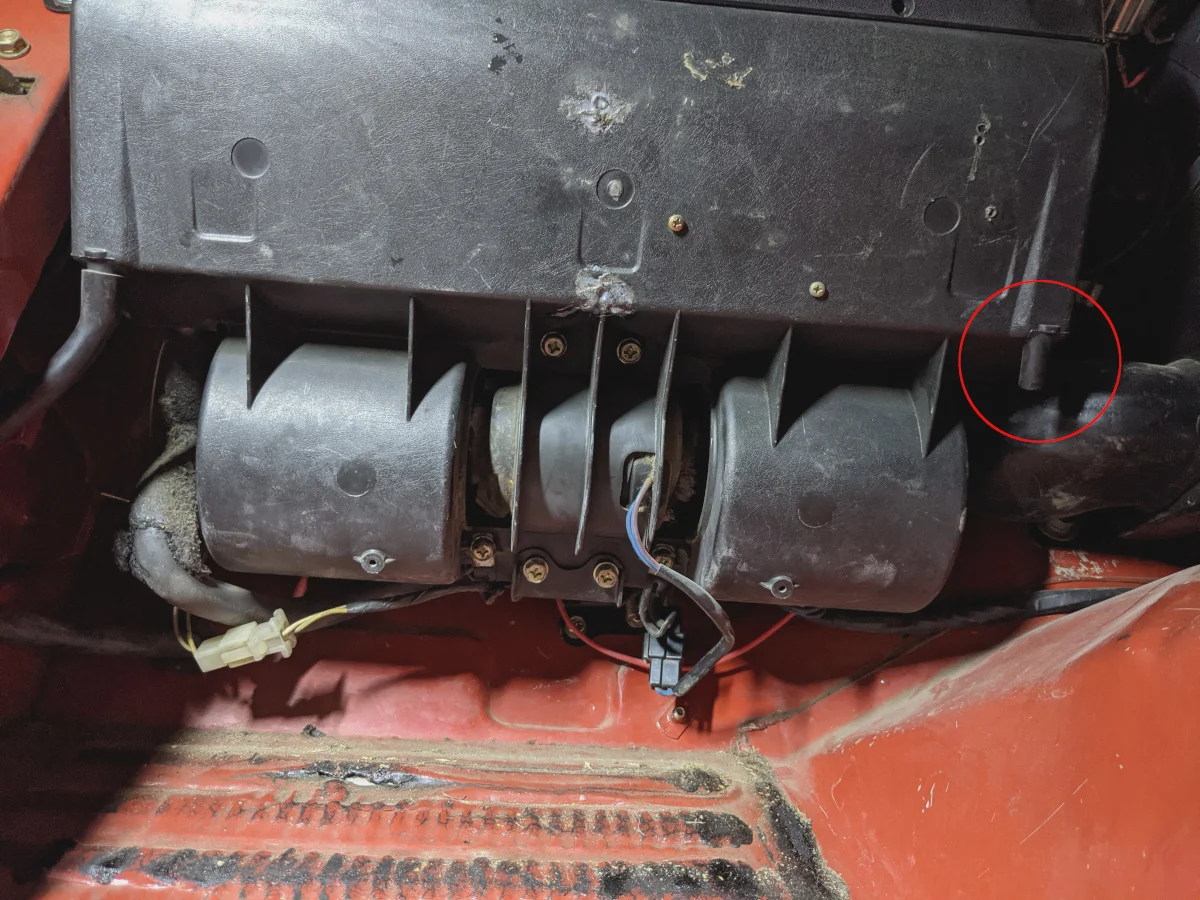

I wonder if someone messed with mine, I have one line draining through the floor, and one through the firewall, all with a Y fitting. Maybe someone drilled a hole in the floor, or is this oem? It's a 1981.
