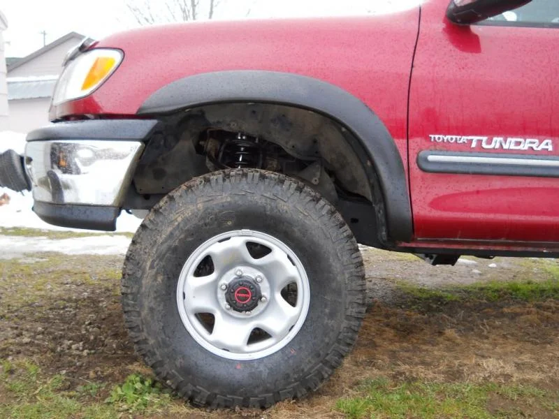

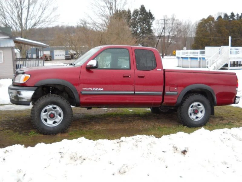

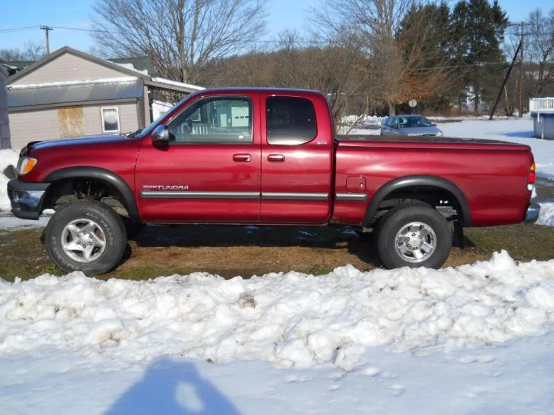

I didnt like the ones that match these wheels, but I found several styles that will work or can be modded to fit these, from 40 & 60-series LCs, and the set that is in the pics, from the early 90's 4Runner alloy 4-spoke rims.
Here's a couple pics:
Before with one stock Tundra, and one of the Taco alloys (Dont mind the Cali lean...I got OME springs/5100s in the front, and havent lifted the back yet)
New steelies & tires
That's actually good advice, your headlights are gonna be way outta wack.
I like the Cali rake FWIW, nice setup.
LOL...I have much more to do before I get it levelled to the point where I can worry about the headlights...lol
The lean is a bit exagerated, as its sitting on a slope in front of the garage, and both right side tires are flat, in the pics.
BTW, I havent driven it since installing the front suspension.
And the tires, in case anyone was wondering, are 255/85-16 Maxxis Bighorns.
Even with the narrow 255's, I had to use 1 1/4" wheel spacers to get them to clear the stock UCAs. The back inner edge of the tires is about 3/8" shy of rubbing the frame at full lock, otherwise, no clearance issues while just sitting there. When the suspension actually moves may be another matter... LOL
