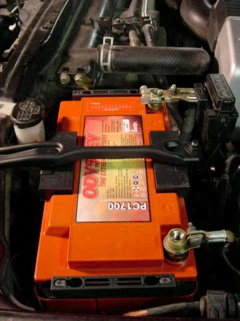

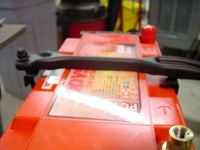

After the battery arrived I knew I was going to need a spacer underneath to compensate for the height & allow the hold-down work properly. After studying the new battery I noticed the factory hold-down wouldn’t “grip” like it did on the original battery. See photo. Also, in the picture the hold-down would put pressure on the weak plastic center portion of the battery and wouldn’t hold it very tight (IMO).
I made the spacers out of 3/4 delrin, the bottom (13.5x7.5) and two top spacers (3.9x1.5) to fit in the notches on the top. See photo.
The overall height is near perfect to the original & holds the battery very solid with the pressure being applied evenly on the strong portion of the battery.

Actually you may be able to sell a few of those machined pieces to other members for cash or beers as I expect some may want them now or down the track for a future install. Good Job.
Thanks! Not sure if there’s much of a need, but maybe.
DMX
Nice job Dean. I too used Delrin to distribute the load and take up the height difference on my Orbitals. It not only machines easily as you stated but is, as you know, it is non-conductive too. I will be interested in hearing your report/experiences with the Odyssey.
I was considering the orbital and probably would have used it if the posts were like the original (not that changing the cable is a big deal, just didn’t want to mess with it).
