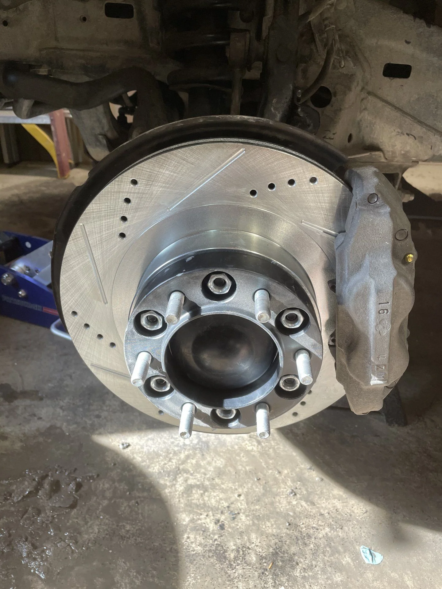

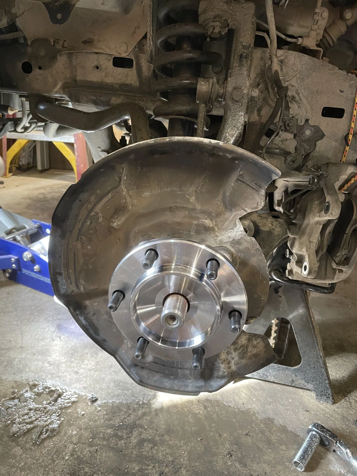

I had a similar drone sound that increased with speed as well. It also got noticeably louder as I turned left on the highway. I bought bluepit preassembled hubs and wheel bearings and put them in this weekend. Super easy job for both sides, took maybe 2 1/2 hours taking my time. I also did new rotors and pads while I was there too. Fixed all my issues and is quiet as can be again.
