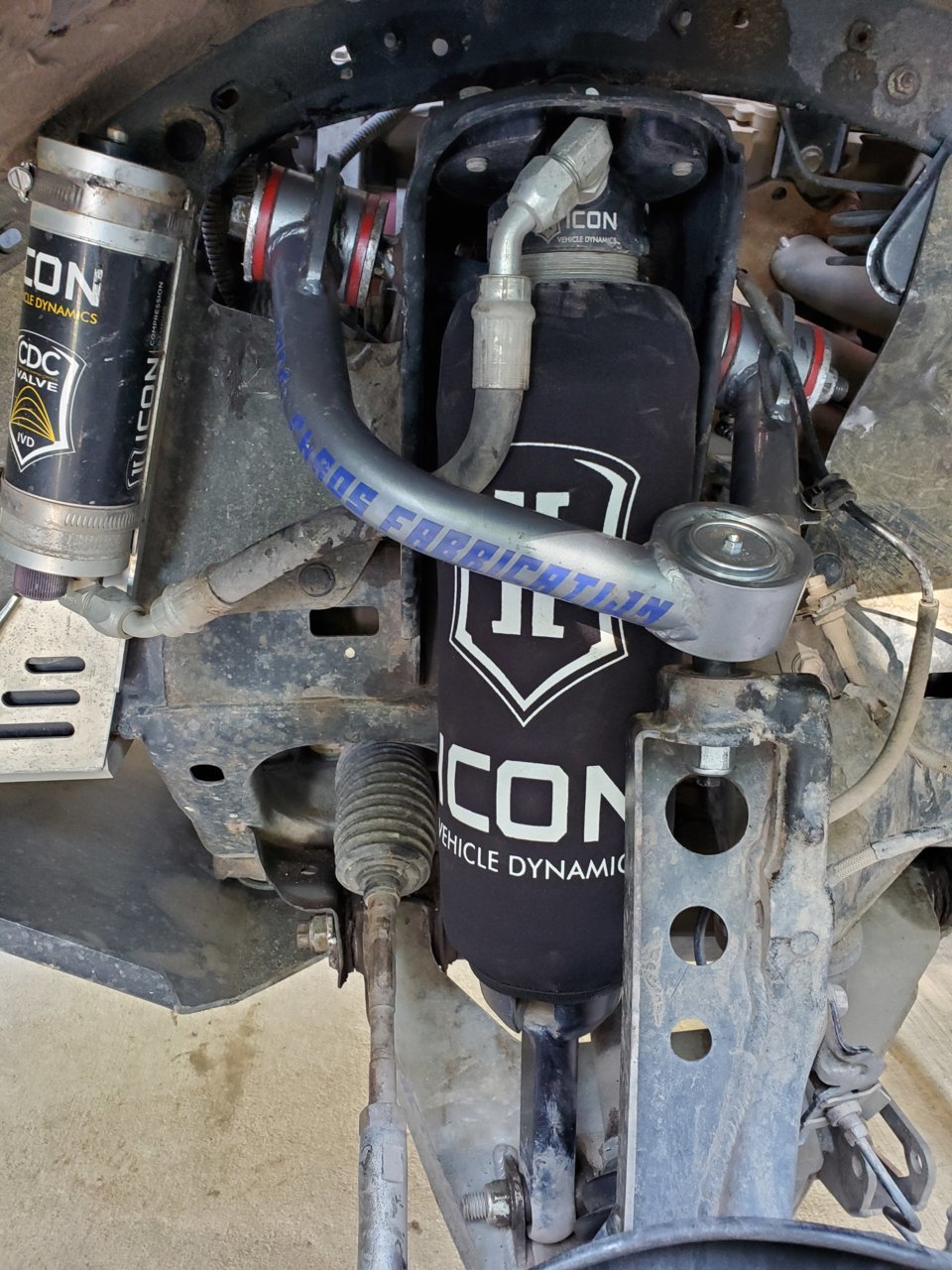

Retrofit Delta Joints installed the the TC uppers... also added some coilover covers before winter shows up.
Process wasn't bad. Need to get creative for a press tool since the taper bolt gets in way. Saved some money not buying the Icon tool and using a technique from a buddy, used a ball joint kit press tool and a washer as a spacer.
Looking forward to no more squeaks from the uca. Greasing suggested every 3,000 miles.
20190922_155012-jpg.3553574

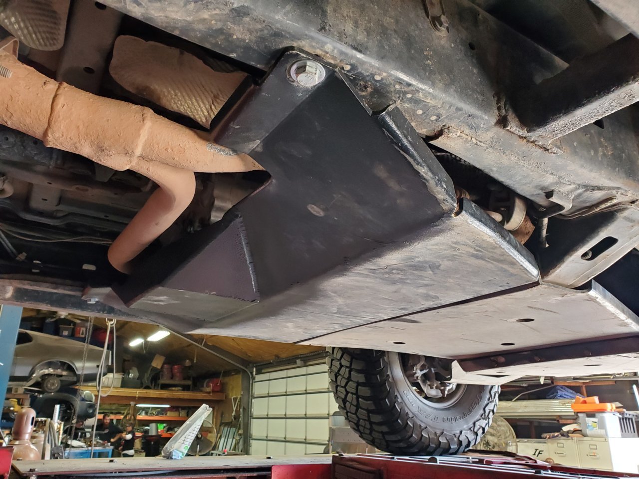

Had Insain Fab update my tcase skid after the crawl box pushed the tcase behind the original tcase skid...
20191012_141911-jpg.3588491
Finally got some protection for the tcase so I don't keep doing this...
20190908_112242-jpg.3588492

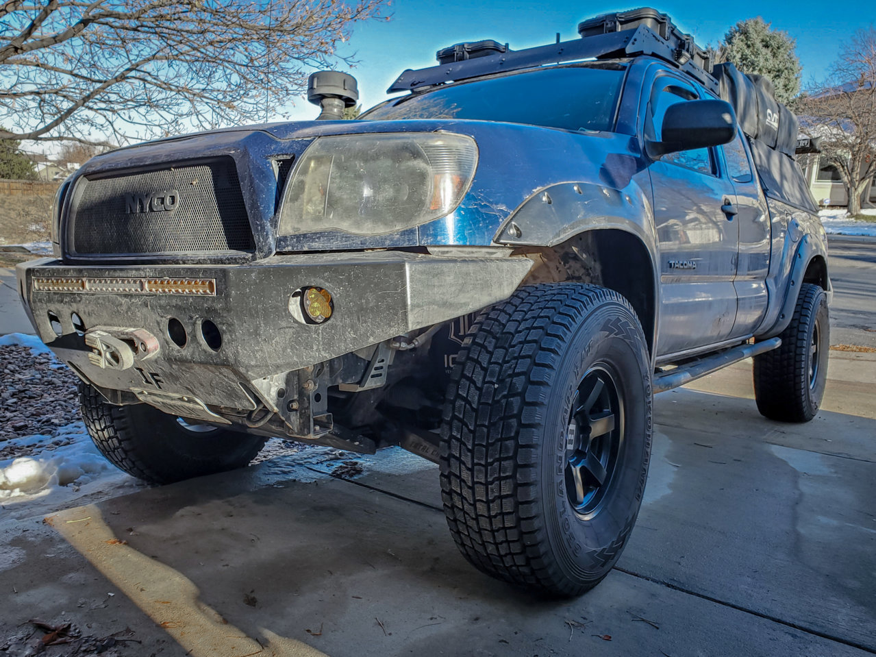

Winter mode engaged with Yokohama Geolander G072 315/75r16 (previously used on our FJC.. didn't trust the KM3's in the winter)
20191123_150443-jpg.3656410
