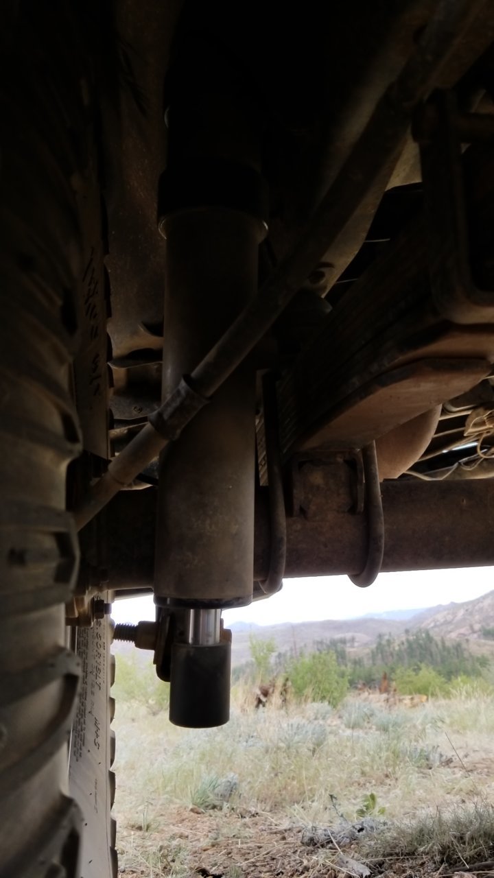

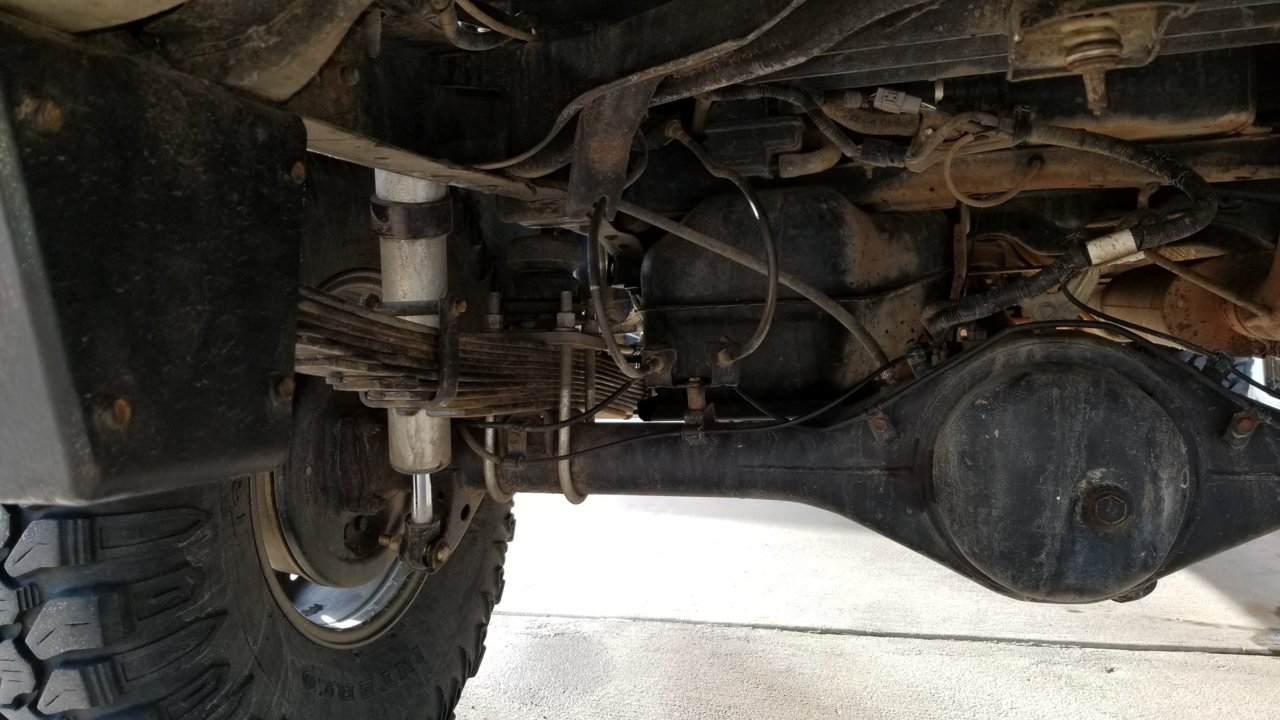

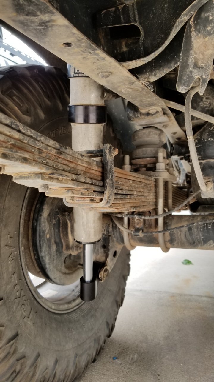

discovered an issue with my rear shock length while driving on rocks in jberry813 's yard...when rear tires were tucking, the shocks were fully compressing causing my shock to be the final bump. no bueno..
with the help of 303 Shock Services and Icon, we retrofitted some RXT lower shock mounts on to the Icons to give me some more uptravel.
before
20180319_171821-jpg.2741606
after
20180526_162714-jpg.2741607
testing compression
20180603_130933-jpg.2741608
previously had zero shaft showing...much better now
20180603_130941-jpg.2741609
this now got the shock cycling where it should be and the shock is no longer my final bump :woot:
20180603_130912-jpg.2741610
20180603_131028-jpg.2741611
not an expert by any means, but i've never seen a leaf spring bend backwards like that
not ideal, but they still work just fine... i should have gone with the next weight up, but i underestimated my constant additional weight..
still much better than the old toytec boss leaf pack i had before these deavers..

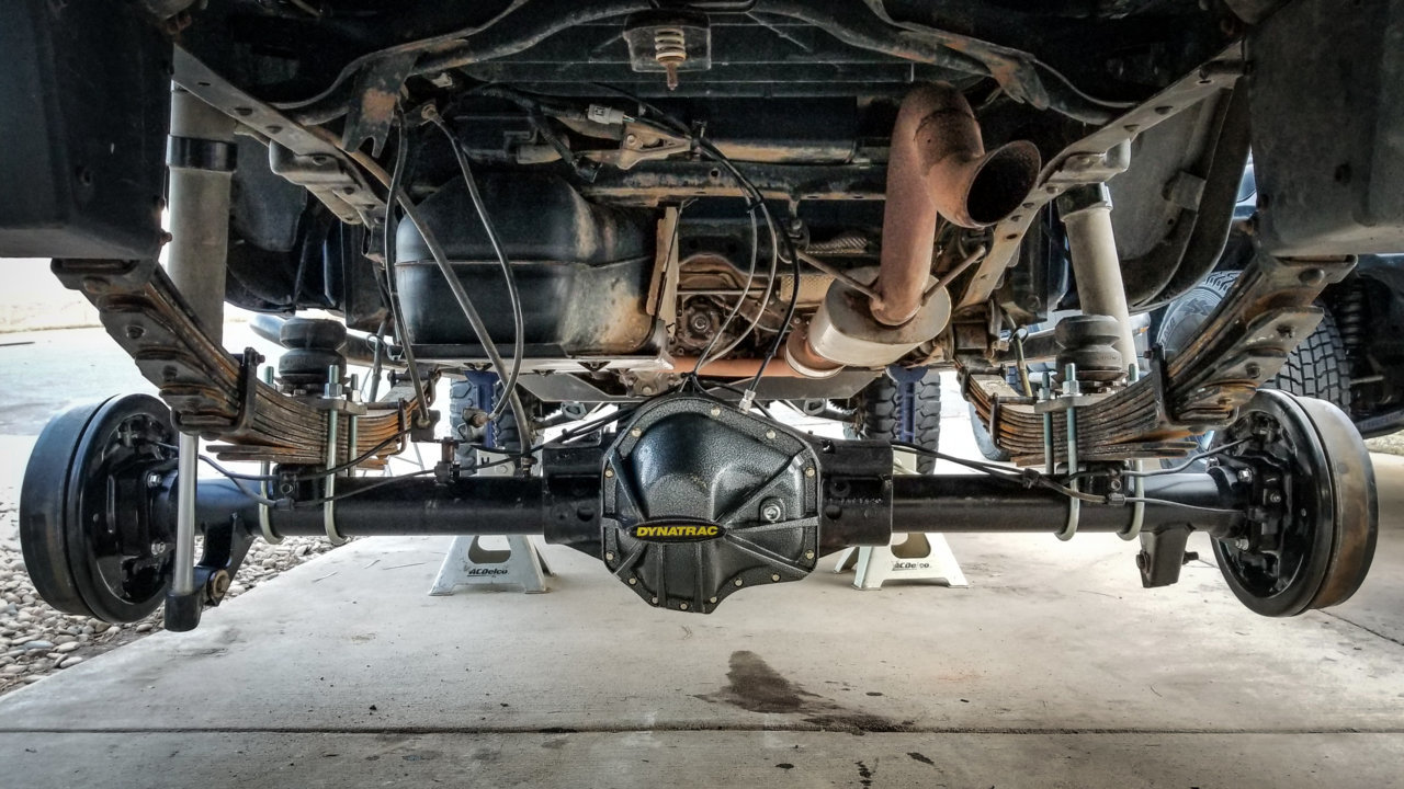

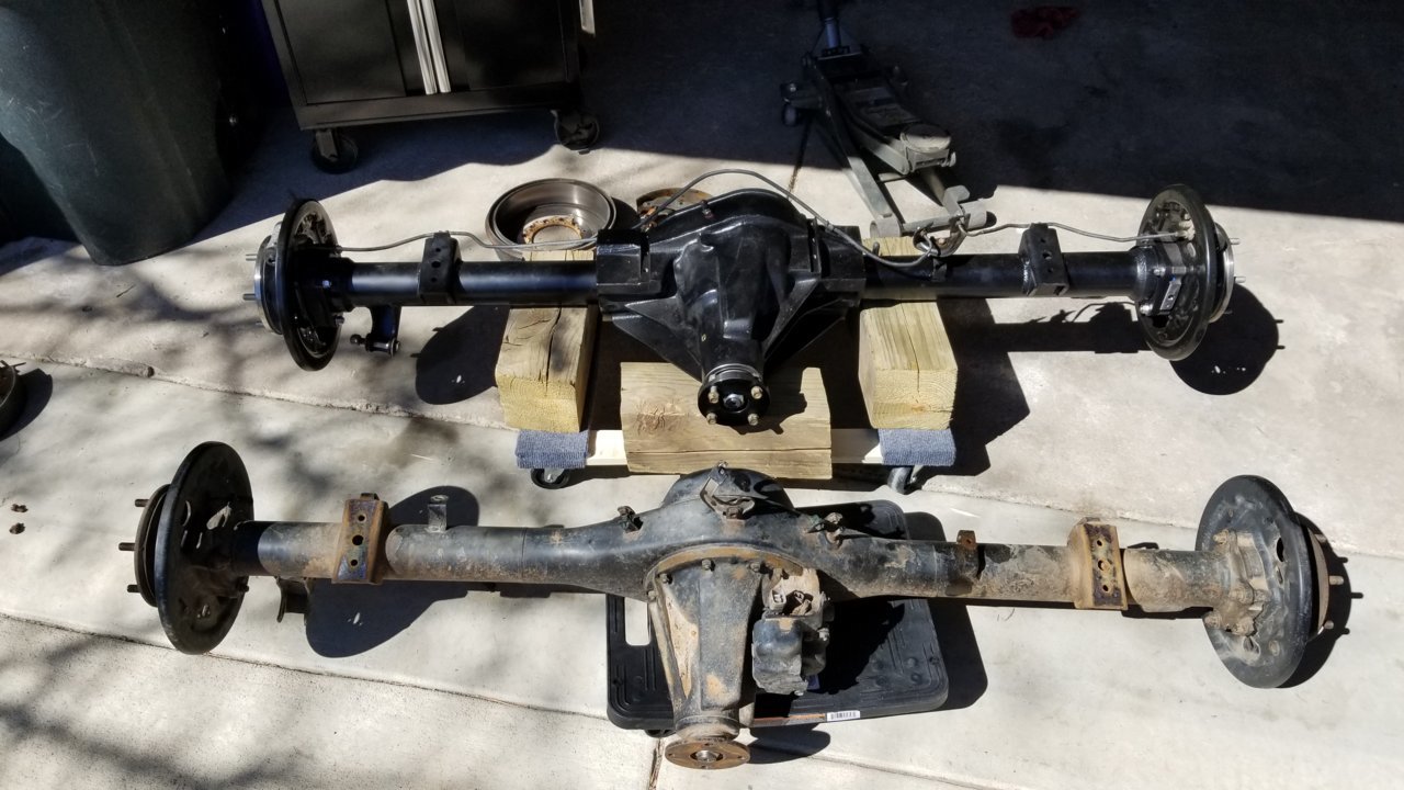

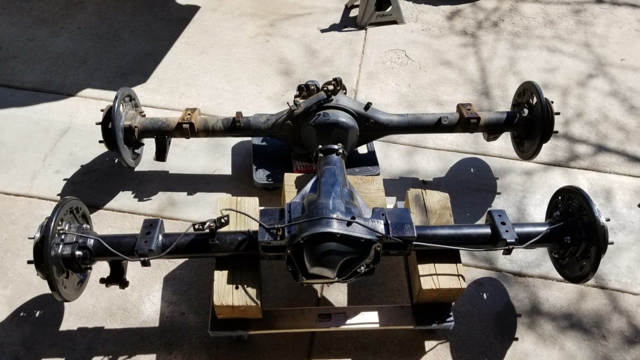

Dynatrac ProRock 60
got some OEM parts to accumulate and assemble in the coming months... hoping to do the swap in March and ready to rock for some big trips in April..

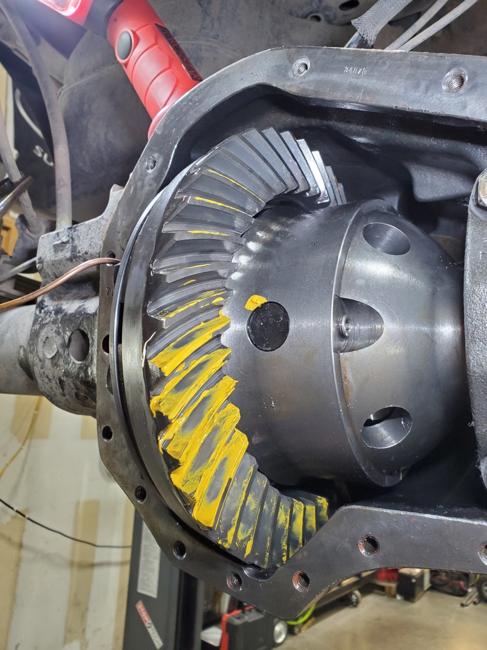

got one step closer over the weekend on the Pro Rock 60...
got the studs installed, shafts pressed together with bearing and backing plates... nice to get rid of one pile of parts sitting in my garage!
1914551
1914552

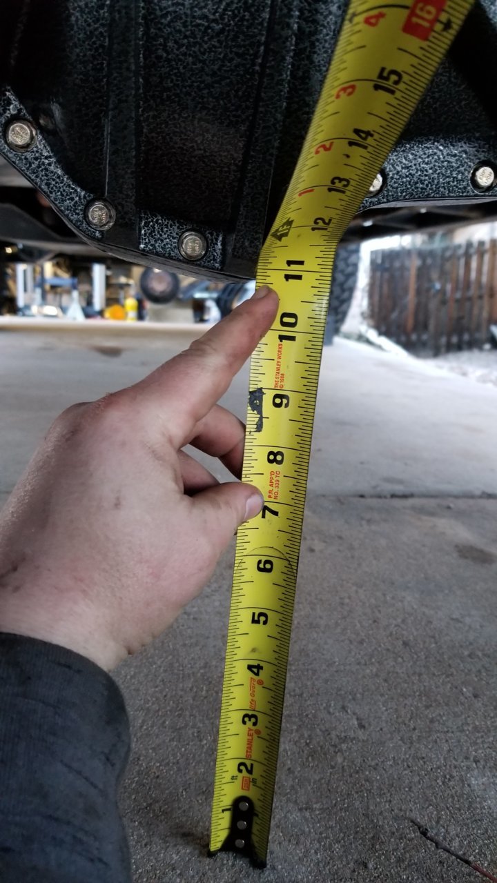

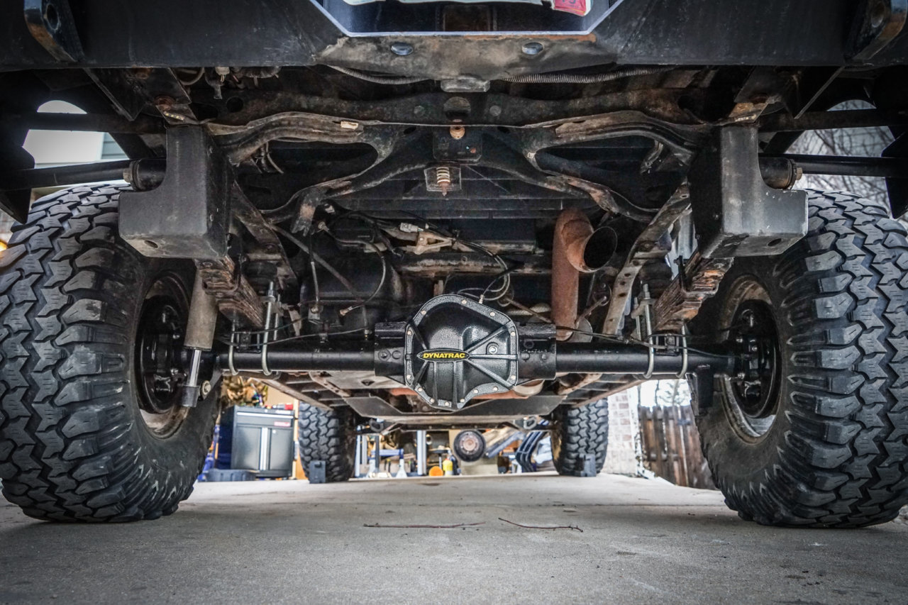

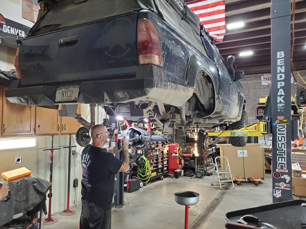

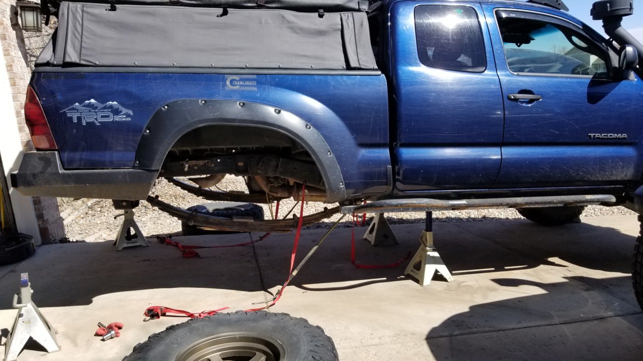

Dynatrac ProRock60 install day! went smoothly until the end when i saw my driveshaft was 1.75" too long... getting that dropped off this week to have shortened and freshened up...
for now, she's in and everything else is connected... brakes, sensors and air line.
lrm_export_243504481055072_20190310_185632045-jpg.3198974
lrm_export_241520450251038_20190310_182327950-jpg.3198975
obligatory no legs shot...
20190310_123857-jpg.3198978
Toyota 8" vs Dynatrac ProRock60
20190310_124304-jpg.3198979
20190310_124326-jpg.3198981
and surprise of the day... no clearance loss...
ProRock
20190310_185823-jpg.3198982
8"
20190225_180345-jpg.3198983

after waiting too long to get my arb locker fixed.. finally got a little help from our friends at Nisstec and their gear guy Brian. Brian has lots of knowledge in dana axles and was willing to help me get my bonded seal replaced and ensure my gears were still setup right... while in there, we saw the seal housing spun and was pinched against the carrier bearing caps. we also noticed that the seal housing did not sit down far enough with the shims in place where they should be, so we had to do some crafty assembly to put the shims on the outside to allow the housing to sit better creating a better seal for the seal housing o-rings.. fun..
with the bonded seal dumping s*** ton of air into the housing, it of course blew out my axle seals as well.. so we had to swap out the brand new seals for some new ones while we had the axle apart...
lots of headaches caused by a failed seal from ARB, but everything is back together and going to test it out this weekend to make sure she's ready to go again...
