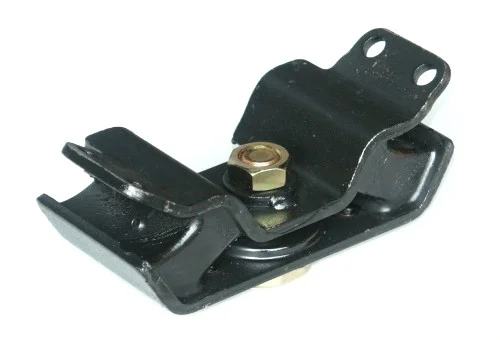

Does anyone have mini-truck t-case mount??? It and my clutch disk have disappeared.
