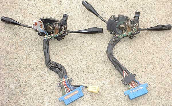

So when I took my 85 4x4 Pu to the wreckers on Thursday, it arrived with very little value!
Most everything I could use on my new 62 came off the truck!
The intermittent wiper switch, the Grant steering wheel, the rock crawler rims and fresh tires, stereo, alarm, headlights bucket seats, remote oil filter, allen head drain plugs and a few other things. I did leave the royal pine tree.
I feel good about junking the truck since I got it new in 86(last one on the lot).
I put 425K on the clock and I'm sure it would have made it to 500K with ease.
But the little guy had been rolled an beat on it's whole life.
So today I thought I'd try some of the truck stuff on the 62! The PO put in H1 high beams with out new relays and burn out the HB switch. Also the 62 has a halfazz intermittent wiper system. The stuff went in the the 62 without a hitch! and works great.

Nice work!
Was the wiper switch plug and play? If so, that's a great upgrade.

Yep, plug for plug the same. Only difference is the E-flasher button toggles front/rear instead of side/side. Needed 3 minutes with a file.
If I wanted to tear the switch apart, may have been able to switch the hazard button as well.
It was a cool mod on the truck, but it's more cool on the LC. Nice to see Toyota did not go overboard on designs.:clap:

So what you are saying is that the wiper/flasher stalk from a 84 p/u ( and probably from every other toyota that gen) plugs right into the 60 and gives you adjustable intermittent wipers?
Yep, thats it. My 85 PU was a base model(paid $7995.) and came with nothing!
Over the years someone on OffRoad.com tried the intermittent wiper switch and WOW! Before I junked the PU, I took a look under the LC steering column and the plug was the same. The stock LC intermittent control is not the end of the world, but I got use to the variable timer circuit of the other, and I like it!
You need the one on the right.

Don't want to steal the thread but I have an old '85 Supra and the turn signal / wiper assembly look just like that. Anyone know if that is indeed the same for a plug & play install?
I'd take a guess and say yes.:)
