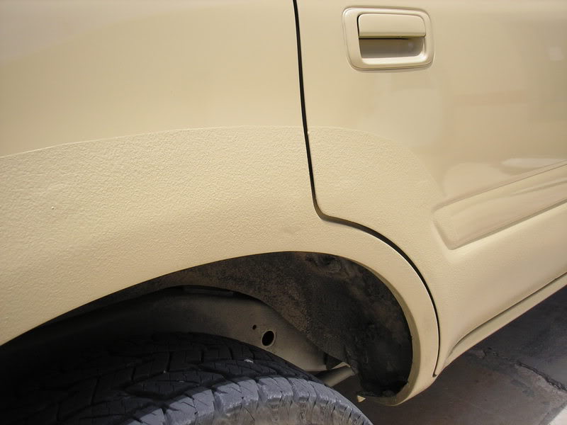

nice work, It looks great. I am curious about the 3m rocker panel spray. Is it a textured coating or is it smooth? it looks smooth in the pictures. Can you take a close up pic of one of the repaired flare holes?
The 3M rocker panel spray is very textured. It's almost like a heavy glue sputtering out of the can, and hardens up pretty damned tough. I tried to sort of feather the edges with some sandpaper to make it a little more subtle and it's tough to sand.
I thought about using the new Line-X "extra" that can be color matched, but that stuff is really expensive so I thought I'd try this first. It's pretty subtle, which I like.
A close-up.
Here's the worst of the worst of the patches - I was on can #3 and ran out of goop on my 2nd coat here. Sometimes a couple of patches are very noticeable and sometimes not noticeable at all - depends on how the light is hitting it.
