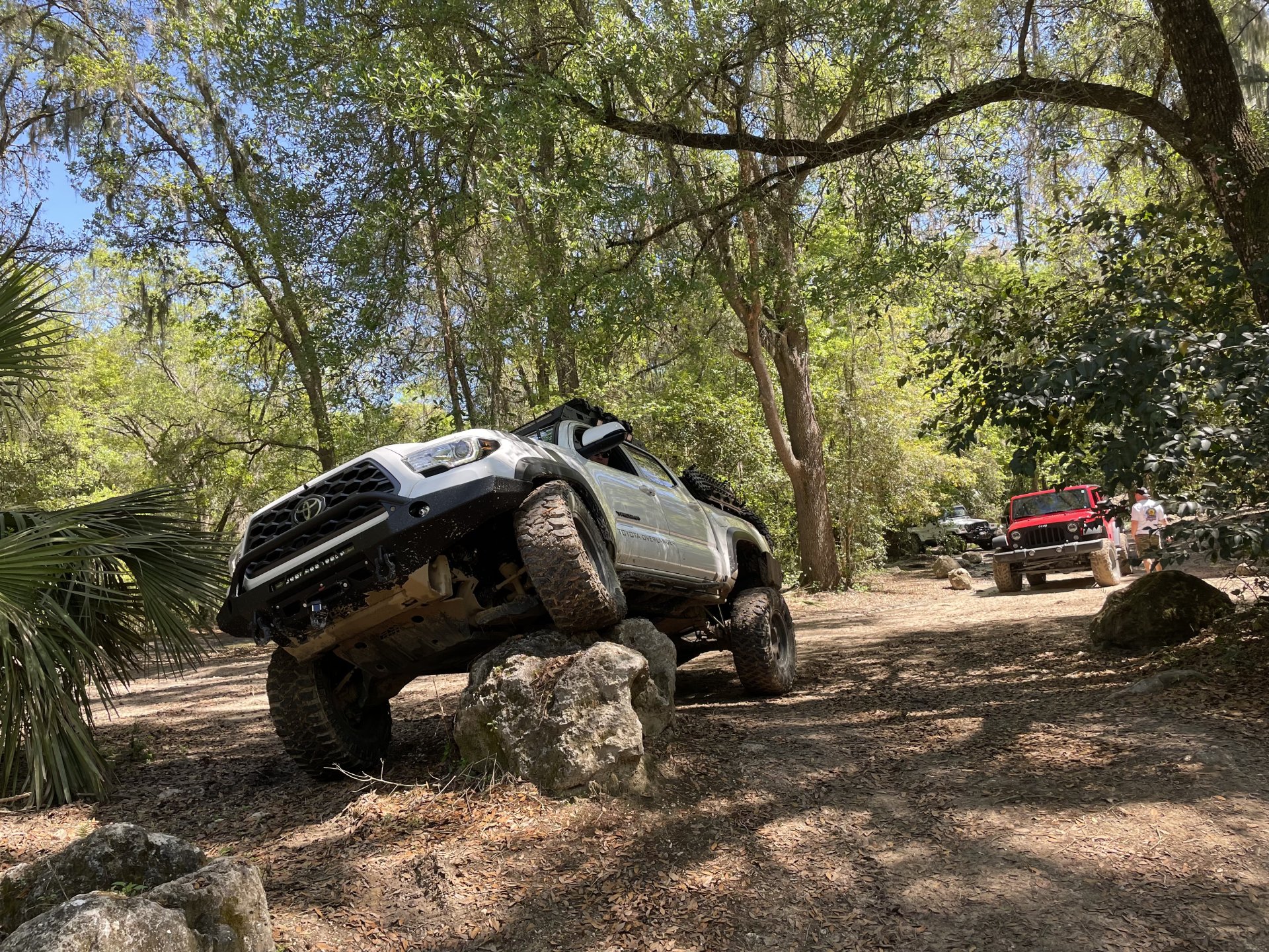

Thanks for the add. I just got into off-roading last year after building my 21 Tacoma. I’m currently in the market for a new build with a FZJ80. Plan is to put 37s at minimum or 40s. Looked at 5 or 6 in the Central FL area. Looking at 3 more this week. Hopefully, find one I like. I’m here for advice and to learn more about them. Looking for information on the things needed to fit 37s or 40s for the build.
I plan on doing similar mods that I did to my Tacoma.

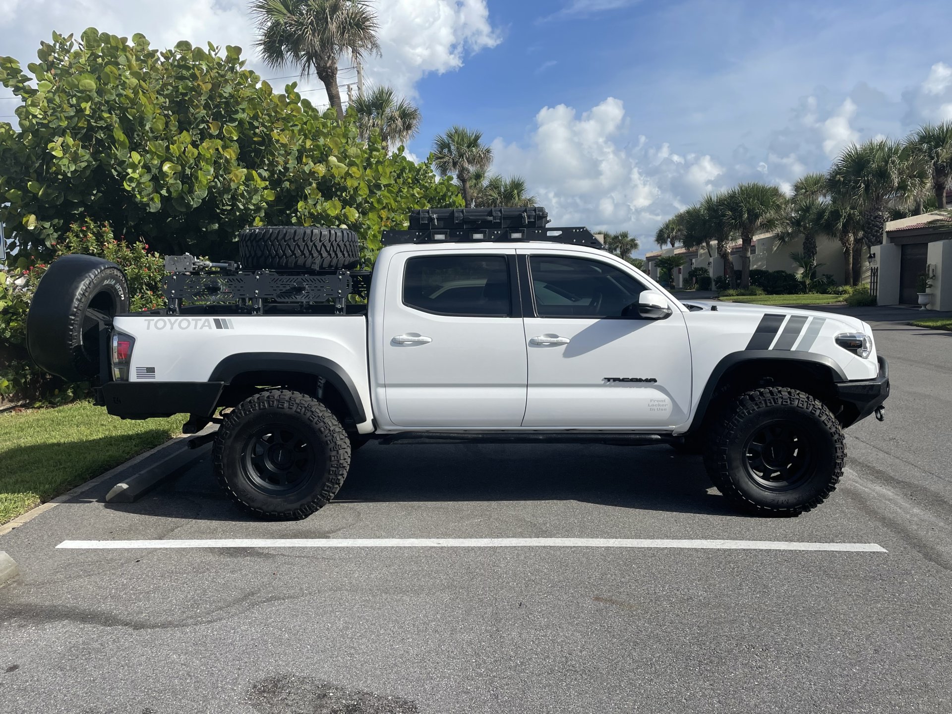

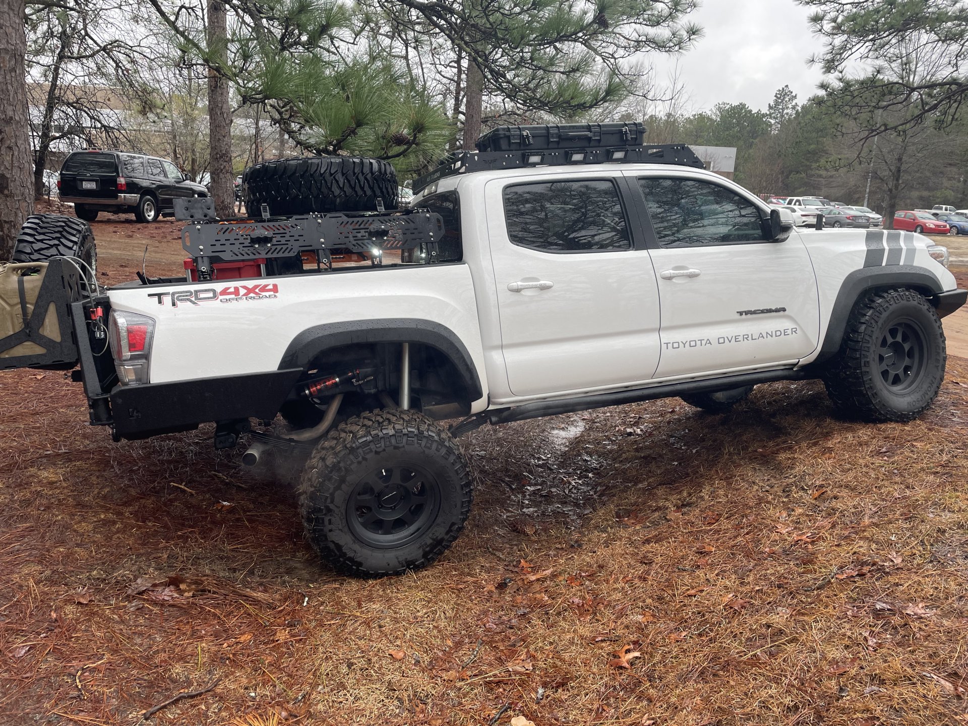

Tacoma Build…
Roof rack -w 40” light bar
Bed rack - up top overland
CBI skid plates ….Front, trans, t-case, gas
tank, rear diff, lower control arms
LineX under coat
Rock sliders
Baja T3 aluminum bumper
WARN 103253 VR EVO 10-S
C4 Rear bumper w Swing gate
Fox DSC front 2.5 coilover with 650 lb
Element hard parts Billet UCA
Spindle gussets
Fox 12” DSC 2.5 rear shock w relocation
Icon RXT leaf pack w hardware
Sumo Spring
Hammer Hangers and Shackles
Method MR 701 wheels on 315 MT tires
ECGS gears 529
E lockers front & back
Remove sway bars
front/rear camera anytime cameras
Kenwood ham radio
Midland GMRS
Auxiliary Battery
Fender cut
Pinch welds smashed

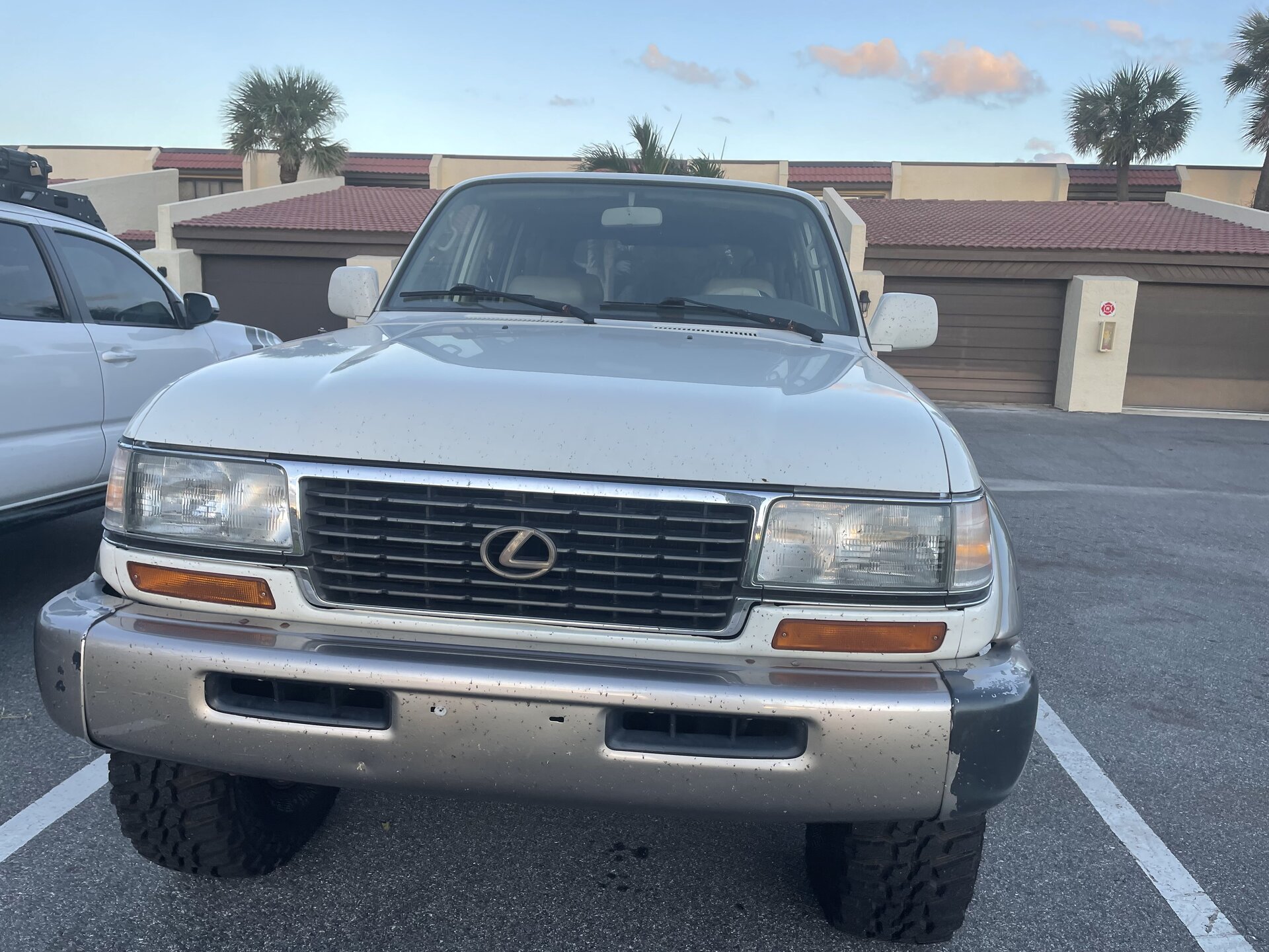

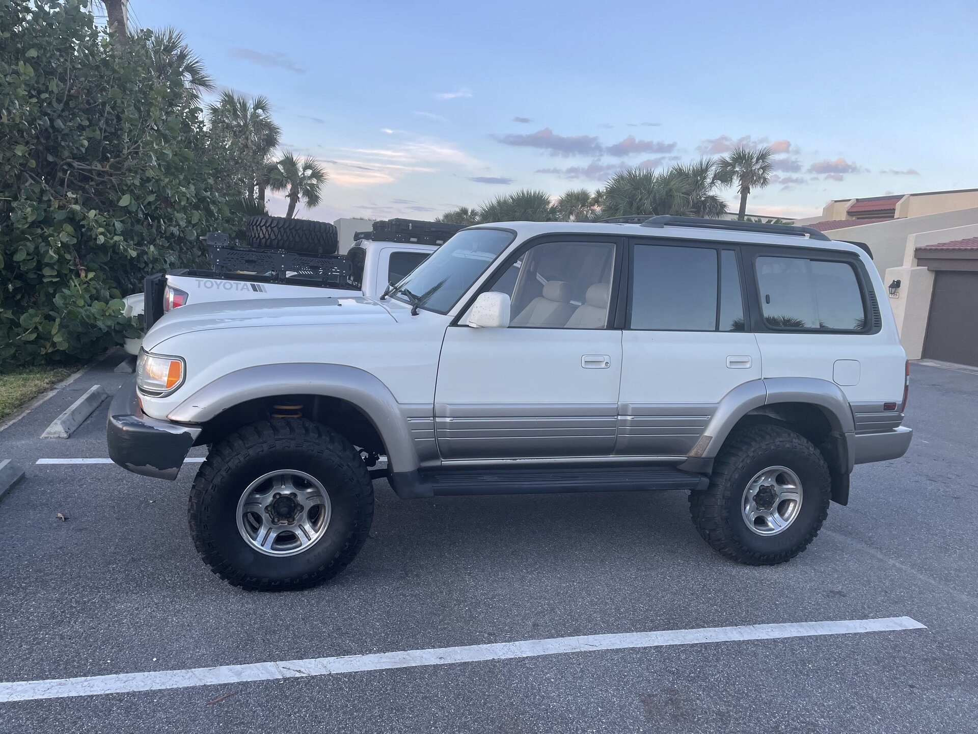

Great looking rig, how is the interior and condition of the engine bay?
Is that drivers side lean due to the parking spot, or camera angle?
I know the OME/ARB springs have been installed wrong in the past. "A" is intended for Australia's driver side RHD and "B" is LHD but when installed here in the States you flip them.
I believe it’s leaning bec of the panhards. They are adjustable but I ordered a lift plate to level the panhard out. i believe it wasn’t completely lifted correctly .
didn’t extend 3 of 7 break lines or add caster plates. Just lifted it 4.5 inches. Suspension lift
Inside is good. I removed the 3rd row and going to add a barrier w shelf. Also raptor line it. Then wood floor for mounting of my fridge as well as other thing
are you raptor lining the inside or outside?
