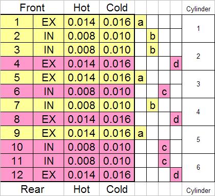

Well I lined the pointer up with the TDC line on the flywheel exactly and I had the rotor on my dizzy lined up with the number one spark plug and then I adjusted the first half of the valves. Then I over rotated for the second half of the valves but corrected my mistake before I started adjusting. Could that have caused an issue? Is there any chance you could post the cold adjustment chart on here?
For cold adjustment just use the same values for warm. If resetting the valves works then warm up the engine and recheck the clearances.

FJ60 valve adjustment - https://forum.ih8mud.com/threads/fj60-valve-adjustment.489587/
I got the chart from this thread. Read Jim’s notes on valve timing. This thread helped me tremendously when I was learning to adjust valves.
