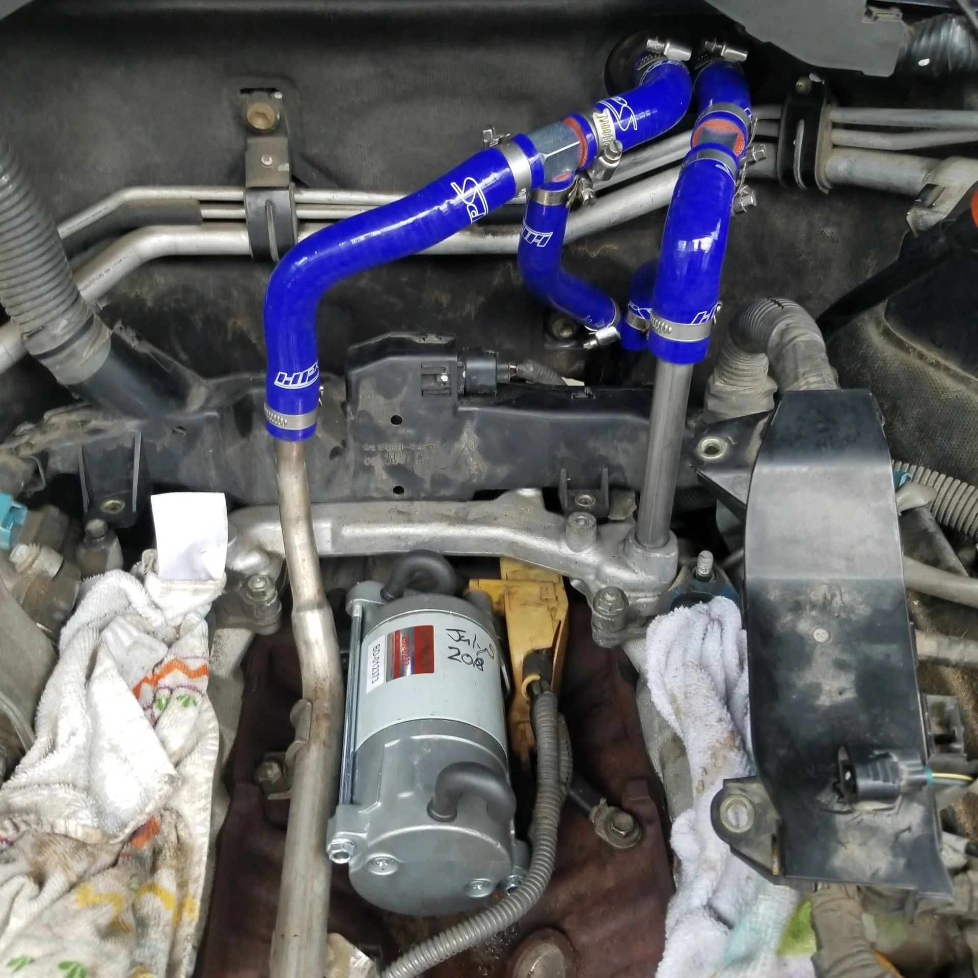

I replaced my starter this week on my 1999 Land Cruiser, and now the gauge in the dash indicates no oil pressure. While I was in there with the starter I also replaced all the heater hoses, their "T" junctions, spark plugs, PCV & grommet, fuel filter, and a few other similar small and unrelated things.
