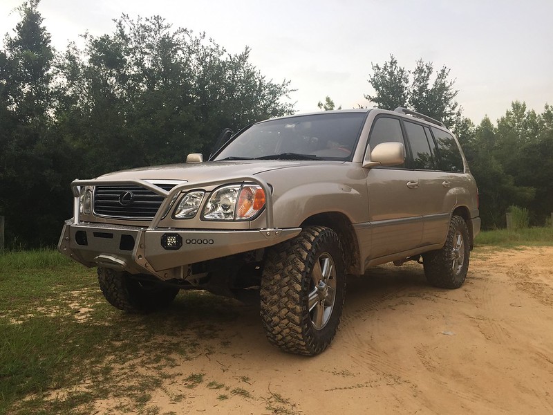

Here are couple shots of how they look now. You'll see minor chipping here and there, but no major damage to the tread.
I would say that those tires were toast a while ago. The siping across the lugs is pretty deep and you're way below that already. My tires actually had more tread depth than that when I swapped them out. Makes more sense now.
Yes, it's a little different out here. We won't see a drop of moisture from spring to late fall. While I would't take these tires on an off-road "trip" or in the rain/snow, they are perfectly serviceable for taking the kiddos to swim class or the occasional trail, which I do all the time. I've actually been a bit hard on them lately just because I know they're on their way out... You know, NOT driving around that sharp rock mid trail, etc.
