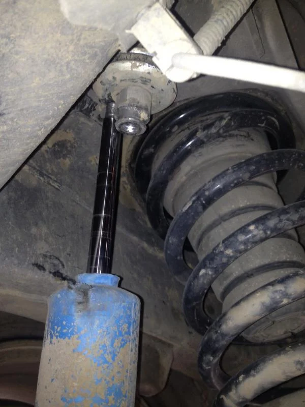

So last night I split one of the bushings in half to be used on both shocks. That trim down of a single bushing did the trick and I was able to bolt the shocks right up.
One thing to note for anyone who has not done this before - jack up both sides and get the whole rear on jack stands! That makes getting the coils in and out fairly easy without unbolting anything at all. I did go down to Lowes and pick up a 16" pry bar (~$9) which worked out great getting those coils moving!
With that done, I was able to move to the front and install the shocks there as well. That was just easy, except getting the bent driver's side shock out. I did not know that it was bent, but with it unbolted, it took me hammering on it to get it out. Once out, everything went in easy as pie!

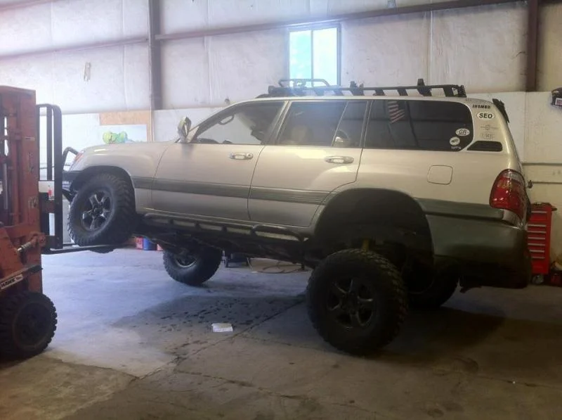

N74L
Man a Fre extended links
Swapped out hardware to fit 100 Series
Fabbed my own spring retainer
Lowered bump stops 1"
Worked fine for me. I recently upgraded to the ICON CDC shocks which are the same length, but are a major improvement performance wise. To be fair, I had probably 30k miles on the OME's and never had one problem. I only have maybe 100 miles offroad with the new setup.

Tire size is just under 35" 295/70/18 MT. Yes, there is some rubbing if you're taking bigger bumps/hits at speed. A 1" body lift eliminated 95% of the rubbing. The Man a Fre extended links are for the 80 series but work with the 100 as well. Not mandatory, but why add the L shocks if you're not going to do it correctly? 860's are much softer than the 863's. Their static height may be the same, but the 860s will compress much more than the 863 based on spring rate.
It's best to completely cycle your suspension and find out where you are, then build from that point. This mod isn't going to change your life, and regardless of what you've read on here, it doesn't suddenly make your truck do things it otherwise wouldn't. It's just "another" mod. I enjoyed doing it, learned a little bit along the way and it looks cool under the right conditions, but you're not gaining some crazy amount of travel up or down.

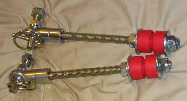

I want to order the Man A Fre extended links for of my 100.
As far as I understand, Man A Fre links are engineered for the 80-series, therefore these will only work for the rear axle of the 100.
I have found an interesting thread on the IFS extended links:
https://forum.ih8mud.com/threads/longer-front-sway-bar-links-thoughts.776331/
Quick-disconnect anti-sway-bar links are quite popular with the Jeep guys, I would like to find a similar solution for the 100.
I sent a mail to WabFab to order the same QD links they have manufactured for other 100 owners:
Their 5 words reply was quite disappointing:
"Not interested in providing these"
Not even "Hi" or "Sorry". Maybe they forgot that without off-road fans, their shop would not exist.
However the questions are:
1.- Anyone found a solution to extend the ASB links of the 100-series front IFS?
2.- Anyone can suggest a manufacturer of quick-disconnect links for the 100, front and rear ?
