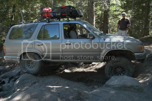

Carl, I love mine. That one has the 5spd which is good. The 3.0 doesn't produce much power so the slush boxes are really slow. Try to find out if they used new headbolts on the new headgasket job. Reuseing the original TTY headbolts is asking for trouble. Utimateyota.com and yotatech.com are more 4runner related and have a ton of tech info. Mine recently got retired from family hauler but it did a great job of it. It has done trips from CA to Vancouver Island and Montana, and I towed my m416 from CA to MN and on the way back wheeled in CO. It recently just did a DV trip and kept up with a bunch of newer models. Here are some pics of mine,
Death Valley
http://s38.photobucket.com/albums/e113/slosurfer27/Death Valley 07/
Local trail run
http://s38.photobucket.com/albums/e113/slosurfer27/Garcia Ridge May 07/
Also, the link in my sig has all the info and more pics from start to now.
I would really only worry about who did the head. I would assume it could have been done by a dealer under the recall, so the sellers just added it as a point. If that's the case, from the pics it looks like a 8/10 and for a 5speed with a sun roof killer. I always wished my '94 5speed had a sun roof.
