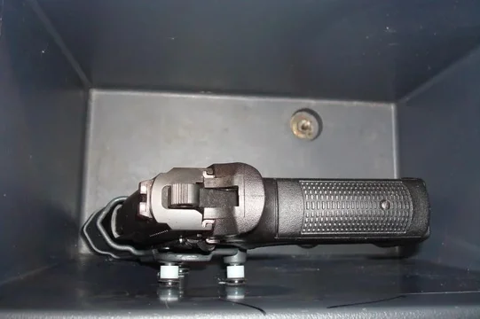

I added my pistol holster into the center console. https://forum.ih8mud.com/80-series-tech/353379-pistol-holster-mount-shotgun-holster-mount.html

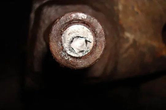

The 4.88's are in and awesome. I put on OME 2.5 medium springs and have 30mm spacers to go on too. Put on some OME nitrocharger sport 70L and 71L shocks. in the process I snapped off a shock mount bolt and snapped off both the front shocks post bolts leaving my rig disabled the same week I sold my other car. Broke the eazy out off in it too. Had the shocks 3 day aired so I had a car to drive. Wouldn't have been able to get this all fixed without some help. A big thanks goes out to Sparkie247(without his help, fab skills and knowledge I would have been hosed), Beno at American Toyota(http://www.americantoyota.com/index...fai=C4HmOlpigTMz1Mo6EygSWm6idBQAAAKoEBU_QXOe1)

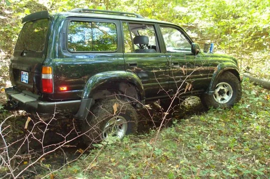

Wheeling...
