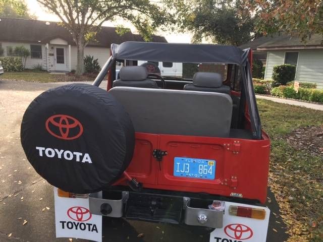

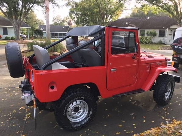

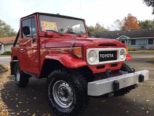

Thanks for the add . What is this? Supposedly 1976 from Colombia. Have not seen one with rear gas cap (missing), holes on hood (ornament?) no 4x4 emblem .help! Asking $13K. Thoughts?
Thanks.
Run away! So much wrong with that truck. South American 40's are notorious for being abused, having half-assed modifications and bush repairs. Many are given a quick coat of paint and imported up here to be sold, which is exactly what this one appears to be. I would not buy this truck if I were you; be patient and you will find a much better (North American) one.
Also, you will get a lot more feedback if you would post it in the 40 forum instead of the FJC forum. A moderator can move it there for you.
BJ70 turn signals.
'78 and up front end. With barn doors?
A "what the hell" front bumper.
One ugly roll bar.
Secondary tank removed.
Original gas door eliminated (for some reason).
Why would you want to drive with your head against the bikini top?
Rubber bumpers front and rear and barn doors on a late model are a giveaway that this is truly a SA truck.
What @1911 said. Leave it alone or offer a stupid low price.

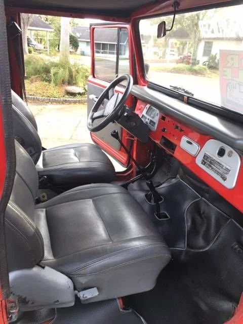

Carlos, I doubt I would pay more than $15,000 for it, if it checked out in person as good as it looks in a few photos, because I don't particularly want a 3-speed transmission and drum brakes all around. But it will probably sell for more than that, to someone who wants a '74 and/or doesn't care about those things.
