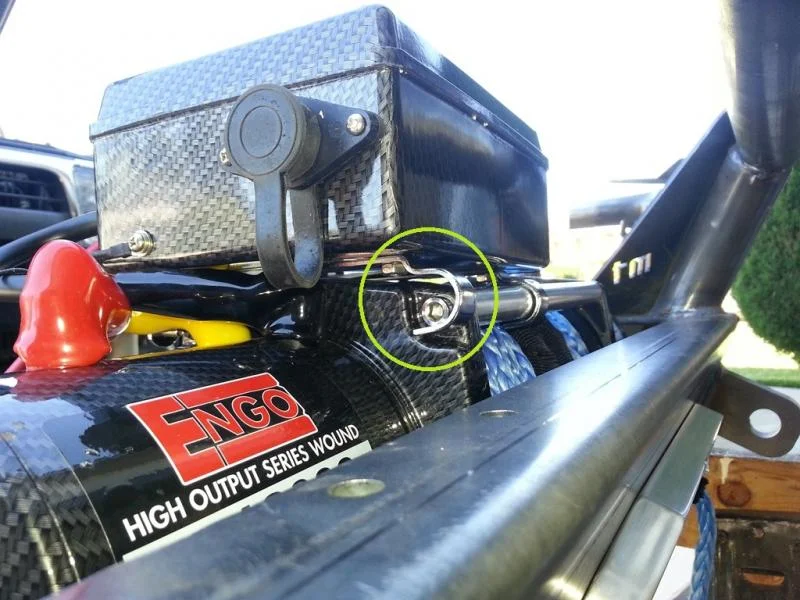

I just bought a new front bumper for my 80 series and got an Engo 12K winch with synthetic line to put up there.
I mounted the bumper and hooked up the winch last night, but came up with a couple questions. 1) Securing and placement of solinoid. 2) Spooling synthetic cable onto the drum.
Mounting the solinoid:
The mount worked just fine, but even when I slid it all the way to the motor side of the winch, it was obstructed by (what I believe to be) the "radiator" (?) for the A/C system by about 1".
I was able to move the solinoid further out on the winch, so it now hung over the motor and now clears the A/C "radiator", but it now only holds onto the rail with one of the two brackets.
From the "inside" of the bumper:
From "outside" (or in front) of the bumper:
It seems to me that the solinoid is something that doesn't get a lot of movement and I'm really just trying to keep it from moving around when I drive, but I'm concerned about how well it will stay on there with only one bracket.
Any thoughts or feedback on this?
How about pulling off the solenoid box and drilling new holes and relocating the bracket so both attach the bracing tubes?
I may do this.
The bumper came with a bracket for remote mounting a solinoid (for a Warn). You can see the mounting holes on the bumper in the foreground of the "Outside" bumper/winch picture above. Unfortunately, the bracket is not a direct bolt up application with my solinoid. On the upside, I'm sure I can use some of my hillbilly fabrication skills to mount my solinoid on it.
If that doesn't work or I don't like how it works, I may buy some longer cable and remote mount the solinoid under my hood.
Thanks
I may do this.
Thanks
I had the same problem with my MT bumper and ENGO solenoid.
I wound getting s strips of aluminum from Home Depot and bolted those to 2 bars that hook onto the rails then bolted the solenoid box to the 2 aluminum strips.
Now the solenoid hangs off to the passenger a little and clears everything.
