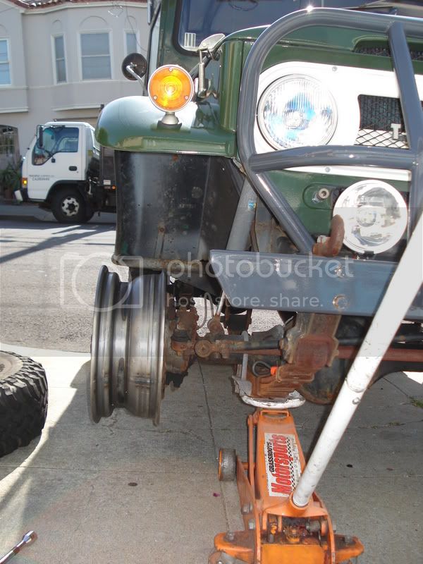

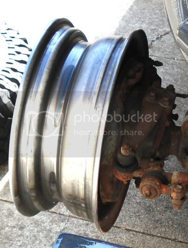

finally got around to testing my trial wheel that arrived a few weeks ago.
running fj60 vented rotors w/large 4runner calipers
16" wheels are available through summit with a custom BS = 3 1/8th inches
NO caliper clearance issues to report :)
now I just need to order 3 more, and rubber to match

Thanks for the pics. I have the exact same rim and wheel hub. I was going to use the 4runner calipers , but I went for the LC calipers instead . I was concerned with BMC more than with clearance.
Anyway what BMC are you using?
I also noticed that your wheel studs seem to be short, but maybe it is just my bad eye sight.

My calipers have 4 equal size (large) pistons, where other calipers have a two-large/two-small configuration.
The studs are fine, the taller then average lug-nuts give the illusion of short studs (your not the 1st to commented on this).
Thanks for your concern,
manny

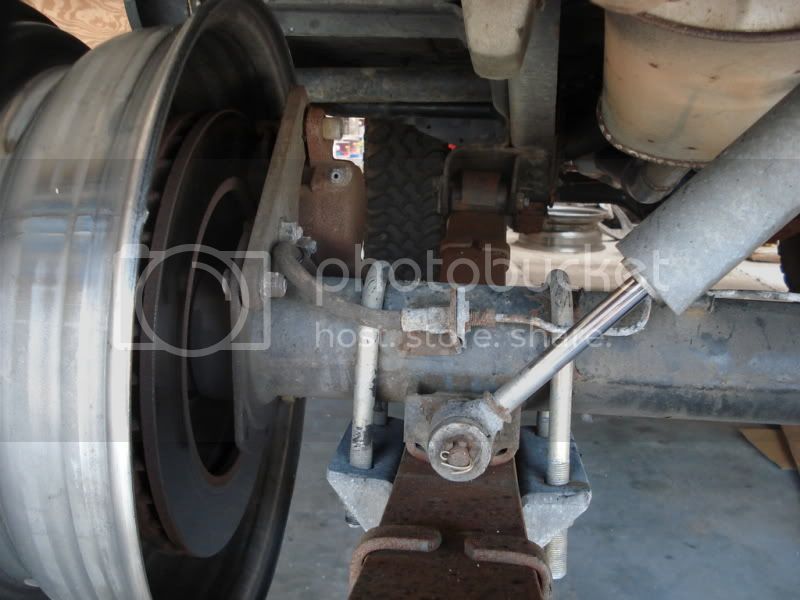

My MC came from a 4whl disc Supra I found in the yard (15/16" bore)...bolts right-on.
A cruiser shop that I trust told me this is the minimum bore they recommended for a 4whl disc setup.
My rears are GM MonteCarlo calipers, a common setup...tons of info from search/FAQ.

This reminds me, due to my GM rear-rotors, my rear studs were on the short-side (original 72 studs).
A set of fj60 studs (approx 1/4" longer) took care of that.

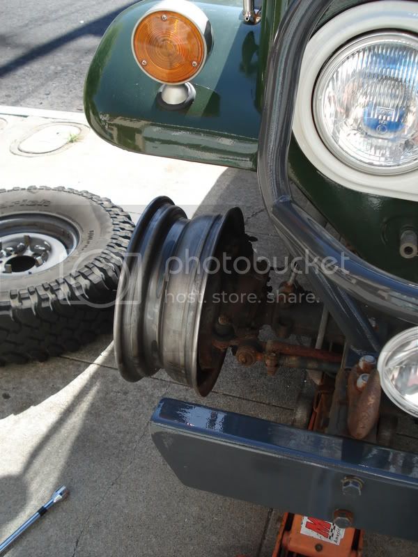

Looks like the TRE has plenty of clearance. Do you think you could have used say 3.5" or even 4.0" Back space? You should have a nice wide stance the way you have it. With 4.0" it would not be a custom order. I like 16" rims anyway.
Thanks Andy
Andy,
I'm sure you would not encounter any issues from running a stock 3.5" BS.

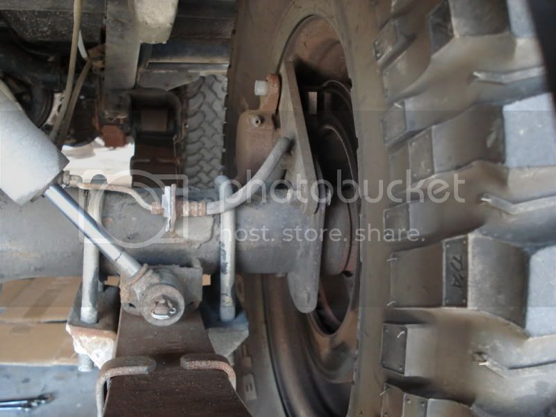

only other pic I found of TRE clearance:
gimp to the rescue :D
http://en.wikipedia.org/wiki/GIMP
With the stock 3.5 BS, I was already rubbing on the inside rear wheel-wells and caught the Steering Box sheet-metal cover.
For these reasons, I would not recommend running anything MORE then the stock BS.
I guess you could extend your bump-stops to limit the articulation if you wanted to run more BS?
If anyone is interested, I'll take some TRE clearance measurements when I get some tires.

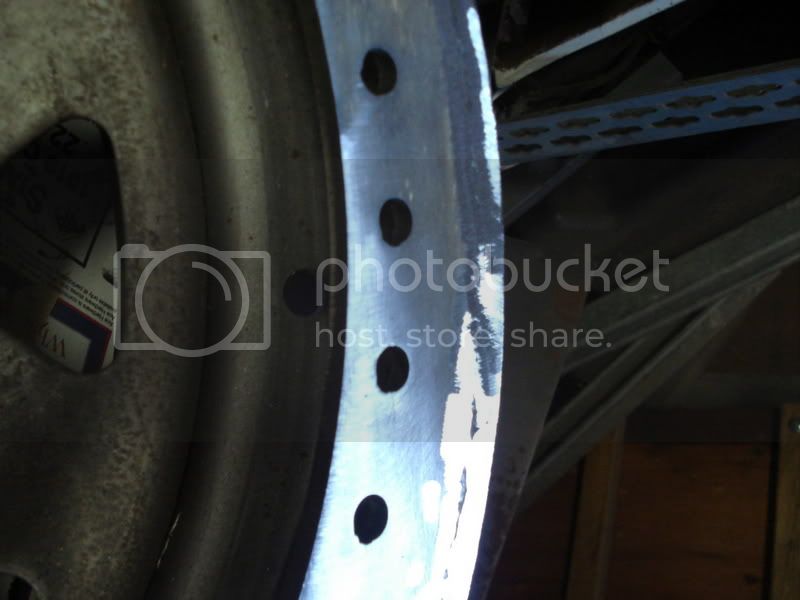

I am really pleased with my current setup:
Stock fj40 wheels (5.5" width) with 33x10.5 tires...I think 6" will be perfect for 285/75R16s.
The other reason for going with this width, is the future beadlock mod :D
https://forum.ih8mud.com/showthread.php?t=133700&page=2
These kits usually add an additional 1" to 1.5" to the wheels width.
Since custom BS wheels already come bare, I couldn't resist :D
remaining wheels arrived :D
Beadlock kit from ruffstuffspecialties.com, thanks Dan :D

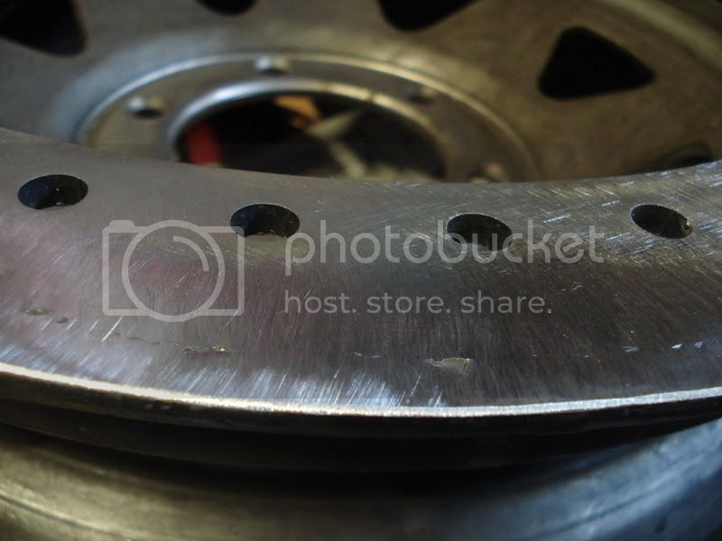

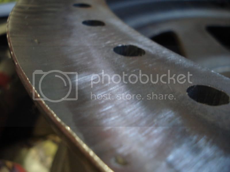

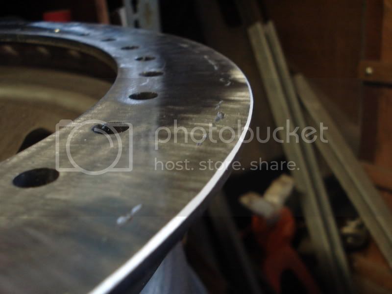

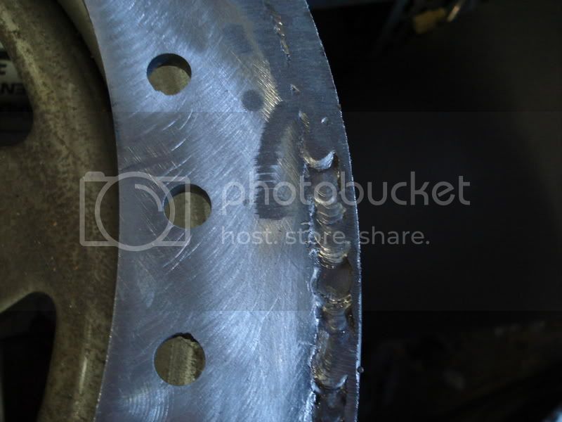

some progress...my buddy Doug welded up 2 inners :D
snapped a pic to show what it looked like before grinding
after more grinding
Doug took care of the valve = proper orientation is a good thing :D
after some sanding with a 60grit disc
I think this one is ready for etching primer and paint :D
3 more to go...
