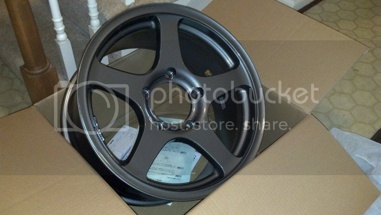

I just purchased a set of the 18" Weds in gunmetal from Dustin at FN Wheels. Wheels have been sitting in boxes for 2 weeks while I read through all the tire size threads. Still wasn't clear on what size to get, but decided to go with some 295's and hope to have them on the truck this weekend.
Dustin is great to work with. Answered all my questions and gave me a great price on the Weds.

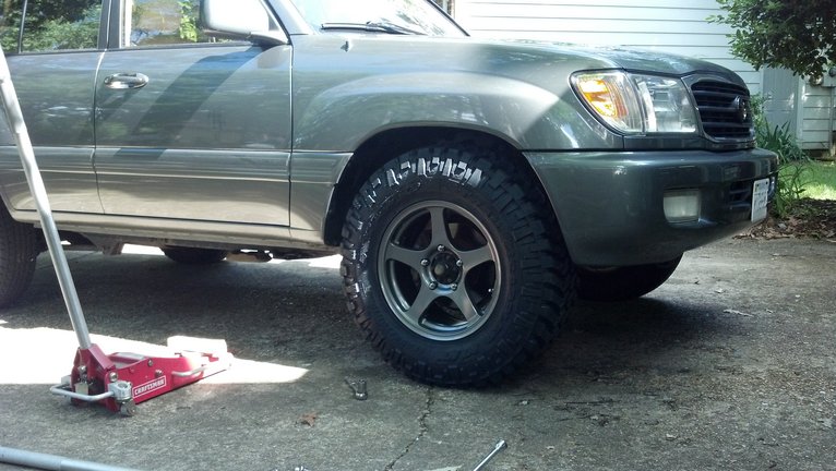

nice cant wait to see these on the 100, post pics asap!!
Those match well on your 100.

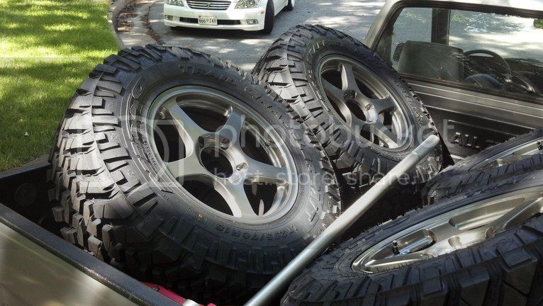

Looks great. I would think that you have to have some serious rubbing going on right now at lock. What type of lift are you putting on? Are you going to use JT or TC upper arms? I am not a rim guy, at all, but those look good.
Hey man they look great! w/o a lift are you rubbing so far? and what size tire did you go with?! btw whoes altezza wagon in the backroung?! :)
you can see the tire size on the tire in the picture........
