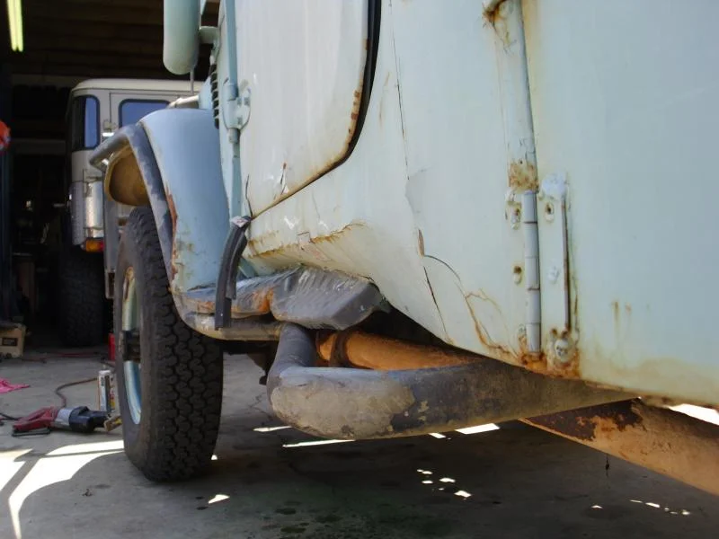

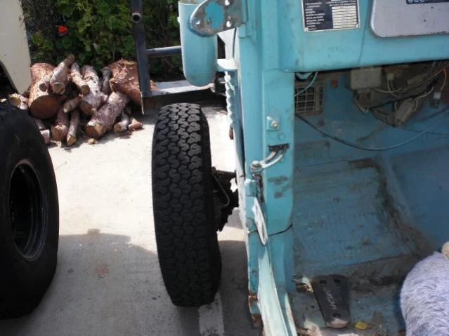

Tom had a few life detours, then bad went to worse for the troopie. Broadsided at speed, the insurance company wrote it off as a total loss. The left side roo bar took a fair share of the shock load, tho in some respects it also ended up being a damage multiplier.
No frame damage, but both A and B pillar damage, with extensive damage to the rocker and the cowl.

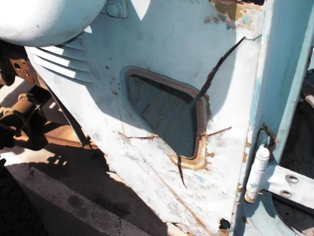

The area around the kick vent in the cowl must have been a secondary point of impact, as it is caved in about 1.5", yet does not show the signs of scarring typical of primary impact. This force also carried across rearward, with the A pillar caving in about 3/8".
Tom brought it to me last week to see what I could do for the truck to return it to usefulness [he bought it back from the ins co pretty cheap;)]
In these cases, I usually start with making several cuts in the body to relieve the stress from the stretched metal. I told Tom I would try to remember to take some pics along the way. Here's one back at the B" pillar where the stress relief starts.

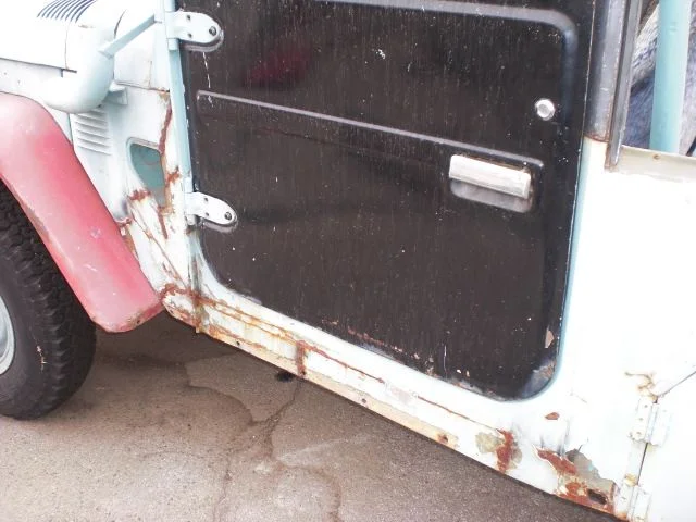

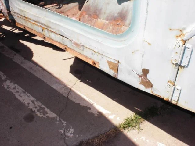

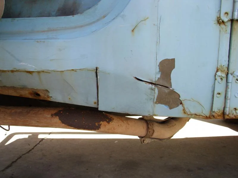

After the second round of cutting, pulling and beating, the rocker:
the cowl [still needs one more cut:
and most importantly, the A pillar:
I think we are ready to test-fit a 'new' door.;)

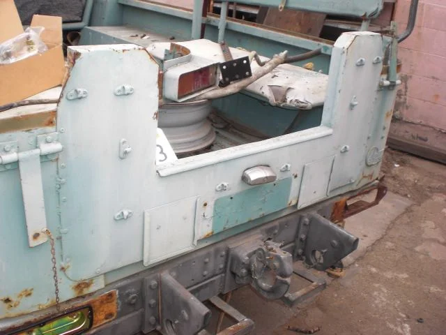

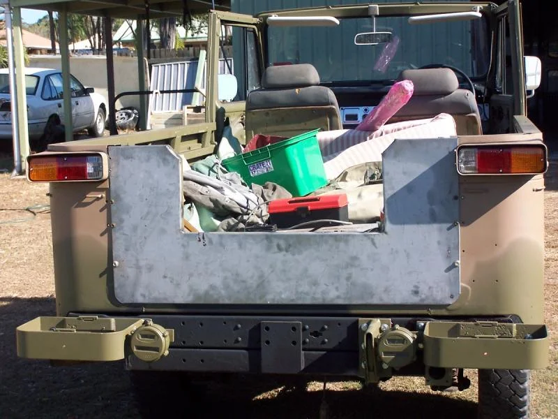

The next step in the project was to remove the Norforce rear entry and move the mil-spec taillights back to the factory location. The custom rear entry:
…which is now removed and available for purchase.:grinpimp:

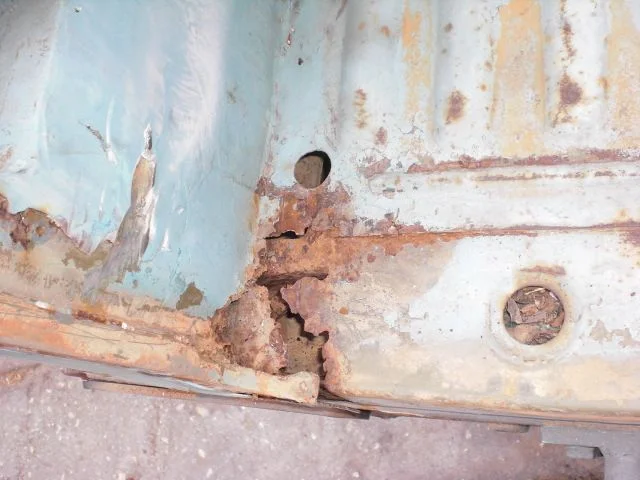

Having seen the rust holes in the cowl and rockers, I wasn't holding out much for the rear sill. It could have been worse:
So just to clarify, this rig will be returned to factory spec [not Norforce spec]?
