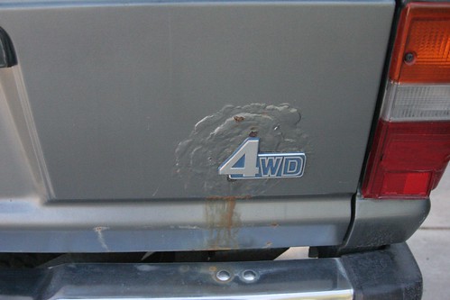

What is your current tool situation? Do you have a decent air compressor with pneumatic grinders/sanders etc.? This will make the job easier, butif not you would at the very least want an electric grinder to see what's underneath the emblem. Using a block and a piece of heavy grit paper would be grueling to say the least.
I'm gonna say it's a 99.9% certainty that you will have rot behind the emblem. If you use an electric grinder I'd recommend a flap disc (Harbor Freight sells inexpensive ones that will work fine for the area you need cleaned up). I'd get a 60 or 80 grit wheel and have at it. You'll be able to see the real story once it's down to bare metal.
Once you get to that point you'll more than likely have to have some mig welding done to patch up the rot. It's a nice flat spot, so it's not going to require a ton of bending/dollying to get it to look decent. If you don't have access to a welder I'm sure a local mud member would be willing to help out.
Get it to clean metal and post up a couple of pics. You are also going to want to buy some epoxy primer to apply once you get it to bare metal. You can also roll it on.

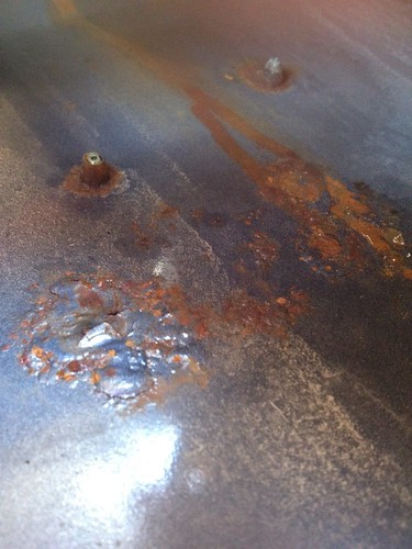

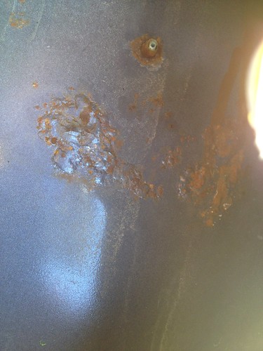

So pulled the rear carpet this weekend and there was ZERO rust in there, so happy for that especially around the wheel wells.
I did take the small cover off the tailgate which allowed me to see the inside of where the 4WD symbol is and this is what is in there.
Untitled by renofizz, on Flickr
The paint is just starting to bubble in there with some rust showing but pushing on the metal I do not feel any popping or anything. Have a feeling I am still going to need to replace the metal here though but wondering if I can use a rust converter and save it?

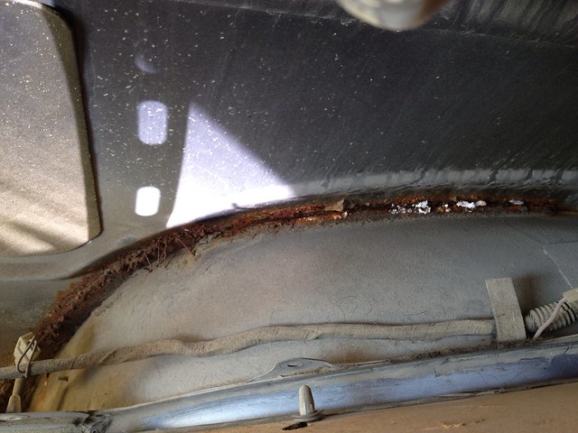

Pulled the drivers side panel this weekend to start my rear panel rebuild and this is what I was greeted with. The white you see is not sunlight coming through but actually some chalky white substance (dont think its salt as we dont salt the roads here). I pushed on it a little and the metal didnt budge or anything so seems pretty strong so I am hoping this is salvagable with my intent to go with a Monstaliner paint job and if need be I will get this crap out and then use their Chassis Saver in the wheel wells.

As far as your latest pic, good luck getting down into that area with any kind of wire wheel. Maybe get a sandblast hopper from Craftsman or Eastwood that you can hook up to your compressor and try to get your hands on some dry ice blasting media so it doesn't leave a sandy mess in there. Or the crevice tool for your shop vac if you end up using any normal blasting media.
