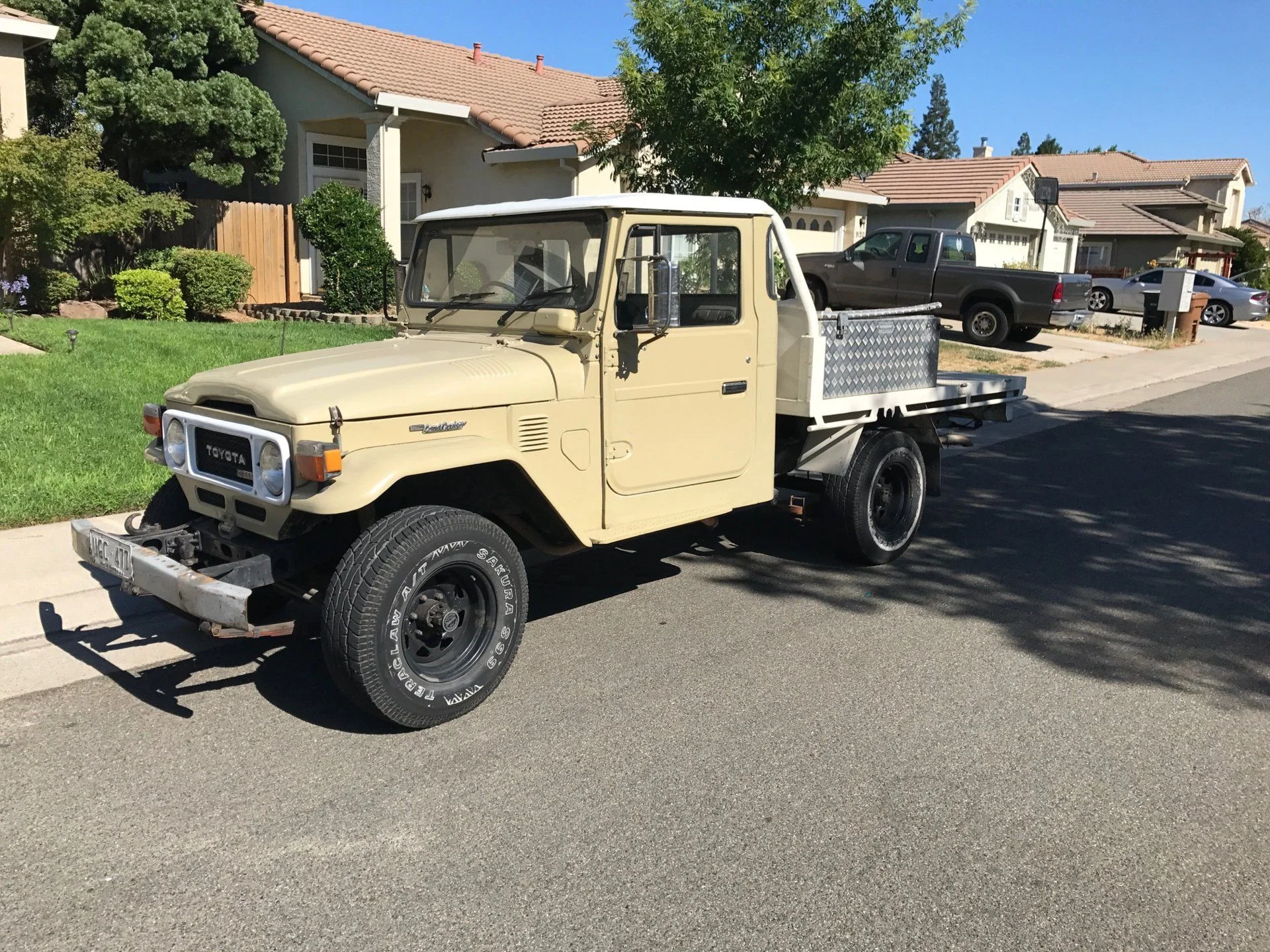

Right now, I've got it up on jack stands, ready to be ripped apart for a lift. I know my options (from creepin this forum) are: SOA, OME 2.5", Small Shackle Lift, or Custom Springs.. I'd like it to be around 4" with 33s.. I'm not a huge wheeler,yet, but will maybe hit trails once in a while..
One of my biggest concerns is what I'm currently running. Are my springs stock? Do these usually have the 2 stage springs in the rear like mine?
These pics are: When I picked it up in Oregon, how I drive it every day, and test fitting the 33s from my Tacoma (they clear with no rubbing at all)
Thanks for the welcomes, I look forward to hangin with yall on iH8MUD
After some reading on mud, I decided to call cuiser outfitters about an ome spring lift. I sent these pics, and Bryce (?) advised me that my rig appears lifted with these springs.. What do yall think?? Thanks for the input
I have a sudden urge to go serve beer in 'stralia.
Nice looking ride that looks to be in great shape. Welcome, enjoy the madness.
Agreee with Jack those rears look aftermarket but doesn't really look that lifted. Whats the true size of that tacoma wheel/tire combo? 285? 255? it looks great on there.
The rear springs don't look stock. The fronts looks stock. I have 33's on non lifted trucks so that's not anything to go by.

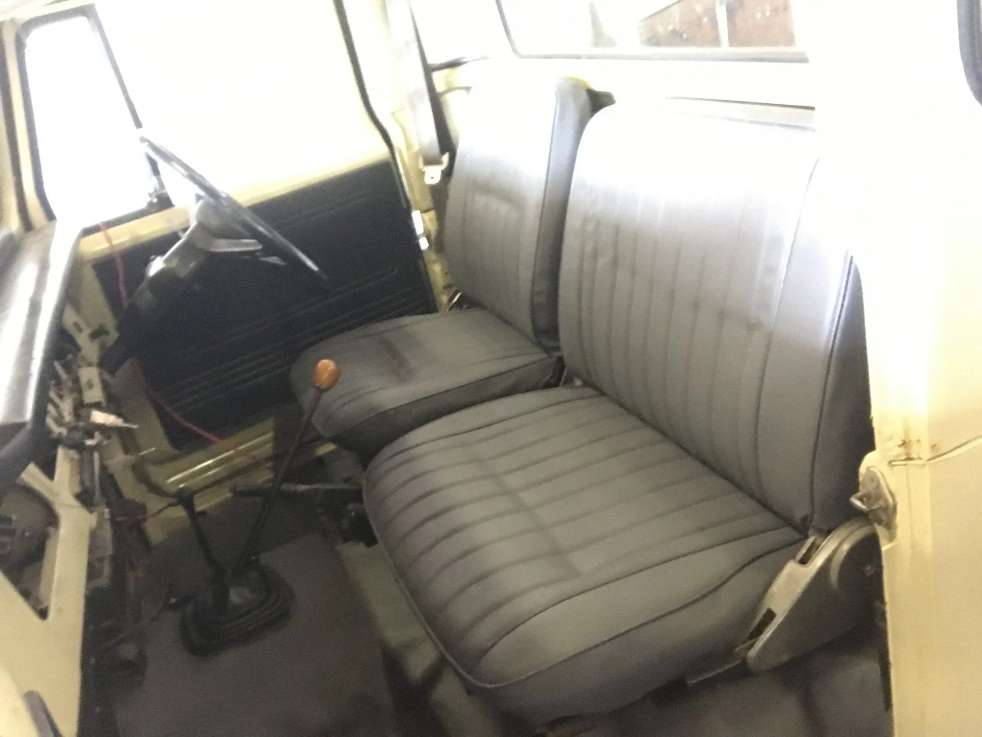

Seats reupholstered w/ spectre covers & TruFit mat installed. I bought this mat myself when I was in Australia. If anyone needs to know about trufit mats/ carpets, I can give you what I know..

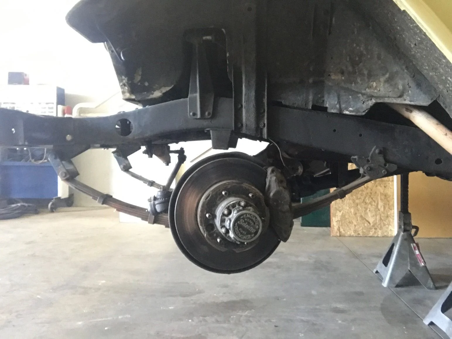

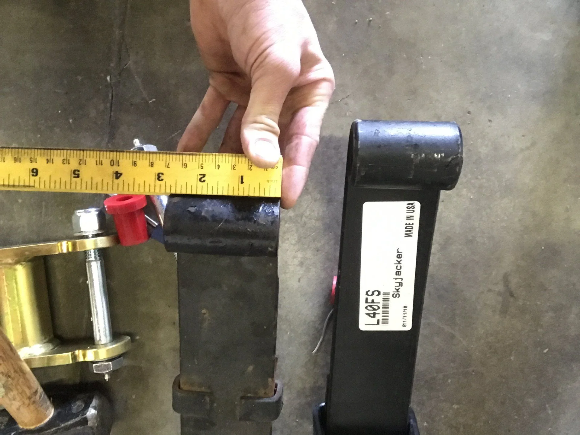

So, I've still got my rear springs being built (4" higher) and I order skyjacker front springs. But now I've ran into some problems.. my new skyjacker springs are not as wide as my stock ones.. my stock bushings are thinner than the skyjacker ones they suggest I use, so I thought that was the problem. After ordering & installing the new bushings, the extra space is still there.. I thought maybe I had the year wrong, but after double checking, it all checks out. I'm stuck.
I am not one to know every detail, but it looks like your spring perch ID is 3". It also looks like your leaf coil is 2 1/2" OD. I would think that would leave you about 1/4" for each of your bushing flanges. Do you have those to measure?

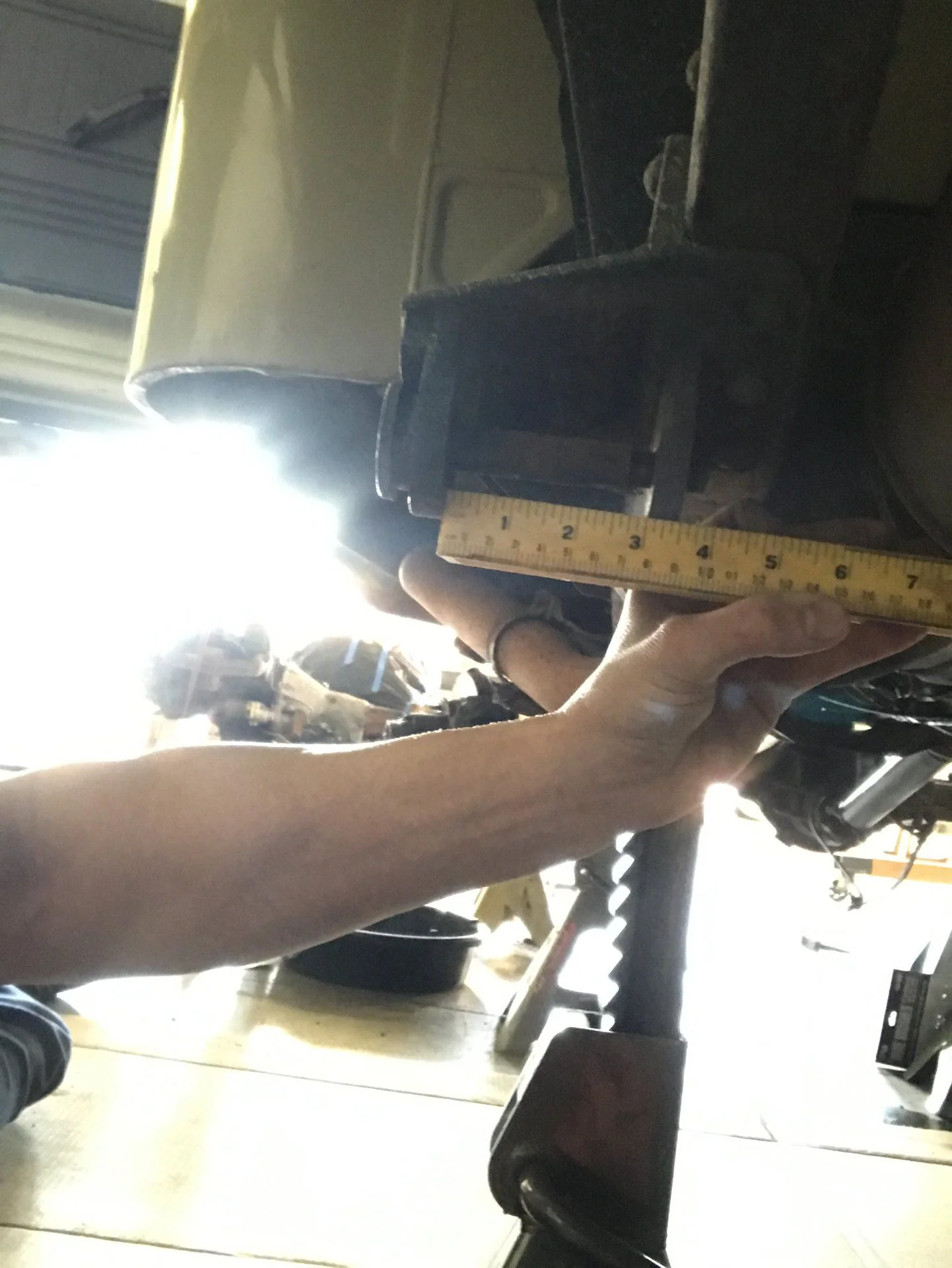

I went & measured my rear perches for ya. Hope these help out
Thank you, believe I might know where I can get some spring perches from a late model.
The spring perch on the late model has a large opening on the outside that the bushing is inside the perch giving it more room.
