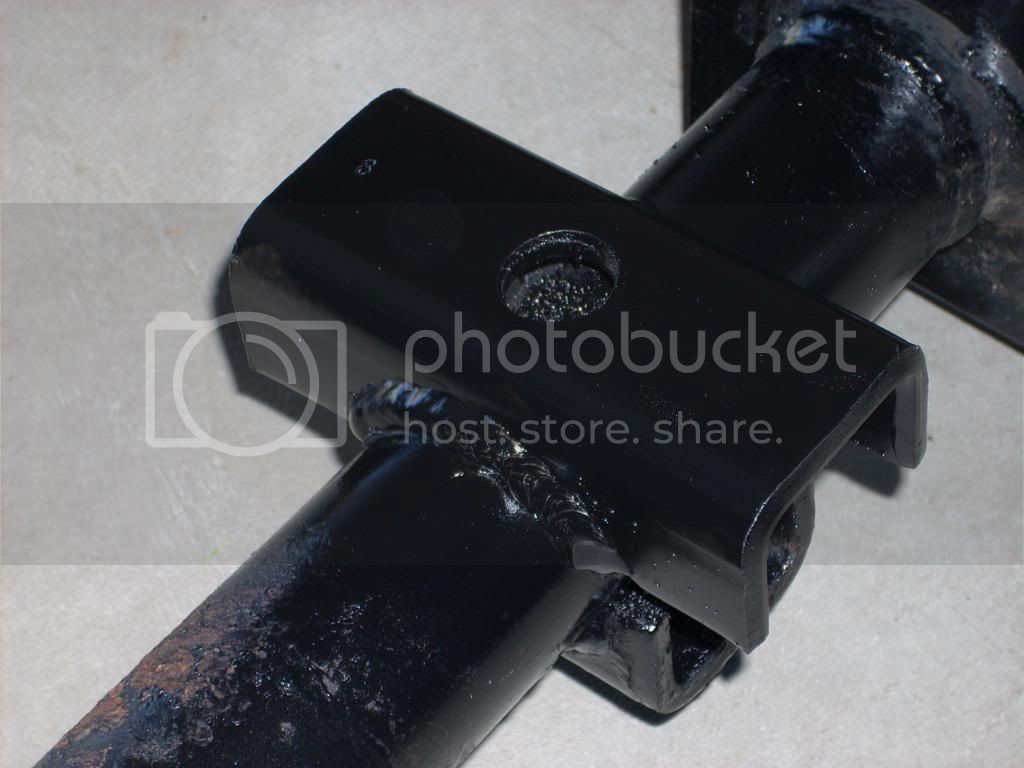

3) If you want to convert the trailer to spring under you cannot simply "flip the axle". The axle has camber built into it, if you flip it the camber will be reversed and the tires will wear unevenly, and fast. Looking at the picture I suspect the PO did the spring over and flipped the axle, I would remove the axle and determine the camber then proceed. If the camber is correct you will need to weld new spring perches on the underside of the axle for a spring under set-up.
You can see the camber on my axle in this picture
This picture shows the axle with the new perches welded on, I left the original perches in place. I was doing a spring over but you get the idea.
