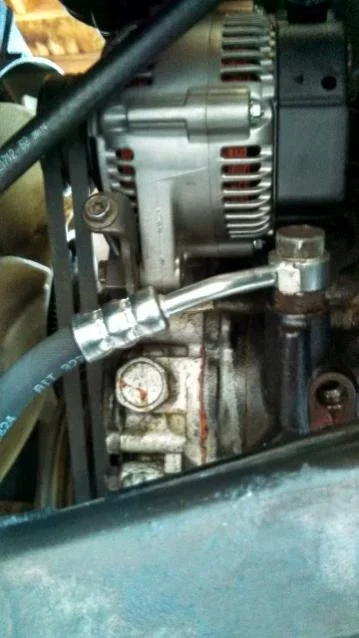

Much easier to install alternator with the steering box out of the way!

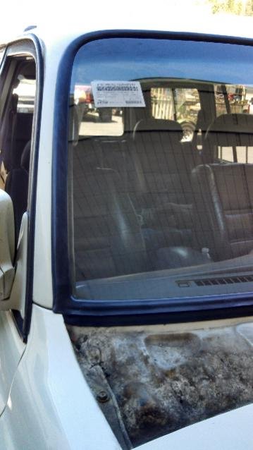

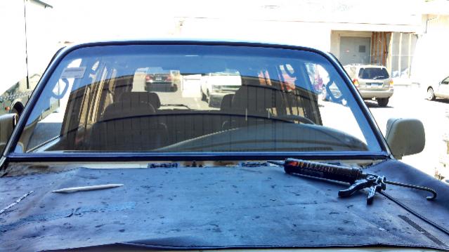

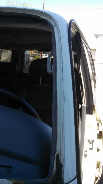

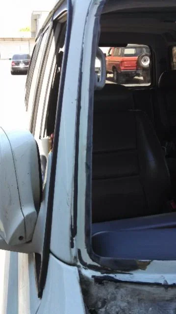

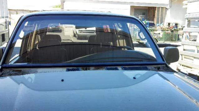

Advanced Glass and Windshield of Grants Pass did an excellent job installing my new windshield!
Previous didn't use much/any glue...
How much did he charge you Travis?? Moby needs a new one of those pretty soon. It is blasted pretty good. I'll bet when you're sitting in it it looks like there's no window there!:clap:
Windshield and install was $240.00 I chose to purchase the seal from Wheeler Toyota ($54.00) instead of have them order it from their vendor ($79.99 plus $29.99 for shipping). And honestly since my windshield was not glued on either the glass, nor the frame, my seal would have probably been re usable. I can't tell you how happy I am with their work though. Not only a good price but excellent attention to detail! I didn't have to even mention the specific process for a Land Cruiser install they explained it to me when I called for the quote. Also they did it while I waited and I saw every step along the way and he explained what he was doing and why as he went. I learned a super slick trick to getting the seal in with a rope, pretty f'ing cool!!!
Oh and yes it's AMAZING how trippy it is to have a NEW CLEAN windshield. :clap:
