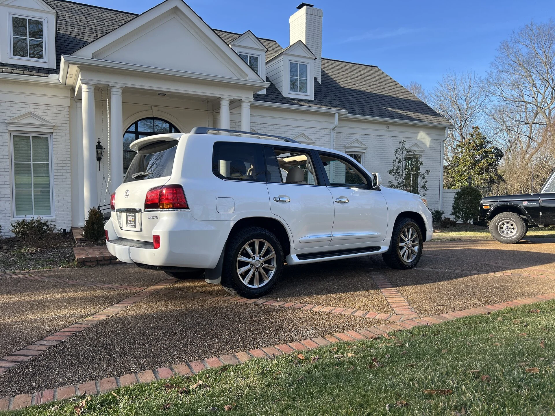

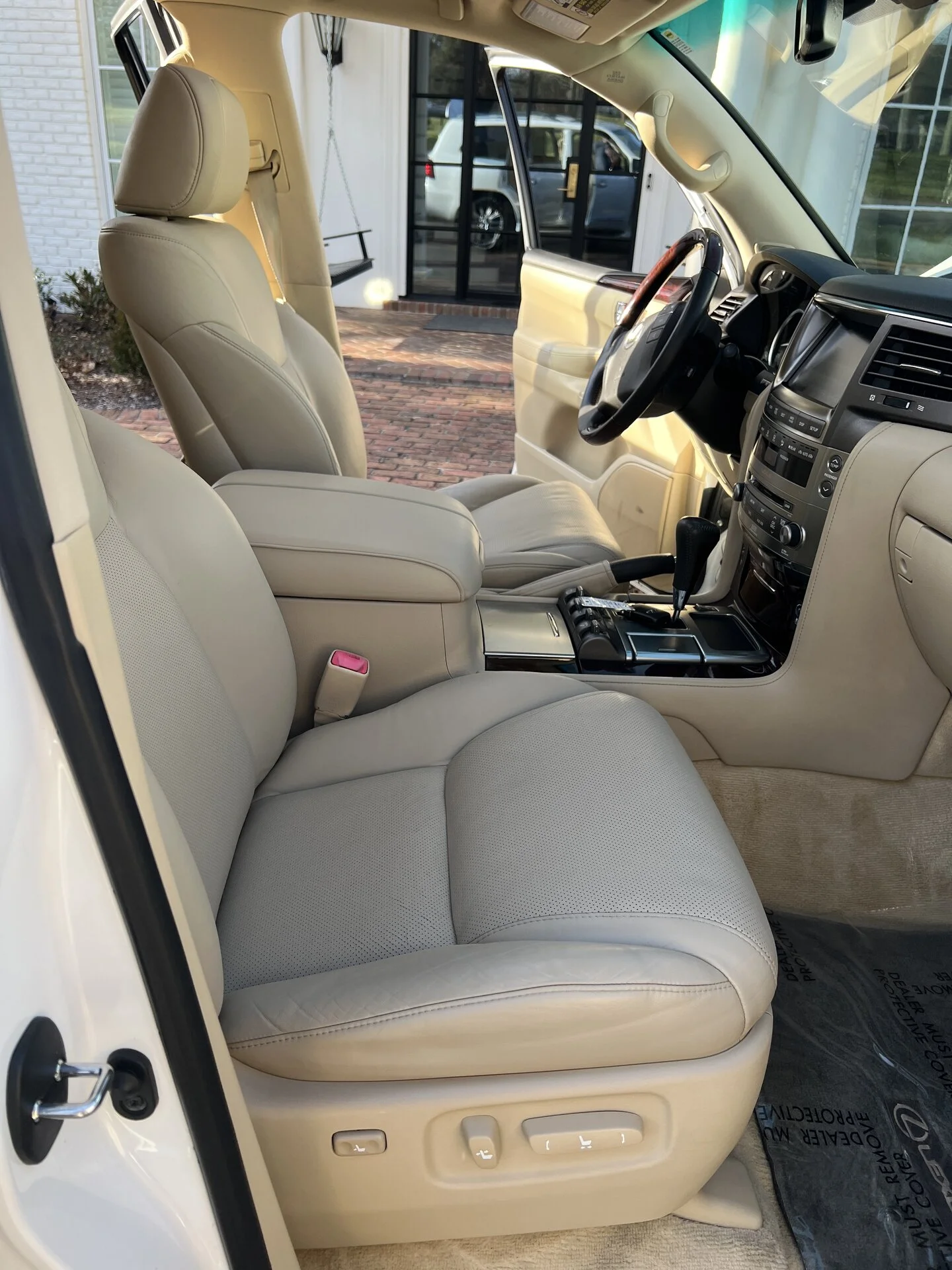

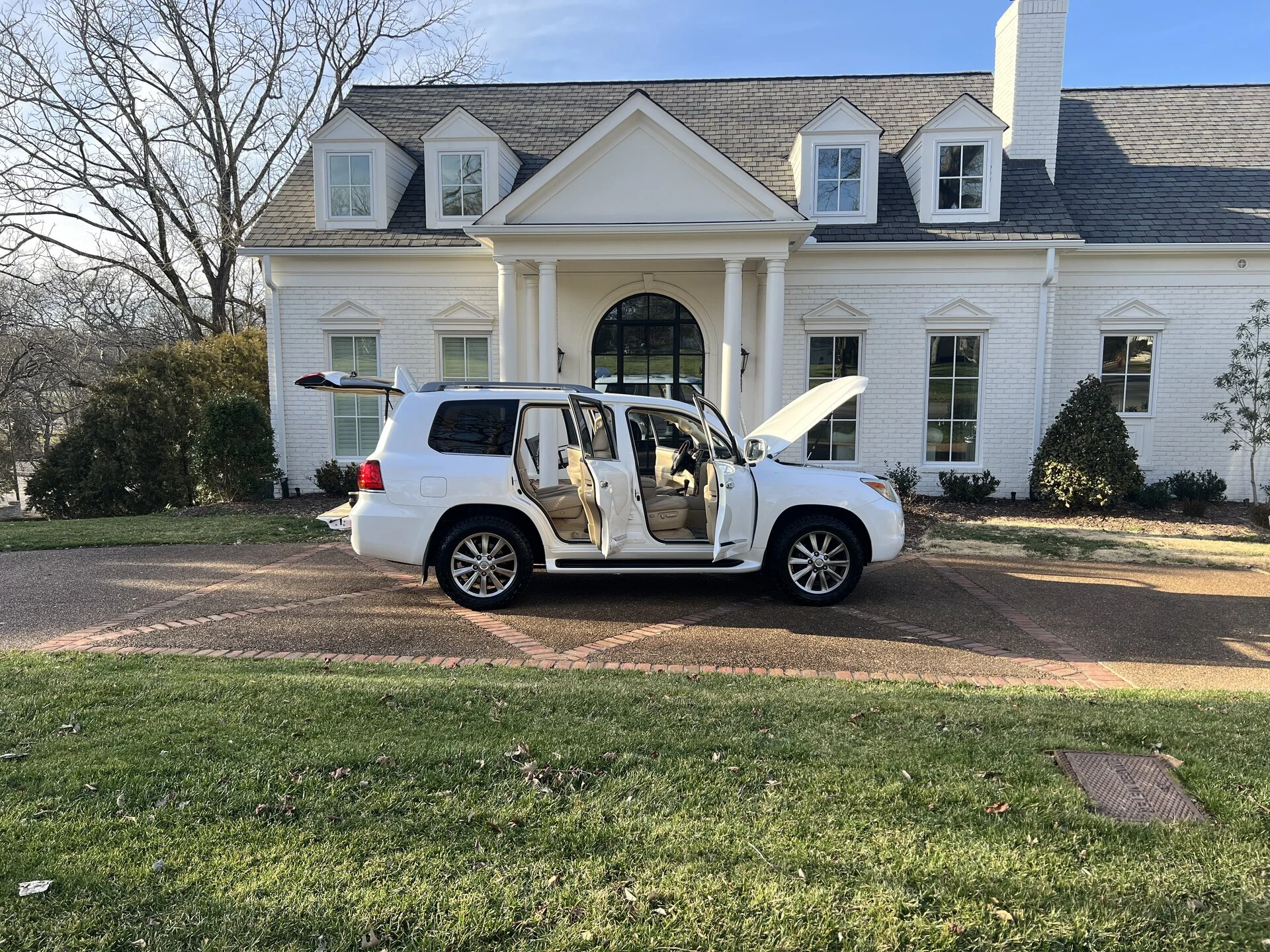

I just switched from a 2006 LC100 to a 2011 LX570. 'Super rare' Pearl White / Cashmere w / 155K miles and it looks like the maintenance is up to date. Pics below.
Overall, I am very excited about it but I have a few things to work through before I turn it over to the family.
