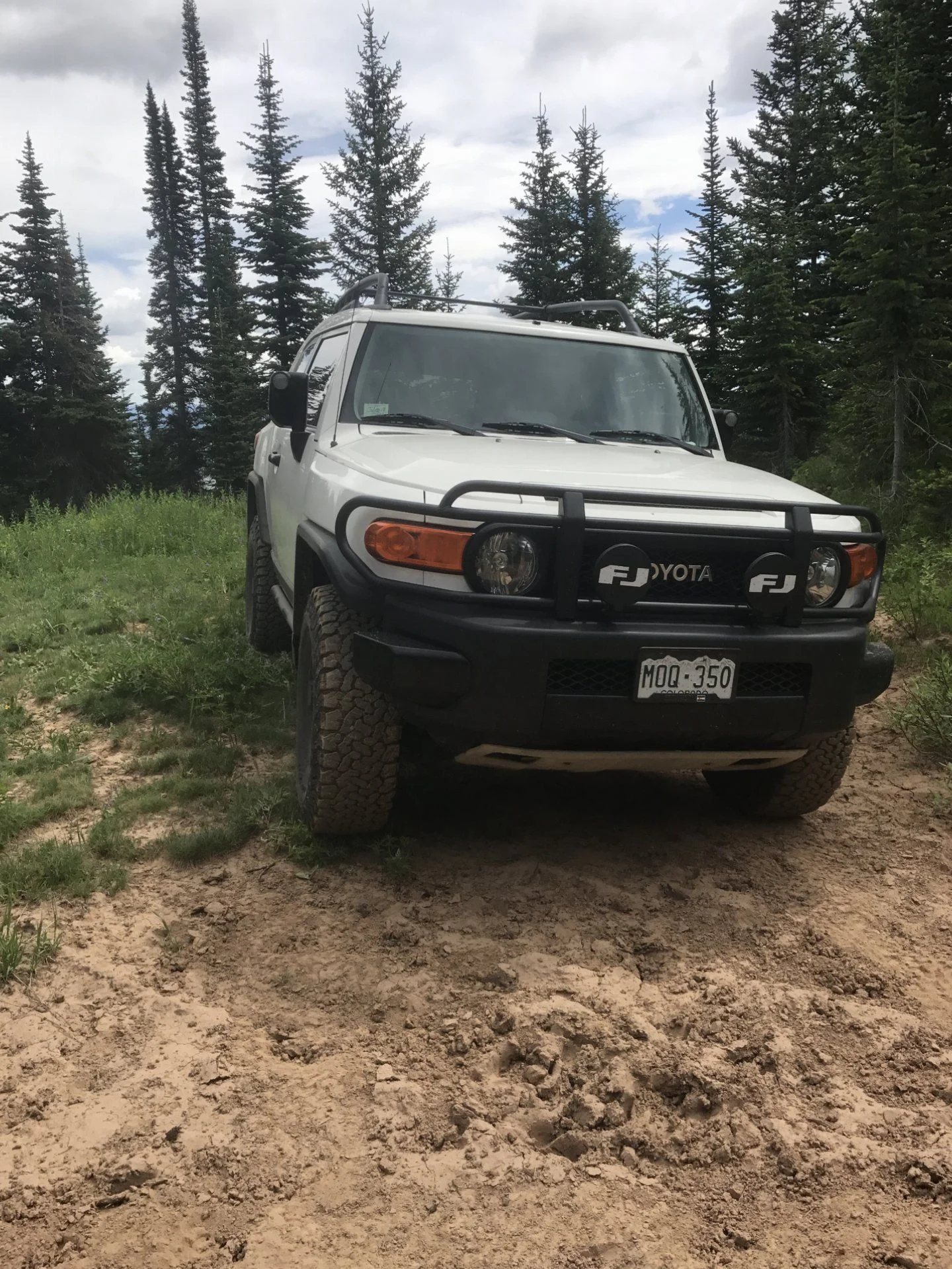

Driveway poser shot and took it camping the first week I had it, of course.

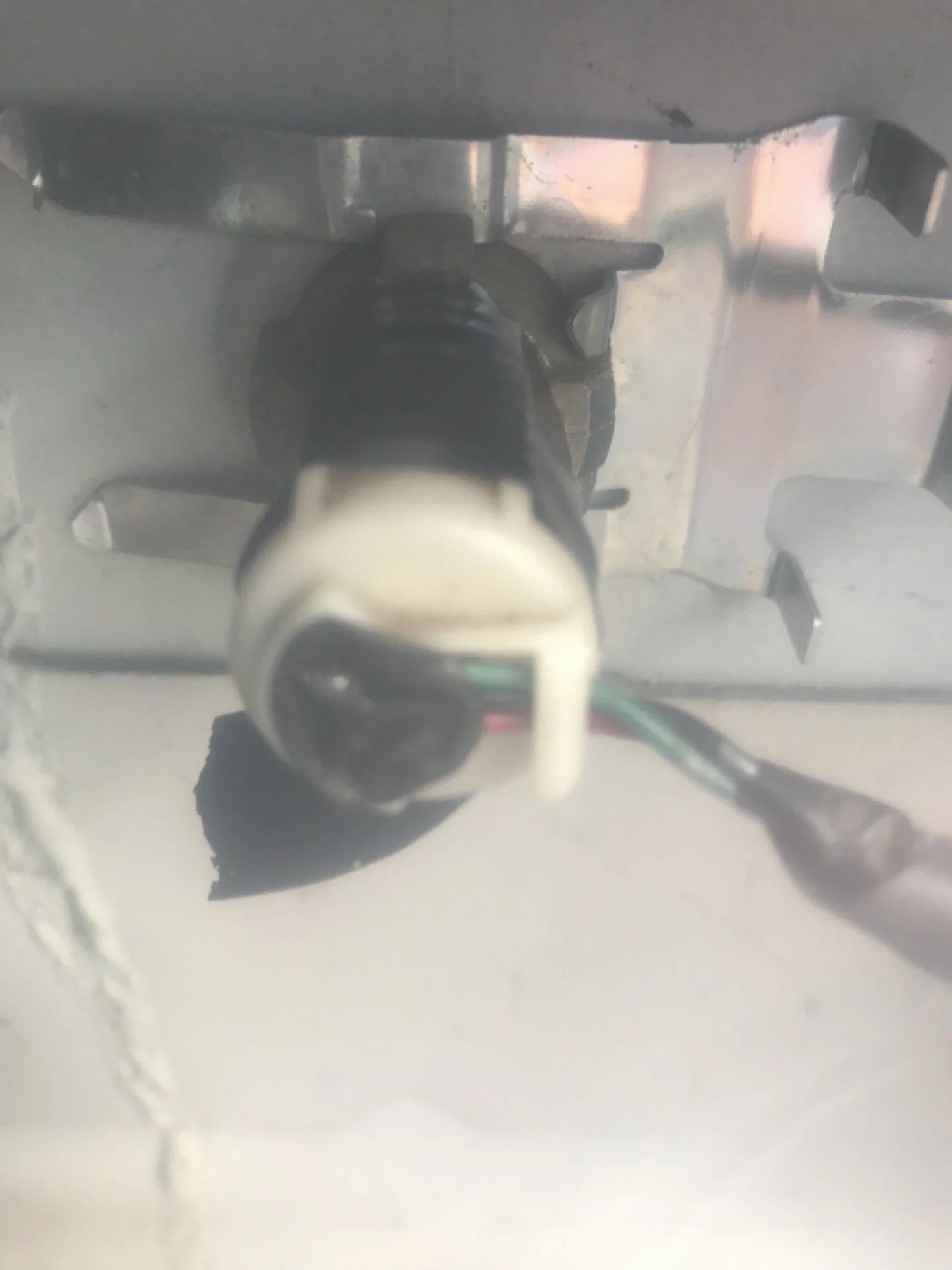

First repair. Could not find this anywhere on the web. Rear window would not open, fuses All good, took rear panel off and checked all wires, all good. The smallest of clips holds the actuator wires to the lock set. It was barely hanging on. Taped that thing on in the photo. I would bet this has happened to others.

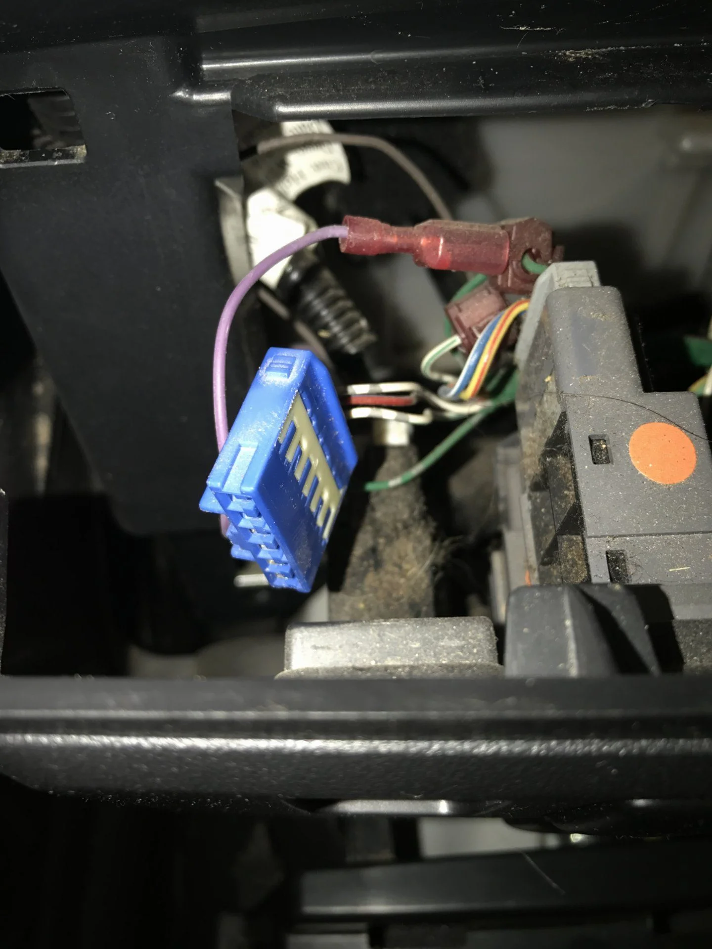

Ok what's this? The switch is a dummy plug, but the blue part was seated in it.
Upper left in the button panel, next to the Diff Lock
Probably the VSC cut-out wiring harness. You can probably buy the button and activate it.
Uggg internet searching.
Pre 2010, it was not an option.
So why the blue harness? Guess I'll have to get the switch and find out.

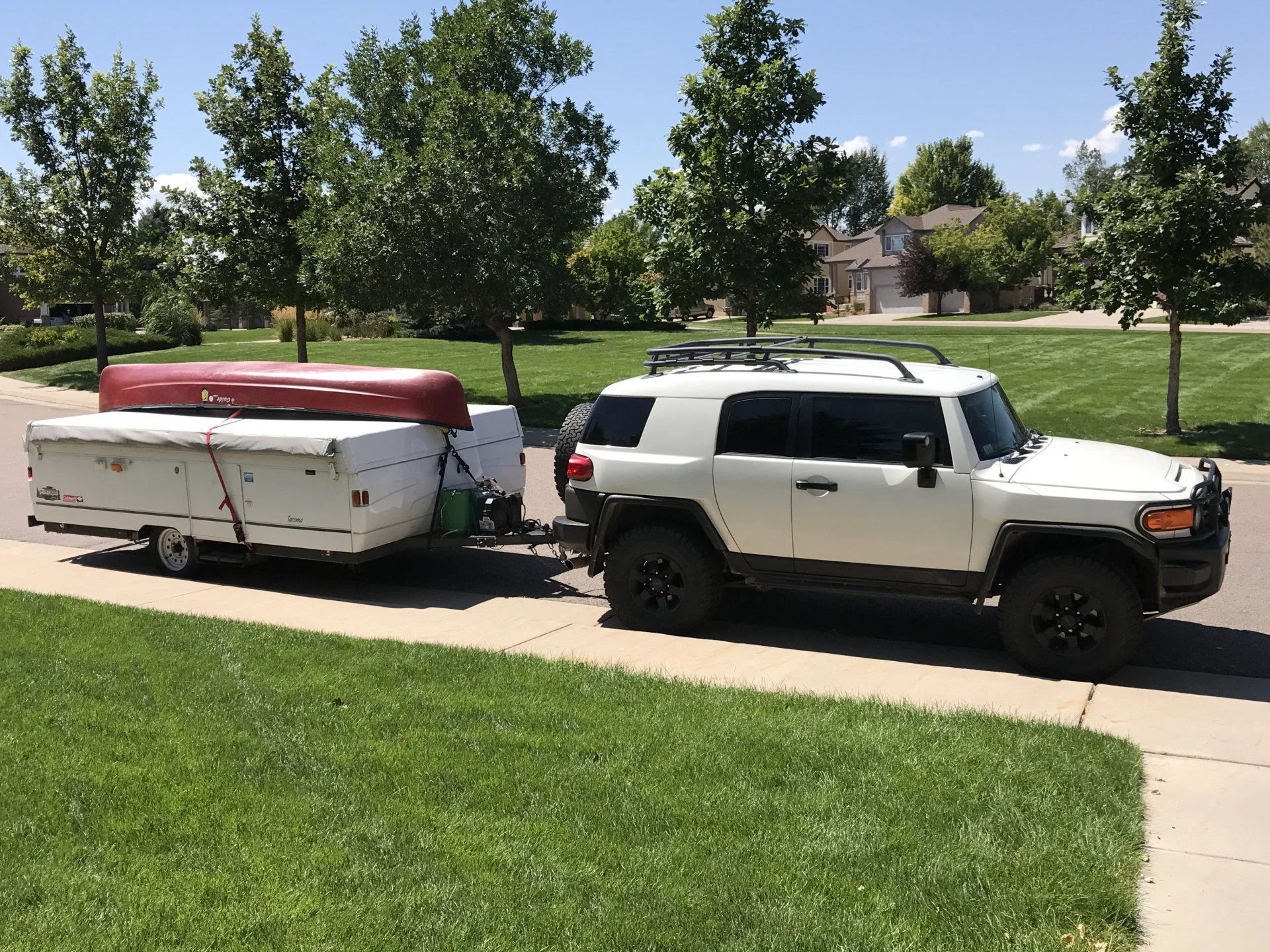

Welcome and nice FJC. How did your rig do while towing? I have a similar pop up with a kitchen slide out that I tow with a 1/2 ton. I think the camper weighs in at 3,200 lbs. I've been reluctant to tow with the FJC because of the weight. Thanks in advance for any input.
It tows fine. It does not tow as well as a 100, but it works. When fully loaded, watch for bumps on turns and be prepared. My pop up does not come close to the 5K limit nor would I be comfortable towing 5K with and FJ.
