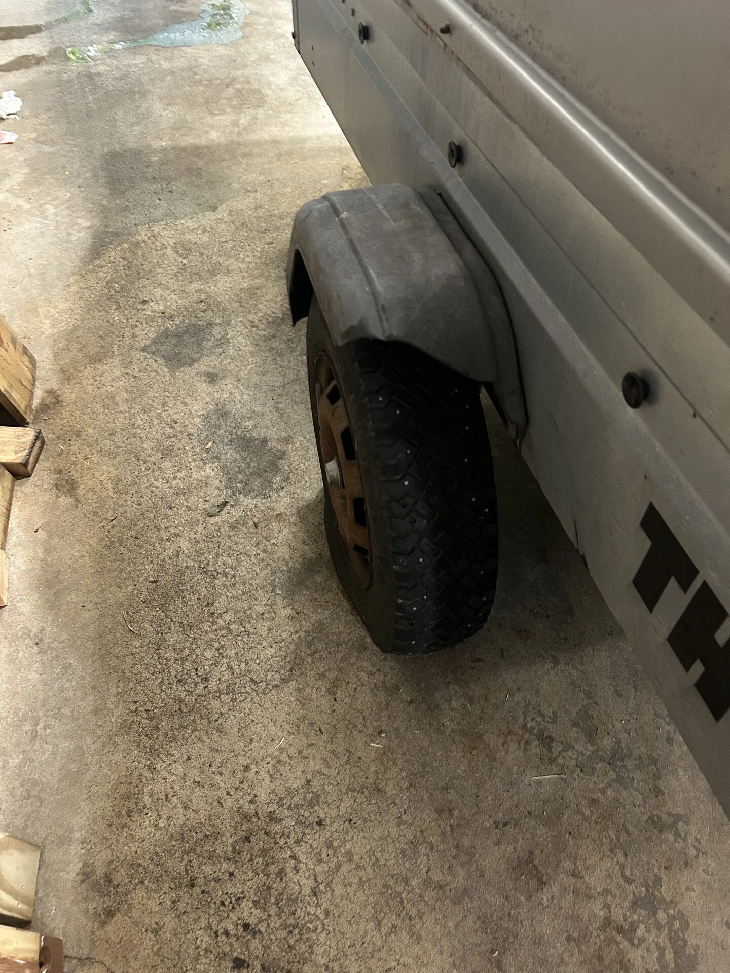

Hi all, I just purchased the Thule (Brenderup) 1205. Unfortunately, it has been neglected pretty bad and needs some fixing.
Fell in love with this trailer the second I saw it. Then found this forum and spend a couple days reading everything i could! Great info.
So i'll show some pictures, but I need lights, struts, fenders, tires (prob rims too), i'm sure bearings and not sure about axles... looks sketchy but maybe someone can weight in on that based on the pictures. I found these wheels on Amazon and wondering if they will work if I move/replace the fenders:
Amazon product ASIN B01GV17DZ6I don't think the tires are anything special but at least I will have a rim that I can buy tires for in the US.
Am I better off buying rims from Germany like others have done?
Thanks for any input!!

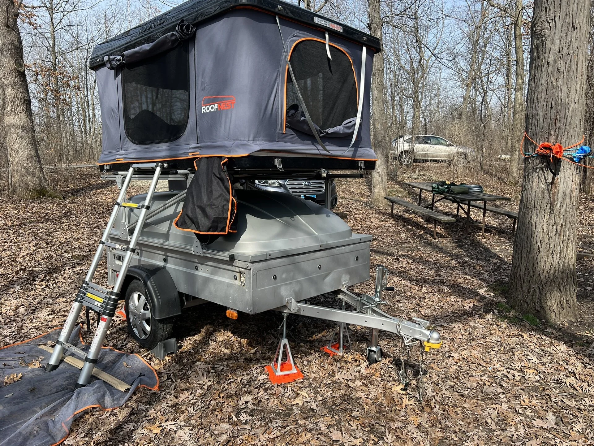

Hi all. Long time lurking, first time posting!
Like pretty much everyone else, I was going stir-crazy during quarantine times and ended up purchasing a RTT in early 2021. My partner and I got a lot of great use out of it but were finding it annoying to pack it up any time we needed to drive for a trailhead, make a supply run, etc. Long story short, I spent ages researching trailer options, sifting through posts on this forum and other similar websites, and keeping an eye out for a used trailer that would suit our needs.
In Aug 2022, I got lucky spotting Thule 1700 on FB Marketplace and had a deal with the seller within a couple hours of it being posted. My partner and I are based in Chicago IL and I drove to Columbus OH to scoop it up. There were minor repairs needed and it needed new tires, but overall the trailer was in decent condition for its age given the original owner stored it outside. However we'd just bought our first home and didn't have budget to make the repairs/mods right away, but it was just too good of a deal to pass up. The trailer spent the remainder of '22 in a storage unit.
We finally started on repairs and making modifications in spring this year. For mods I had a local fabricator weld together the corners of the lid, add d-rings on the long outside walls, and add on toggle clamps to the rear. Leaning on the incredible detailed info everyone has provided on this thread, we built a rack which our RTT now sits on permanently. We added locking holders for a couple Spector tanks, and will soon have quick-release brackets for a shower awning (so the awning can be on whatever side works best in any given campsite).
Since May this trailer has been on a half dozen camping weekends and one 4,000-mile road trip. It has completely changed the way my partner and I go camping. It also makes it so much easier for me to take a quick trip alone when he isn't feeling it. I LOVE IT.
My upcoming plans for the trailer include replacing the warped plywood bed, adding spacers to raise it up a little higher, replacing the old rivets with bolts, swapping out to an articulating hitch, and probably getting beefier A/T tires.

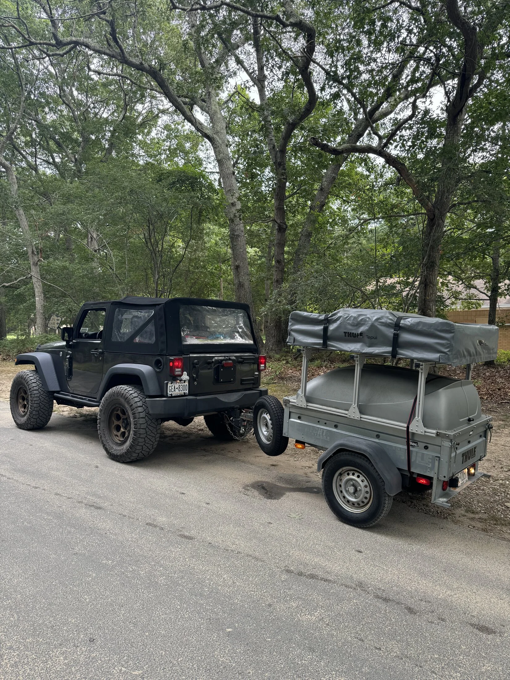

Wow, it’s been 15 years since I last posted in this thread! Holy cow. I love that it’s still going. Here is my Thule, 15 years and about $8000 invested in it. I had an entire frame built around it. That’s an aluminum lid with electric actuators to lift it. Yakima rack. 14” OEM wheels with 27/8.5-14 mud terrains. Custom battery box on front between two bins that hold either a propane tank, or a 7 gallon water jug. Locking yeti cooler on front. It’s been 15 years of tinkering with this thing. It serves me well, still.
