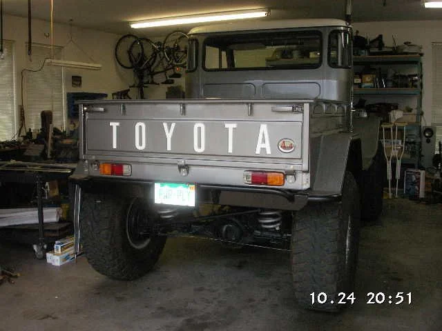

Ok, got the font worked out and had a set made and installed. They are a perfect match and will cost around $25 for the set in all colors of premium vinyl. The reflective stuff is almost 3 times as much at $60, but is a little greyer in daylight than I wanted. I never found any info if our trucks came with the letters highlighted, but I like the look.

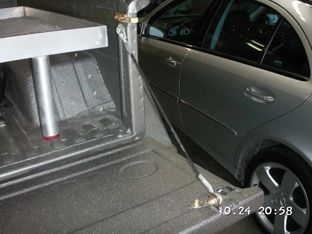

I also made a cool discovery on the tailgate issue. I was debating on what type of cables/chains to run on the tailgate and started looking at newer trucks. It turns out that my 03 Dodge Ram has cables that are within 1/4 inch of allowing the tailgate to sit perfectly parallel with the bed. The Dodge upper retaining bolt was used in the factory 45 hole with a nut on the back side. On the tailgate end, I made a bushing and used a nut and bolt to fasten to the stock mount, but keep the cable loose so it can move with the tailgate.
