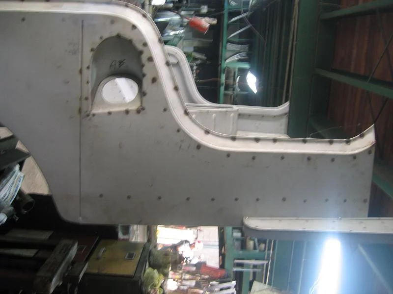

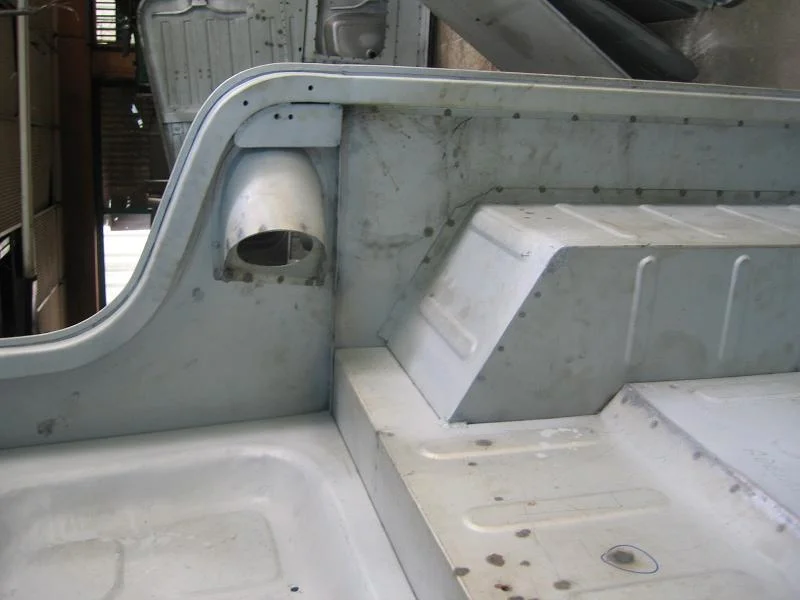

You knew I wouldn't leave you guys out.:cheers: :cheers:
OMG!!! Why didnt you do this before I ordered the floors! I would have just ordered the entire thing!!! Man that looks nice. PM me a price please.
BTW, the rear wheelwells are missing a rib on the sides. Its smaller and at the very front of the well. Kinda hard to see it in this pic but...
Also, how much for the steps? I need two sets.
Well, um no ............................... I never imagined that you even thought about making 25 tubs. :crybaby:
Send me a price, PM or 1960fj25@sbcglobal.net :D
Having destroyed a couple cowls, you don't know how sick this makes me. :frown:
Interesting choice of the swingout tailgate doors instead of the "correct" dropdown tailgate for the factory soft top body...were you using a local 25 as a model? I only ask because every North American FST I've seen has the dropdown, while the South American FST 25 I have has the swingouts...
Is that a "tall" toolbox?
Phil your asking if it's a high tool box, Mike's worried about the small rib on the side of the wheel. But all I'm worried about is it's going to be a big pain in the a$$ to changed the battery.
There is too many little things wrong with this first one you might as well just sell it to me cheap:rolleyes: Just kidding of course, it look really nice. I'm just like Jim surprised your making the 25 tub, but unlike Jim I have not cut any cowls up. May as well PM me a price minus the side steps and any type of tailgate. Can this be trucked up thru Mexico or is it cheaper to ship by boat?
John
Yep there was no other option down here other than the swing outs..that is how this one came..I met the original buyer/owner, and that is how this one came from the factory.
yes on the toolbox
Paul.
Mike..the next one will have the correct ribs, And when I made your floors I never had this 25 in the house( wish I did as It would have made things a whole lot easier)
These tubs are going to be available through Heritage.
John.. After I made Mike's floors I was on the look out for a 25, I wanted to be able to offer all of the tubs if I could.
Regards.
Paul
John
Regards.
Paul
Paul, I just looked on the Herritage site, and for a 3/4 25 tub the price is $4452.74 without freight. Is this american demonation money value? Thanks John Pardi
