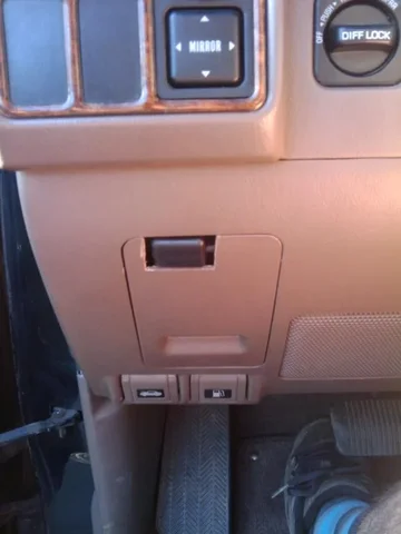

Good job LC. That is the best mounting I have seen yet. I decided to go with the ashtray mount. The hardest part of the whole instal was running the wire under the dash. as far as the OBD port, I left mine accessable throught the fuse pannel (dont know if a shop will need to access it at one point). I unscrewed the two retaining screws and clips, placed the clips on the obd mounting holes and dropped the whole thing into the dash about 2". I admit I wanted to finish the project before the wife got home and If I was using my head I wouldnt have cut the fuse box cover to accomodate the 1/4" of sensor I had left sticking out. Oh well. The finished product looks great and It is an incredible feeling to know whats going on with your motor!

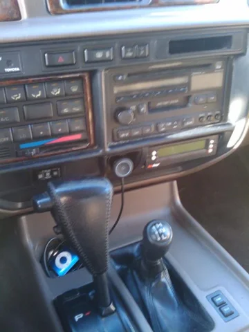

Il give the android app another rip, but till then this is my scangauge II mounting.

the odbII port has an alternate mounting point so that you don't have to trim your fuse panel cover... :doh:
Yea that's the second pic I see like that, and I cringe every time!
I know now. I totaly screwed the pooch by cutting the fuse panel cover. I will look for another cover and do the job right next time.
Im learning. I am from the mini truck world and I guess i just got used to having to cut things up to make them fit.:meh:

I put mine where the ash tray goes, same as 95LCMachine did above. Took out the ash tray and filed down the sides of where the ash tray went and it fits tight enough not to move. looks good and cannot tell it didnt come as OEM, got the idea from another mud member.
