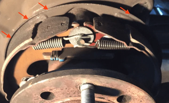

After replacing rear rotors, pads, and all ebrake hardware (all OEM Toyota parts) I found I had a rub-scraping noise only on turns (coasting through a turn), not in straight line. I attributed this to a very narrow tolerance inside edge near where the shoes sit of the new rotor; rubbing on the e-brake backing plate (not the dust shield) red arrows. I think also a little lash in the axle presents it self here in side to side motion. Over time the rub goes away as rotor hub wears in. Nothing to be overly concerned about- just a little annoying.

yep.. thats the rim I was filing and grinding smooth. Such a tight tolerance, definitely annoying when the circumference has flaky rust.

I had a similar problem with turning that was resolved by grinding down that inner lip (red arrows) where it seemed to be rubbing the rotor.

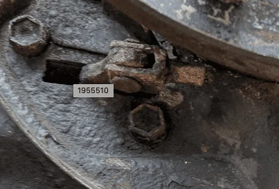

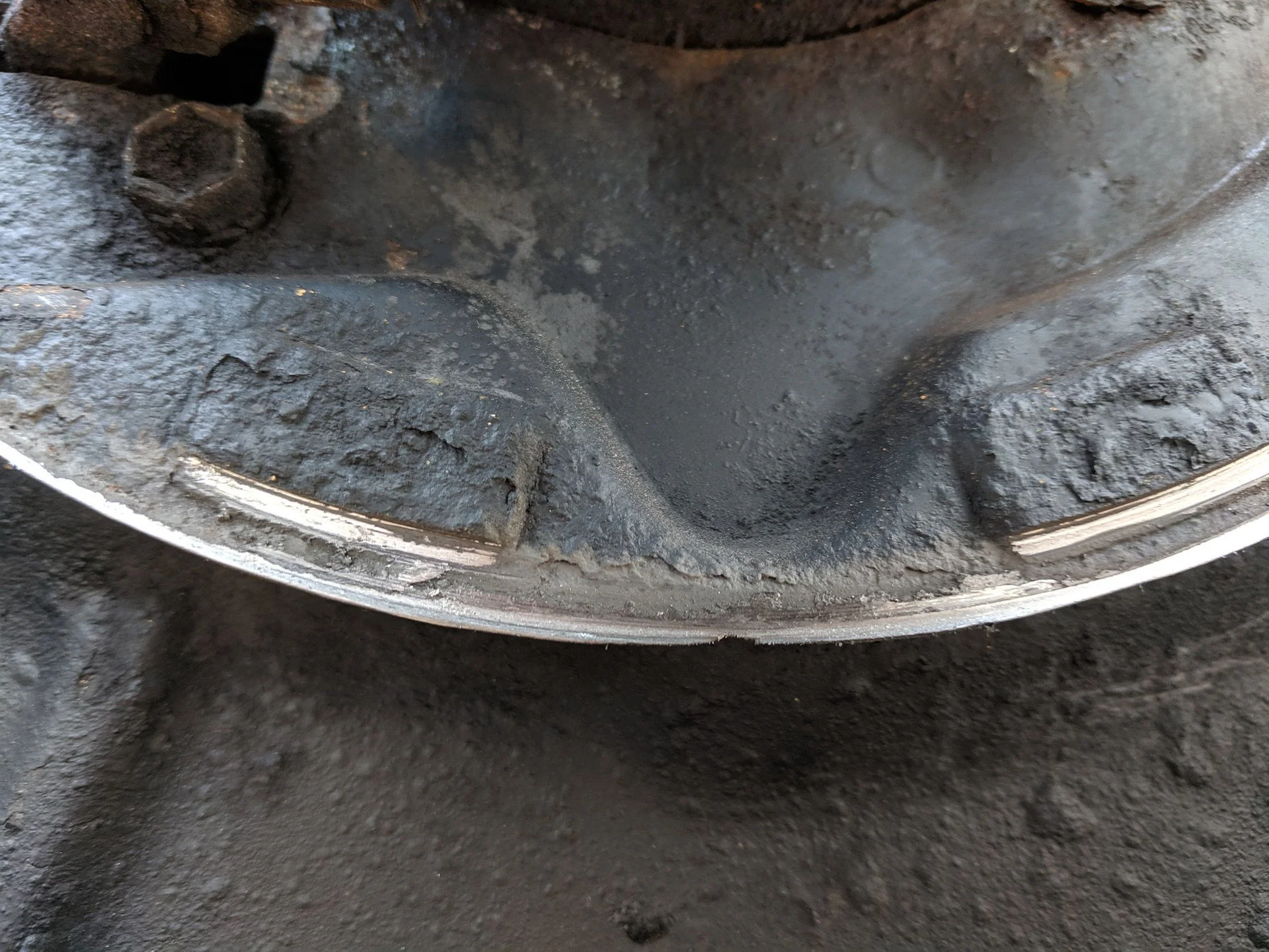

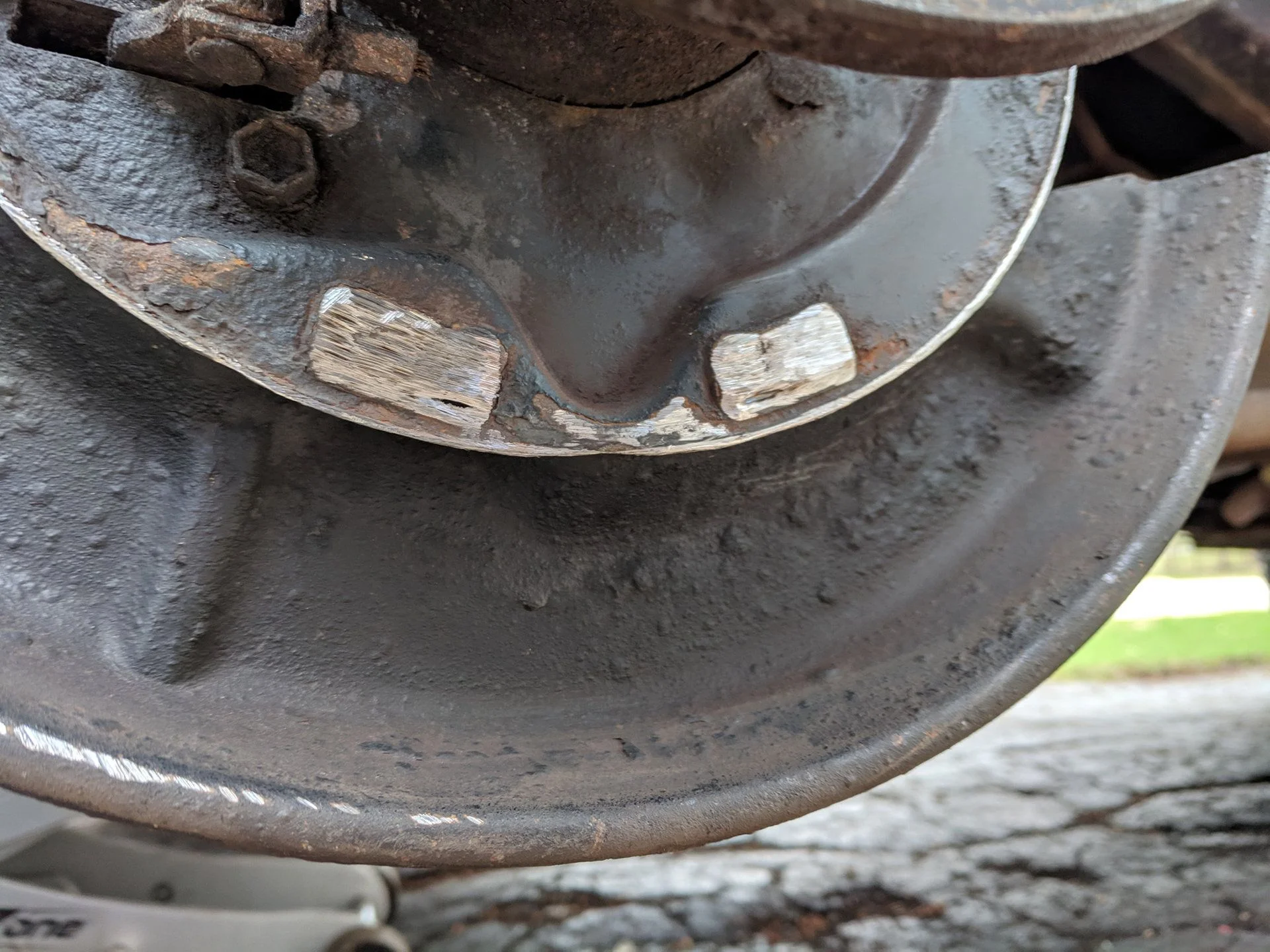

Finally.. took the grinder to it one more time, as well as a 3lb hammer.. problem solved. the first 2 images below show the wear pattern..lol, I'm not sure the paint was even necessary. You can see how deep it was cutting, not just the lip [from 4-8 o'clock] but 2mm deep in the proud surface rectangles. Flattened all fairly flush, and gently pounded the edge back about 1mm. Went for a drive and took some really hard turns, no issues! What a nightmare.

The grind:
