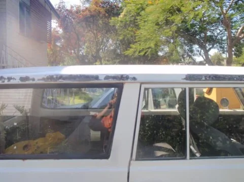

Small development, started a little bit of work on the pig the other day, started chipping some rust from the roof's rain gutters on the drivers side (right hand side in my neck of the woods) haven't got pics of this yet.

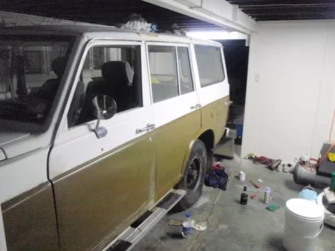

but i did also start to get the paint 'looking' a little better for now, grabbed some 600 wet n dry and cut n polish to the paint rear, i took a pic at the halfway point so you can see the difference, not much so far but its progress...
Looks like its coming along nice. I love that colour. Id say she was an ex government fleet vehicle. They were generally repainted back to standard before going off to auction. Possibly owned by the firebrigade, or the PMG (the old Aust. Post) as their vehicles were red. It would be interesting to see what colour it is under the red. My guess - Brown.

funny you shoudl say that, cos when looking at it in a few places it seemed the red was under the current colour, but over in other places??? this makes sense now... so you recon it was more than likely the terrible (but kinda loveable) colour it is now?
not keeping the bumper in that particular form. getting a winch for her in the future, not sure if its the distant future or even more, but for now i think im going to cut it back to a small stockish looking unit? ideas comments welcome

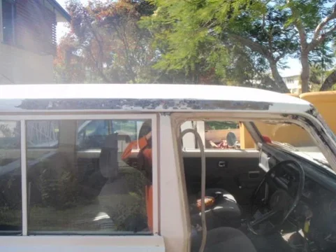

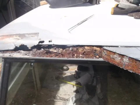

hey guys, as mentioned earlier i have started to nock out some of the rust out of the roof well i got back to this the last few days AND i got pics of my travels for your visual pleasure.

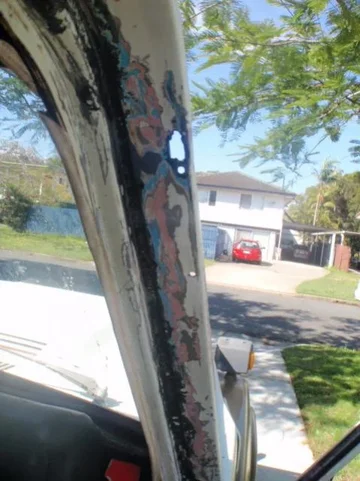

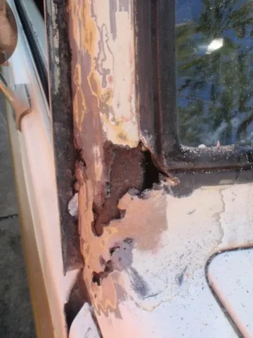

these are all of the front right rain gutter that runs down the windshield.
this scared me at first, but after looking at it and thinking about it, i should be able to get away with cutting an 'L' shape around the bottom courner and replacing it, dont think there is any curve to it?? keep you posted
would there be any adverse effects to removing the rain gutter?? the only problem i can see presenting itself is is when it is raining the rain may drip into the Pig if the window is open even a little?? another option i was entertaining is removing the gutter and trying to bend up a replacement?? im thinking that way as patching it will be very visible there?

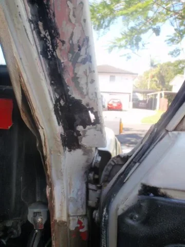

this should be connected??

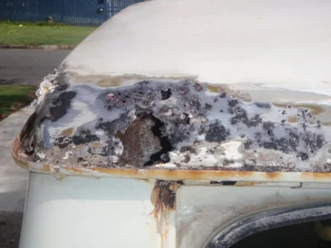

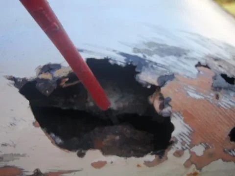

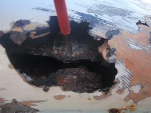

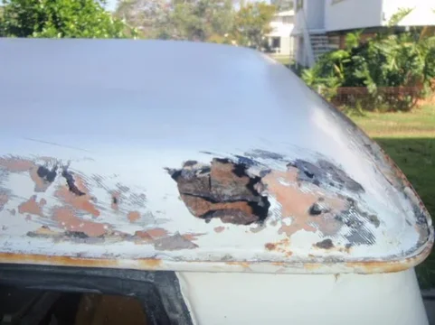

hey guys upon removing the rust on my Left rear courner of the roof i found this.... looking at it im thinking it was once a solid section?? can anyone confirm this??
im going to start a thread in reguards to a few options/ideas i have come up with, so wont ask too many Q's here :hillbilly:
fwee more pics of the rear courner on the left but both sides are pretty dead :bang:

i ended up cutting the rain gutter out completly, have a few before pics but they're too big will try resize them and post soon.

every pig I have looked at locally has the same rust on the lower windscreen frame. The body seems to flex a lot in this area, those that havent been rusted were cracked right through.

The roof rot is very typical of our aussie pigs. I have NEVER seen one with it. Our old pig had no rust anywhere else at all, yet the roof was stuffed. Cant work out why.

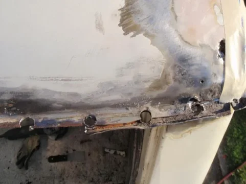

hey guys its well and truely time to post some more pics and let you guys know where im at :rolleyes:

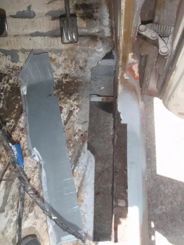

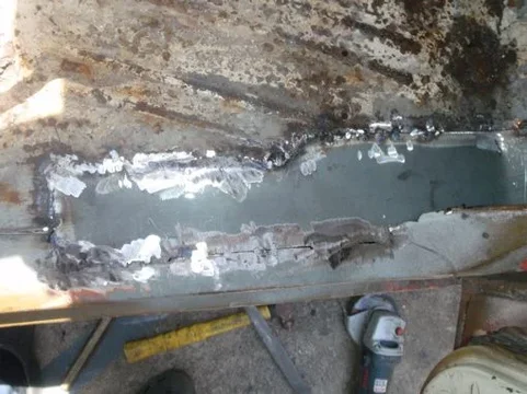

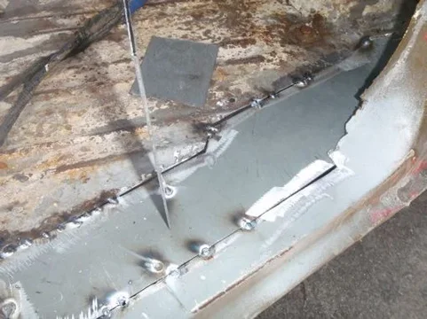

these pics are of the right hand foot well. not too bad actually body mount is still pretty intact. just the floor itself.

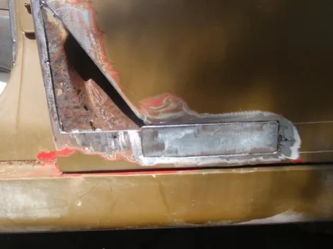

first is the hole i cut to remove the rut back to clean, weldable metal.
second is of my method of holding the new patch in place and flush as i welded it. what methods did u guys use? i was not sure how to do this....
and finally the slow tedious task of tacking it in place.

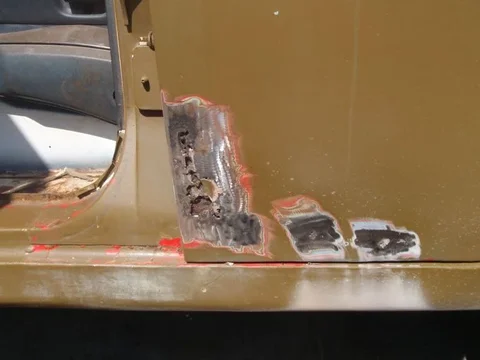

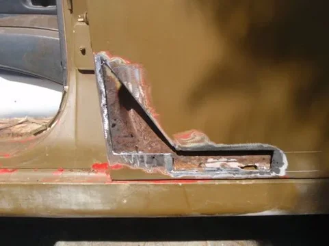

some more rust repairs.... (how many times will i say that tatement by the end of this ;) ) this time the left rear door.
the rust that i exposed with the flap disc.
then the second is the hole i cut, tried to keep the edges as straight as possible so the patch was easier to make, this a good idea?? or is it just do what works for you??
then the first of the 2 patches sitting in its final location :)

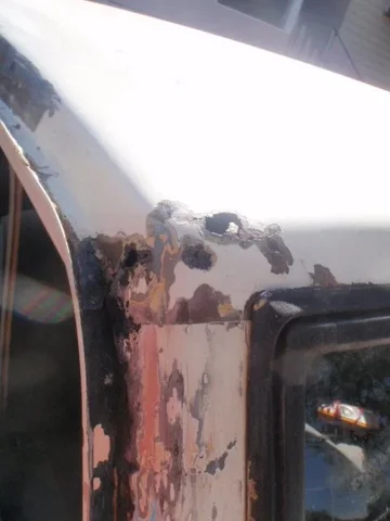

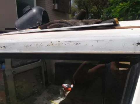

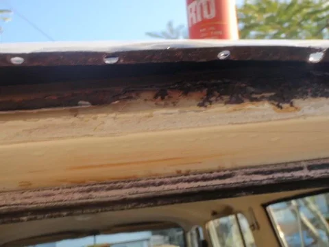

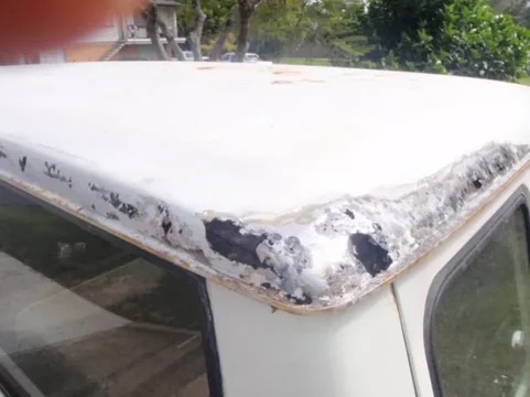

more rust.... this time the right rear roof rine rust.
before
during
new patch, just sitting there, not yet finely shaped to fit.
