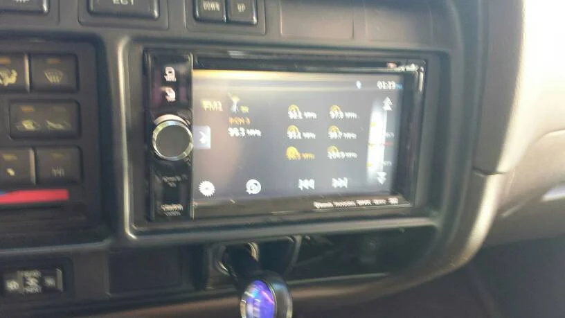

Installed new clarion deck and speakers, cdl switch. Be time for lift and lockers as soon as they show up. Removing running boards in prep for building new sliders

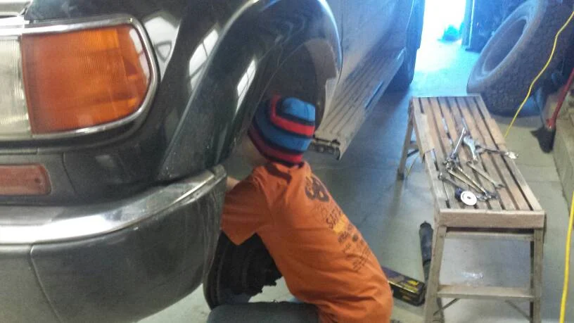

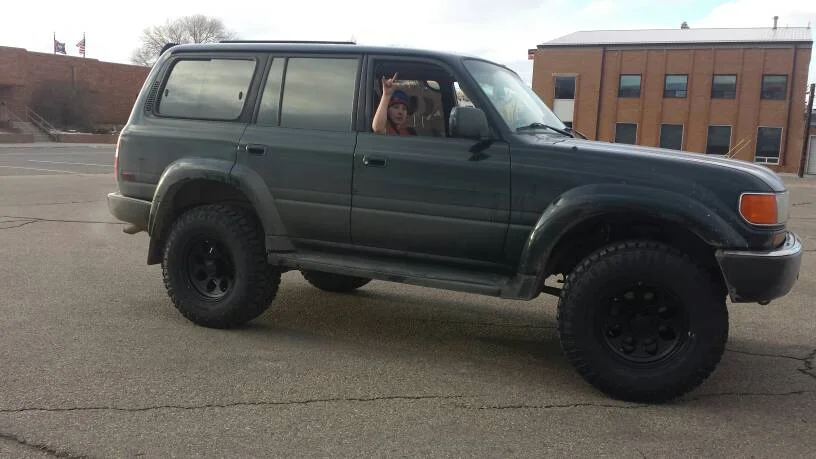

Took longer than I wanted, but my oldest boy and I finally got the lift installed last weekend. Gears and lockers, brakes next weekend...
