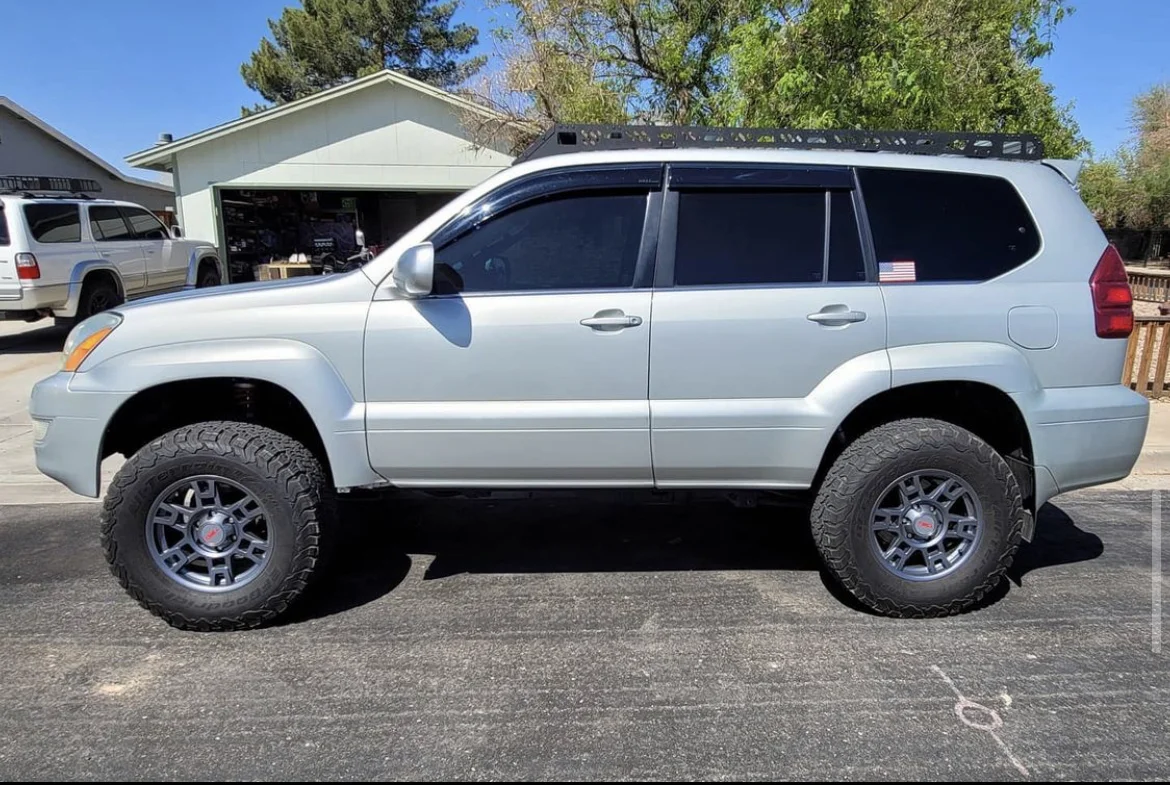

First, my GX has had the Toytec Ultimate lift kit installed along with some other supporting mods like upgraded UCA. Other than this, I'm not entirely sure all what else was done to it. While the lift is in great condition and the truck itself feels great, I'm wondering why the rear end is sagging a bit. My friend that I got it from mentioned maybe swapping rear springs for better ones, but I'm not sure even where to look for just replacement aftermarket springs or even what size spring to look for. Would a coil spacer do the same job? The GX does not have airbag suspension in the rear anymore.
Secondly, the other issue I'm having is movement in the front end somewhere. The truck just got aligned perfectly, wheel is dead straight cruising on the highway or putting down the street, all good there. My issue comes up when you give it some gas; under load, the steering wheel goes from straight to slightly off centered, and it feels like the truck tramlines just a tiny bit. I was thinking LCAs? Maybe some play in the rack? Any advice or tips as to what to inspect first, or what is common to wear and cause this, would be greatly appreciated.

(First pic will show the rear sag I'm talking about, and the others are from our first adventure.)

Looks nice. Your friend is right about the rear needing coils. I recommend you look at the dobinson cs59-675v or 677v. These are dual rate springs as opposed to linear rate.
If you ride empty most of the time (and I mean empty), then the 675v are considered stock weight but extended long travel.
If you carry some weight in the back all the time, then upgrade the rear springs to 677v. These are considered for like 200 lbs of extra weight or so. They are taller than the 675v so you get too much lift empty like 3”+ or so.
In my opinion, dual rate rear coils are great because they compress less as you add more weight.
In fact, if remember reading posts on here, the toytec rear springs are quite soft so that’s why you might be sagging.
So, just buy new rear springs and try them out. That’s an inexpensive upgrade.
And im not sure what’s up with your acceleration lean. Tires worn out unevenly?

Do you how far the front is cranked up? What is your caster from the alignment? I think 2.5-3 is the sweet spot (someone correct me if I'm wrong, my GX doesn't have a list). I lifted my Tacoma 2 inches and had some wandering problems until I had the caster bumped up. Might also be a seized caliper. I had that problem when I first purchased my GX. Caused all kinds of funky steering problems.

It it were me, I would look to lower the front slightly before I added height to the back. The pictures might be deceiving, but it looks like your front is quite high (I assume the tires are 285/70?).
Measure from the center of your hub to the bottom of the fender flare up front and post those results. There are plenty of folks on here who can chime in to compare those results to. Should give you a good indication of how much lift you have and which direction you should go (lowering front vs raising rear).

That’s a really good point to get hub to bottom of fender measurements to see what height you are at. I hadn’t considered that your front might be too high.
This is from my notes comparing where I’m at to the factory heights (as best as I can tell)
Mine hub to fender with 6112s 600# in front and 675V in rear when empty no 3rd row, no cargo, no extra weight:
FD = 22.50”
FP = 22.75”
RD = 23.625
RP = 23.875
Factory oem suspension from center of hub up to bottom lip of fender guesstimates:
FD - 20.25"
FP - 20.25"
RD - 21"
RP - 21”

- Rear springs; The rear of your truck appears to be sagging compared to the front. That can be dangerous for a few reasons; Your front does 80% of the braking, 80% of the handling and 100% of the steering. Additionally, when 4x4'ing you want to know the rear will clear anything the front clears, so having a hair more clearance at the back is better. Loaded with gear, your sag will likely get worse. You want it level or with rake at all times, even when loaded. There are many ways to achieve this. If you want level all the time (overrated IMO) look into pricisely sizing rear springs and using coil-rite airbags for leveling with load. I suggest Dobinson's as they have a lot of options. If you dont mind a slight rake (this is how I usually roll, even with airbags) then get it 1" higher than the front. That's generally good.
- Alignment - if your truck rolls straight on the highway when not gassing it, I don't think it is an alignment or tire pressure issue. Probably just torque steer. These are AWD vehicles and the front diff does what a front diff does... applies more power to one side than it does the other. Rear is the same, but again, the front does 100% of the steering. If your LCAs are bad you would usually hear the movement, it will clunk over bumps and when turning. If they are soft and on their way out you should be able to see that with a large prybar and putting some leverage on them.

- Rear springs; The rear of your truck appears to be sagging compared to the front. That can be dangerous for a few reasons; Your front does 80% of the braking, 80% of the handling and 100% of the steering. Additionally, when 4x4'ing you want to know the rear will clear anything the front clears, so having a hair more clearance at the back is better. Loaded with gear, your sag will likely get worse. You want it level or with rake at all times, even when loaded. There are many ways to achieve this. If you want level all the time (overrated IMO) look into pricisely sizing rear springs and using coil-rite airbags for leveling with load. I suggest Dobinsones as they have a lot of options. If you dont mind a slight rake (this is how I usually roll, even with airbags) then get it 1" higher than the front. That's generally good.

As far as my personal rig goes, I'm planning to lower the front down so that it's more even both for safety and also appearance. I really dislike it's current "reverse rake". It's got adjustable Toytec coilovers on it already so hopefully it'll be straight forward.
The movement when applying the throttle just seems a little more aggressive than typical AWD torque steer, but it certainly does react like torque steer. I'm hoping I can narrow this down soon before it wears my tires.
