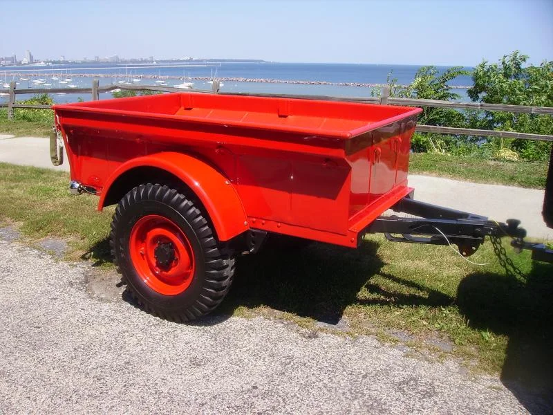

A Bantam T3C
Nice find! I like the extended tongue, a piece of diamond plate and you are set. Looks like a Bantam T3C. A little work and she will be looking like this. What is in store? matching wheels and paint?

Though similar in dimension, it's not the M100

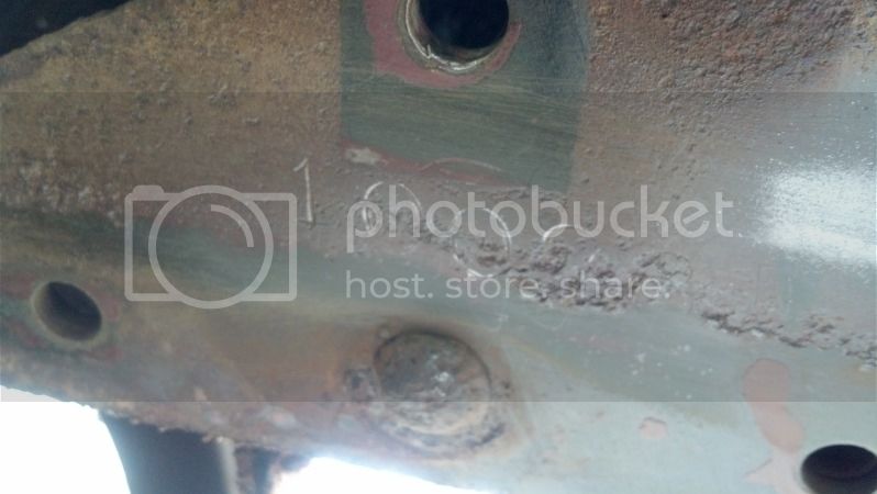

You need only check the ACM# located on the frame, at the driver side front spring hanger.
The hanger might need to be removed to see the whole #... but not always

Ok. Progress!! I dropped the left spring hanger and found what I believe to be the ACM #. Here's what I was able to uncover with a little gentle work:
