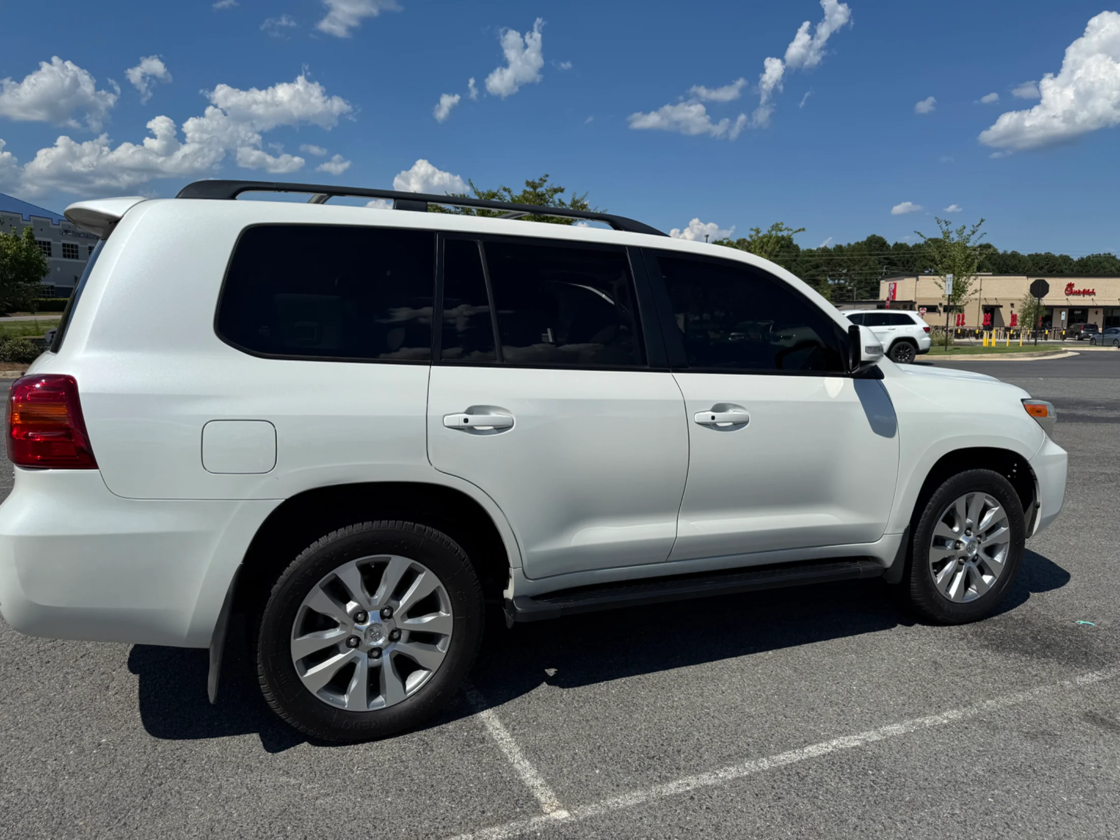

I just bought this LC200. Almost positive it has limited sequoia rims?
Hub caps are a little discolored some so looking for new ones. Anyone here have any to get rid of? Any recommendation for best place to order some?
Pull one off and check if there's an OEM part number stamped on the inside of them, then you can google it to see if someone sells them.
Those are 20" wheels off an 09-18 Sequoia. Here are the numbers for the wheels, depending on what the finish is. You should be able to take this info to a dealer and get the cap part number from that.
Finish: Machined with Silver Pockets
OE: 426110C090, 426110C250, 426110C230
Finish: Machined with Medium Charcoal Pockets
OE: 426110C240, 426110C120
Finish: Machined with Dark Charcoal Pockets
Finish: Gloss Black
OE: 426110C230, 426110C260
