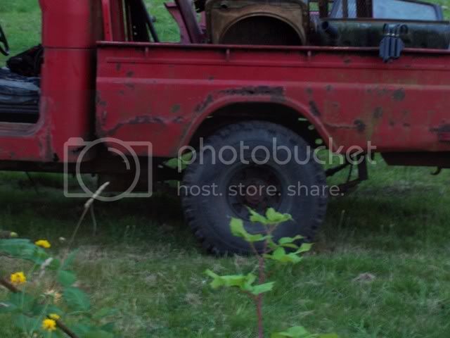

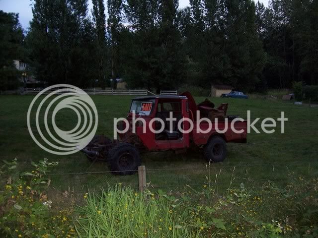

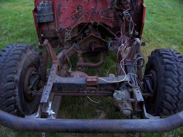

The main reason i am here is I have always wanted an FJ45 and i happened across one yesterday but have no idea what they are worth so i thought i might get some opinions from the experts around here. I took a few pictures so you have a better idea what the condition is.

That 45 looks pretty damn rough for 3k, but then sadly most of them do. The price on them always gets inflated due to the rarity, even more so when the guy actually knows what it is as well.

Considering that it will probably cost you around 15K plus a lot of your own work to bring it to a nice shape (from what I can see on the pics), saving a grand from the original purchase is irrelevant.

I went over there to take a good look at it in the daylight today and the frame looks rougher than i thought.:frown: The frame rails are full of mud and the back 1/4 of it around the rear spring hangers is swollen and flaking but the rest of it looks ok. The cab is in about the same condition as the one in the link posted above so it doesn't seem too bad.
I think i am going to talk to him a bit more about it and see if we cant come to a deal, but the only thing that really worries me about it is the frame.... oh and the roof is red and flaky and full of pinholes too, so i thinkits shot too.
