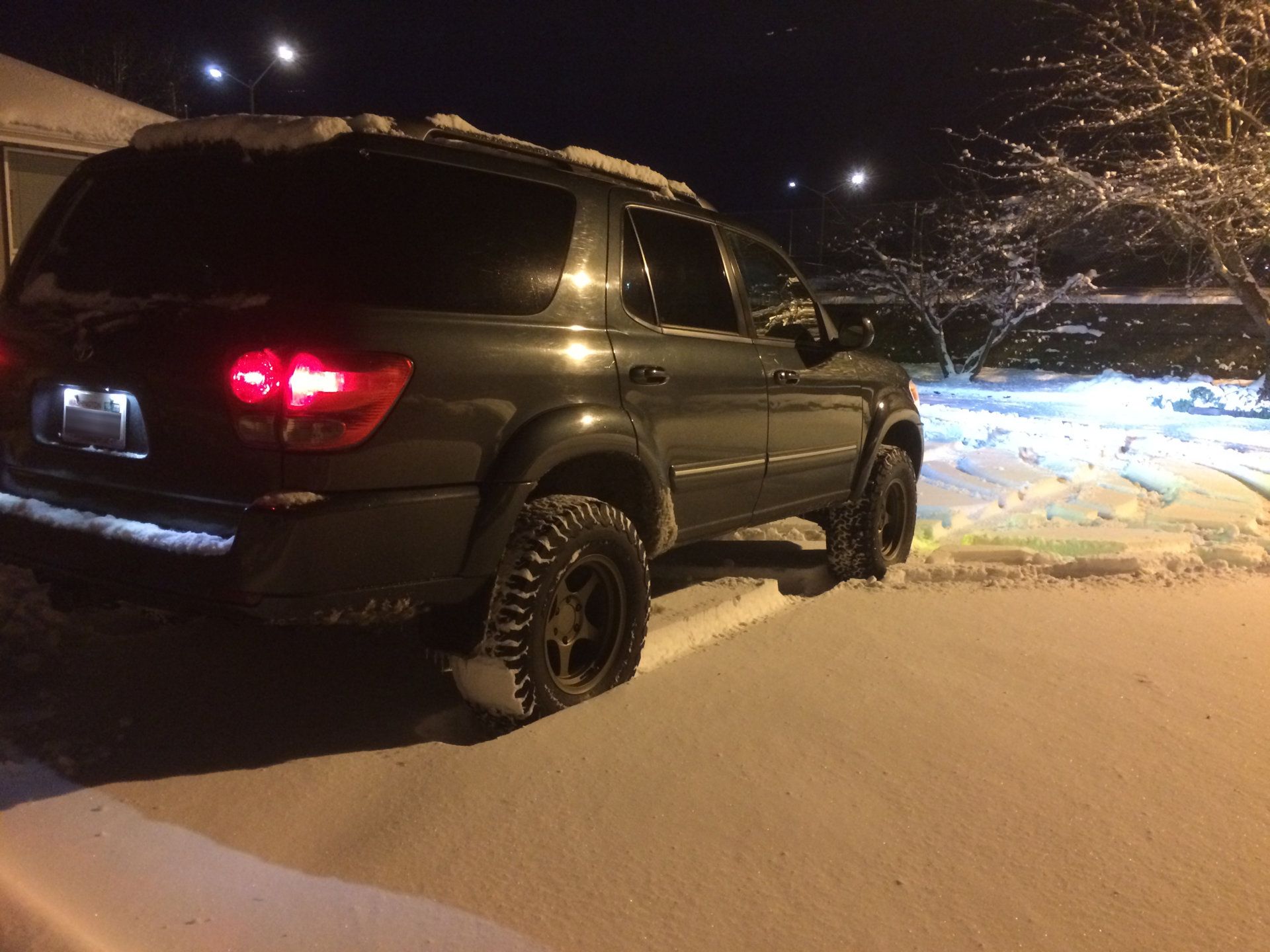

new here, figured i'd share my 1st gen sequoia
Jul 19, 2018
4
34
Gig Harbor, WA
Wheels & Suspension
Misc.
Wheels & Suspension
  • Wheels: FN Wheels, Five Star, 17x8.5 Matte Bronze (-6 offset)
  • Tires: BFG K02 285/70/17 Load C
  • Front Suspension: OME2885 x 1 Pair Coil Springs & OME90004 x 2 Front Shock Absorbers
  • Rear Suspension: OME2862 x 1 Pair Rear Coil Springs & OME60020L x 2 Rear Shock Absorbers
  • Front Brakes: RAYBESTOS 96931PER & RM Brakes EHT606H Brake Pad Set
  • Rear Brakes: RAYBESTOS 96929PER & RM Brakes EHT976H Brake Pad Set
  • Other: Total Chaos 1" Diff Drop, Inner/Outer CV mod (2x2" hose clamps over existing clamps)
Misc.
  • HELLA Supertone Horns
  • PIAA 17501 (HB4 9006) Yellow LED Fog Lights
  • Philips X-treme Ultinon (H4 12953BWX2 ) LED Bulb Headlights
  • Bluetooth / AUX Input
  • JL Stealthbox 10" W3
  • Alpine MRV-M250 Amp + Wiring Kit
View attachment 1747979 View attachment 1747980 View attachment 1747982 View attachment 1747983 View attachment 1747984
