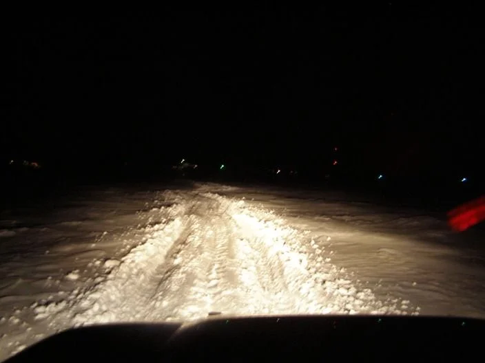

I did the Slee harness, and used 9011's for all 4 bulbs in the stock housings/lamps. Couldn't be happier and have yet to be flashed by oncoming traffic. I can see deer coming from a long ways away. And we have millions of them.
You do get a hair more reflection back in a heavy snow/rain. Not enough of an issue for me to be concerned though. $100 for bulbs and what, $45 for the harness? Best improvement I've done to the LC.
Pic probably doesn't do it justice, but they do throw some light.

2500 well focused lumens. Basically you are within spitting distance of an HID lamp with a properly focused pattern so there is not a lot of upward stray light to cause others problems.
