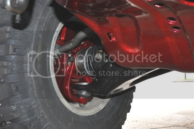

I finally bit the bullet and probably went a little overboard which is sometimes my achilles heal but... I've had this truck for 3 yrs, have built it into exactly what I wanted it to be. About as built for wheeling as a hundy can get without 35's (which may still come someday).
The truck had a tough life before I got it from a looks perspective. I didn't and still don't care. It's very nice to have something where a ding (I have lots) or scratch is no concern. What I hadn't done was address the front end. All bushings were shot, rusty this, rusty that, bearings shot, no trail spares etc...
Went to my friends at ACC (in Atlanta) and opened the checkbook. I plan to keep this truck for a LONG time so I wanted to get it done right.
The end result is an entirely new front end with Carls UCA's as my "upgrade" part. The ACC guys also now are doing powdercoating, so that of course had to be part of the fun.

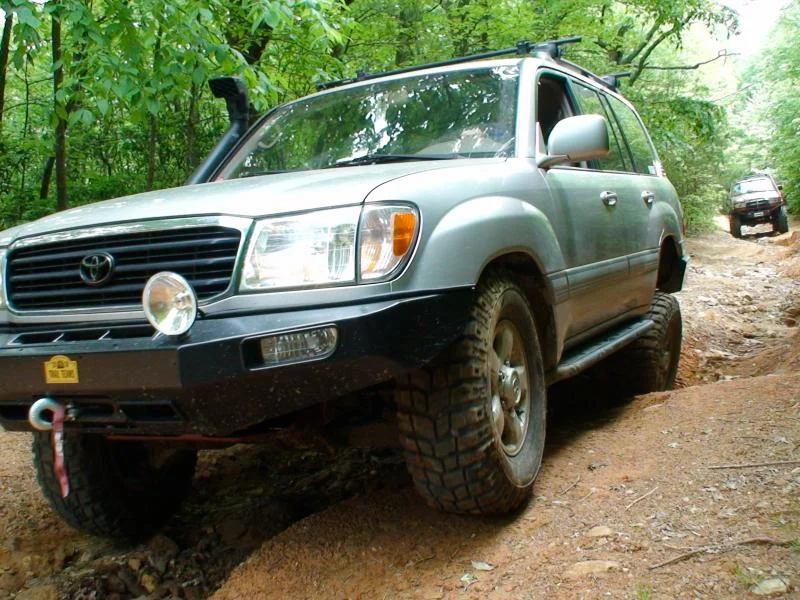

Here's the final result. Had to get pics this morning because this afternoon, it'll all be a muddy mess... :grinpimp:

Pretty sure I kept up with you "squeaky". :grinpimp:
Well, have to say I was very impressed today. We didn't do anything to extreme and I haven't seen pics of the front travel to compare, but some of the comments were that it was noticable. Right now the shocks are limiting the travel of the UCA's so I probably have 1-1/2" extra now, and could get more with different shocks.

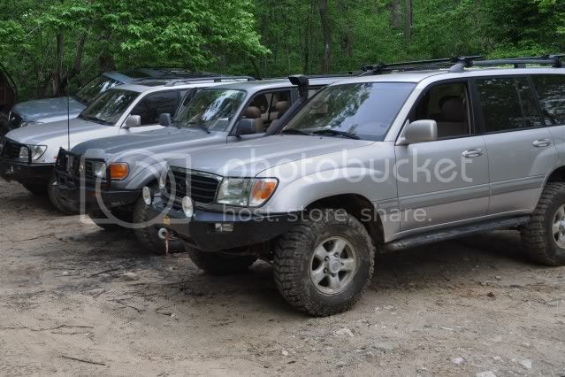

Here's how it sits from a distance...

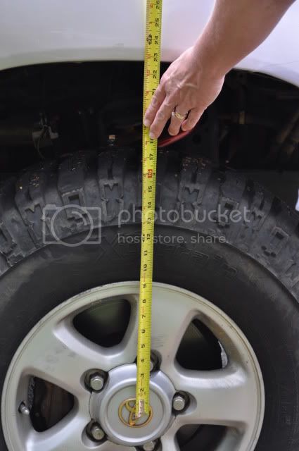

I measured middle of the axle to the lip of the fender at rest and it's at 22.75"

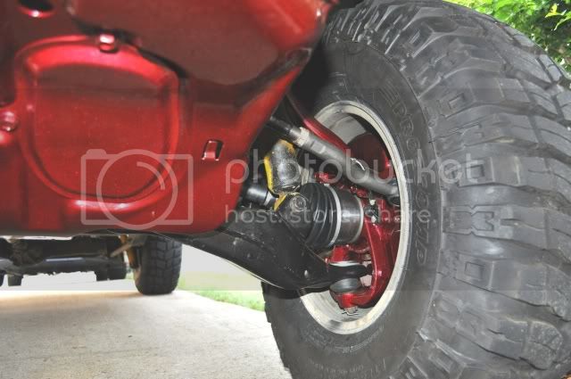

The UCA's look like this...
I measured at just about full droop and got a measurement of 24.75". The full droop is limited by the shock length, not the UCA hitting the shock.

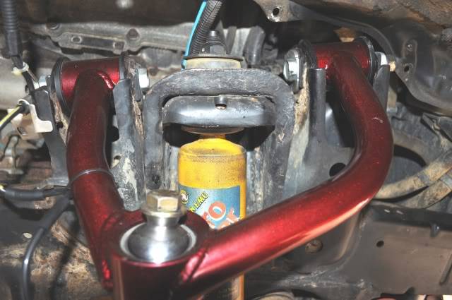

UCA's look like this, but I just noticed the angle of this shot sucks... there is about 1/2" of play before the UCA hits the shock... I know it doesn't look like itb.
So, with my Tbars cranked to where they are, I have 2" of droop left.
