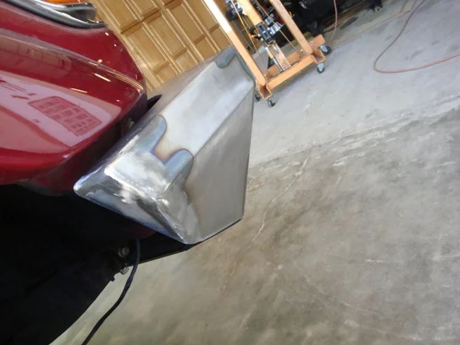

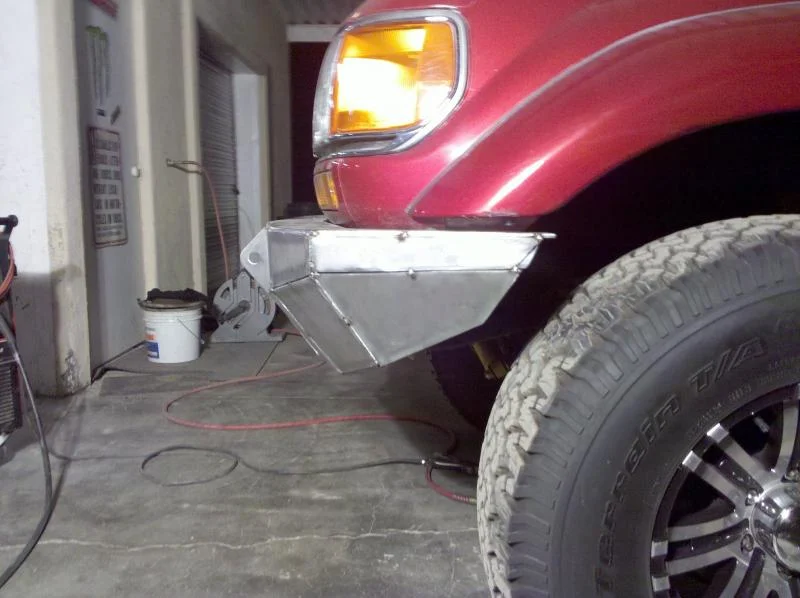

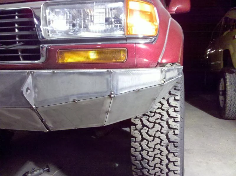

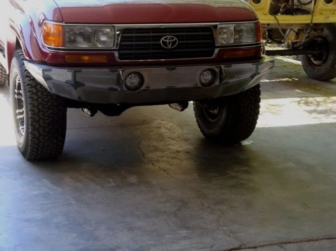

I finally went for it and am having Tommy build me a front bumper to my liking. It is a heavier guage than the ARB and sits in closer to the body for better clearance. The eyelets are mounted directly to the frame. He cut out most of it with his plasma cutter and went on his CAD to draw it up. I gave him several ideas and then told him to make it the way he thinks it should. He has a good eye for these things. He has the hoops still to make and build the inserts to hold the lights within the bumper. Hopefully powdercoated and done by next week?
heres some early on pictures...gots alot more to do!
ill post them as I get them.

Whoooo, now I can sleep. Are you going to have drier protection from underneath? The ONLY thing I dislike about the shortbus I have. I will eventually get a relocation kit for it. It looks like alot of time to piece all those together and tack. Are you going to keep the hard lines where the pieces come together or smooth them out? Any hoops? Its gonna look awesome I bet.

Yes, hoops/lights/antenna are going to be added. Also the bumper is designed to angle back and cover the receiver /dryer. (as you notice you can not see it in the picture) more plating will continue back from underneath to fully cover the RD (and across the entire bottom). There will be some extra bracing as well to add extra strength. The lines will be filled and smoothed out somewhat before powder.
WOooo......Will it be winch capable?
No Phil, and thats the reason I had it built. there really isnt a bumper out there that fit what I was looking for (except for the shortbus) that was built w/o winch capability. Besides, this way I can build it for my tastes, however questionable :D

On a more serious note: those D-ring/shackle attachment points... maybe it's just me, but in the photo they look to be on the light side if that truck would ever need a pull from an angle...

Yea, he isnt done with those. He plans on finishing them up thicker/stronger just like the exact same pull points he did on my rear bumper.

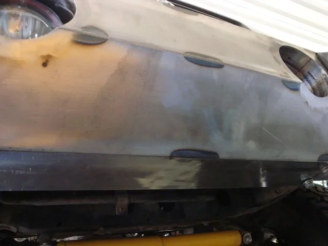

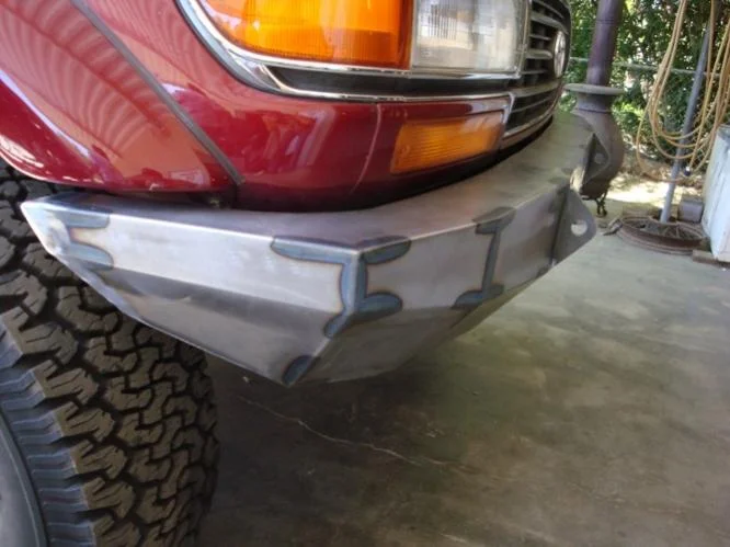

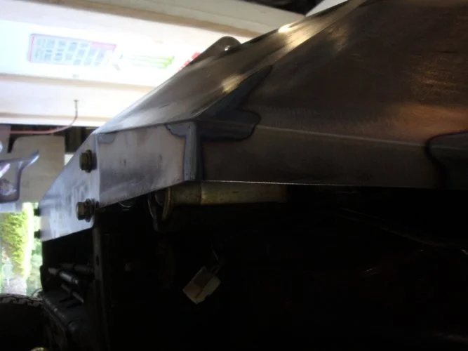

Here some of the latest: After looking at it, I decided to forgo any hoops and leave it like it is. Hoop-free!
Compared to my previous bumper, for me the better approach angle, better protection (thicker metal and the bottom wrap under plating), and less restriction of the lights, air flow, etc. It's time to show her face!
IN any case it make me happy and does what I want. Tommys gotta finish the pull points, some minor electrical, aim lights, clean up, and then to Powder on Monday! :bounce::bounce2:
Pics show the under protection, the inset lights, the closer-to-the-body design.
