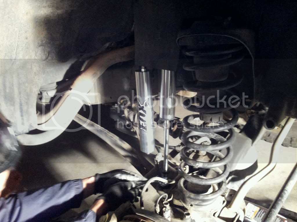

I was in the area and visited DS last Wed. Marco helped me out with the required measurements because my jack at home just won't do the job. I ended up purchasing the setup from Downsouth that same day. They arrived Friday so I decided to install that evening.
Ran Cleghorn Sunday and noticed that at full stuff my tire was rubbing the resi on both driver and passenger front. Drive side was worse,one clamp ripped off and needed zip ties to continue on. Need to rethink where to mount them.

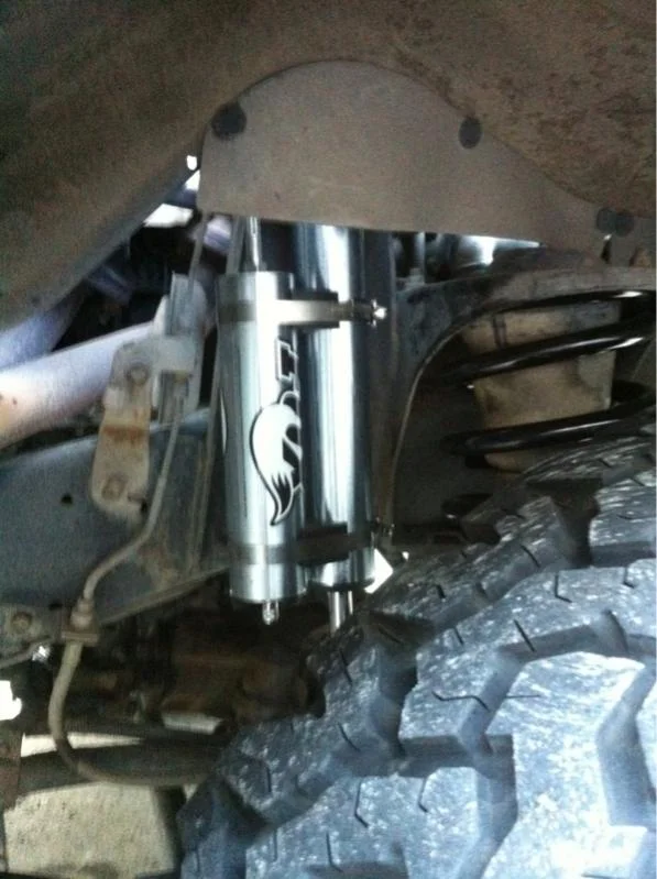

Where did you end up mounting your reservoirs? I just got mine on and with the steering turned to full lock on flat ground the tire is close to the reservoir- at full stuff I'm sure they will rub. Here's a crappy cell phone pic- I mounted the reservoir on the back side of the shock pretty much parallel to the inside face of the tire when the tire is straight. I wanted to rotate the reservoir back more but the hose would be touching the shock mount. Any tips would be appreciated.
attachment.php
After I almost lost a resi I turned them towards the shock mount. Rotated mine back as far as they could go and noticed the hose rubbing the mount. I protected the hose with some fuel line. Slit down the middle, wrapped the hose where it was rubbing (both sides) and secured with small zip ties. I had to do this to my AC line on my FJC. I ran a moderate trail since then where I tested flex and stuffed the tires pretty good. Resi on both sides survived. I was thinking of somehow mounting in the engine compartment as a permanent solution.
