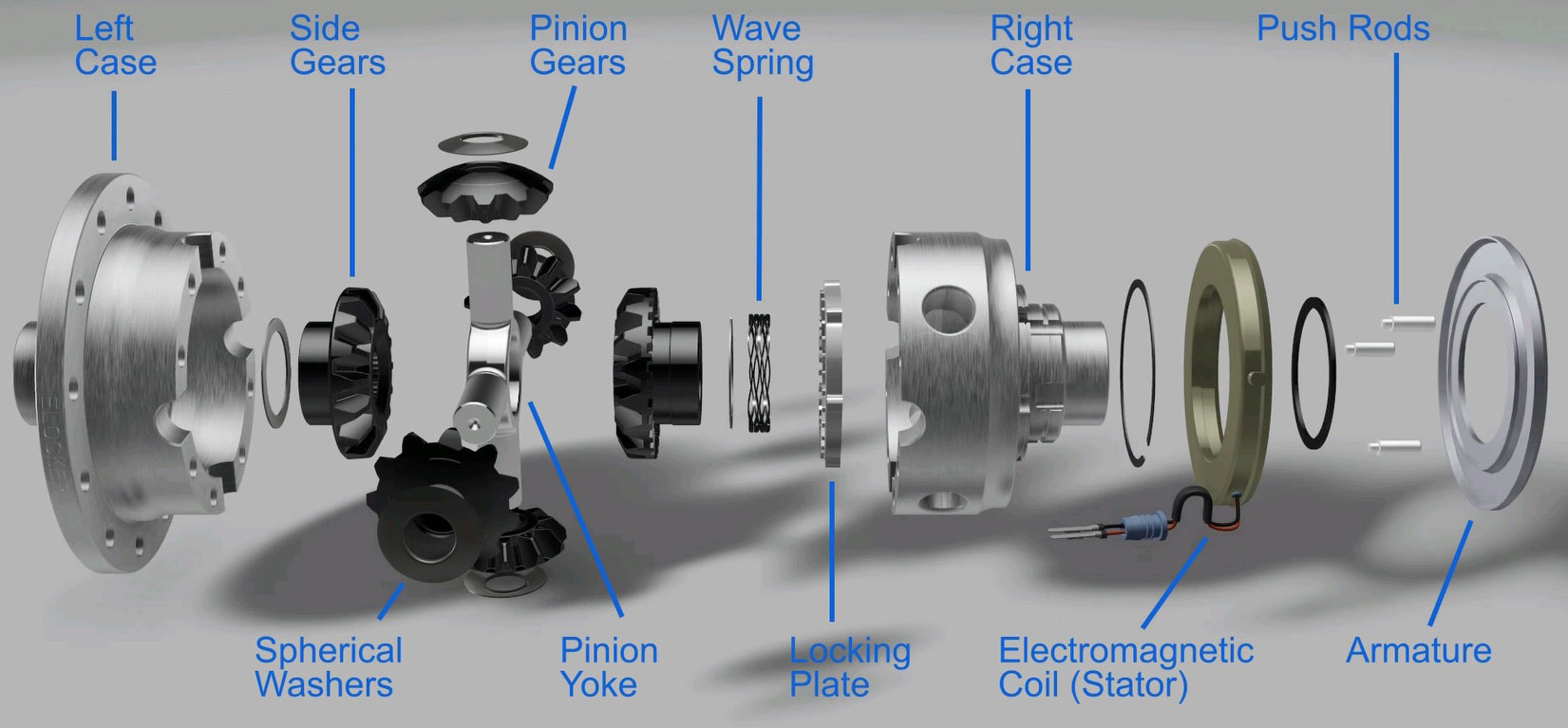

Yeah. I don’t think this failure has anything to do with locking while moving. The carrier absolutely has to be moving to lock. The locker CANNOT lock at a standstill. The only thing that will happen if you engage the locker at a standstill will be the magnet energizing. The carrier has to physically rotate to allow the engagement pins to ride up the ramp/cam collar. It absolutely positively cannot lock if not moving.
I try to anticipate and engage my lockers when rolling up to an obstacle. At that point both wheels are turning together at the same speed. I can’t see how that could ever be detrimental to the locker.
I do run a lot of trails where I lock the rear for the entire run. Maybe that’s too much stress for these little lockers? I dunno. If so that’s just more suckage 😬

For those that don’t quite understand how the Eaton e-locker for our trucks works here’s a good video.
It’s always been my thought that if the truck was moving and for some reason the locker wouldn’t couldn’t physically engage due to bind or differing wheel speed the pins would just override the friction/clamping force of the magnet not causing any damage. There is no physical linkage. It’s just magnetic. And once the pins cam all the way for engagement the magnetic friction is overwhelmed anyway allowing the collar to continue to turn with the carrier.
It doesn’t take much to break that bond. Just a small indentation in the cam will cause the pin to hang thus causing the cam to continue to turn and not engage. That was my first e-locker failure. That was replaced under warranty though. Although labor was not obviously.
