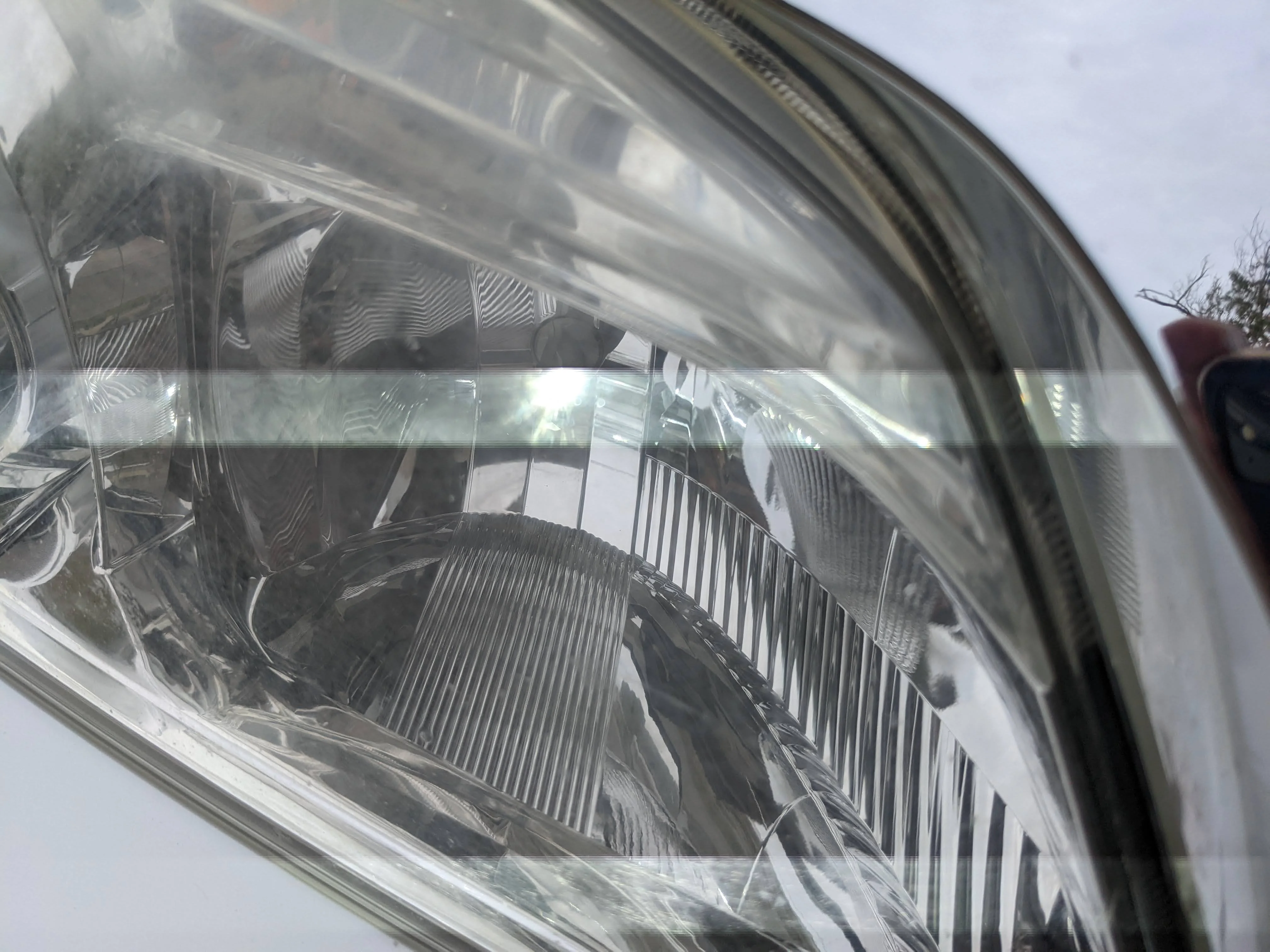

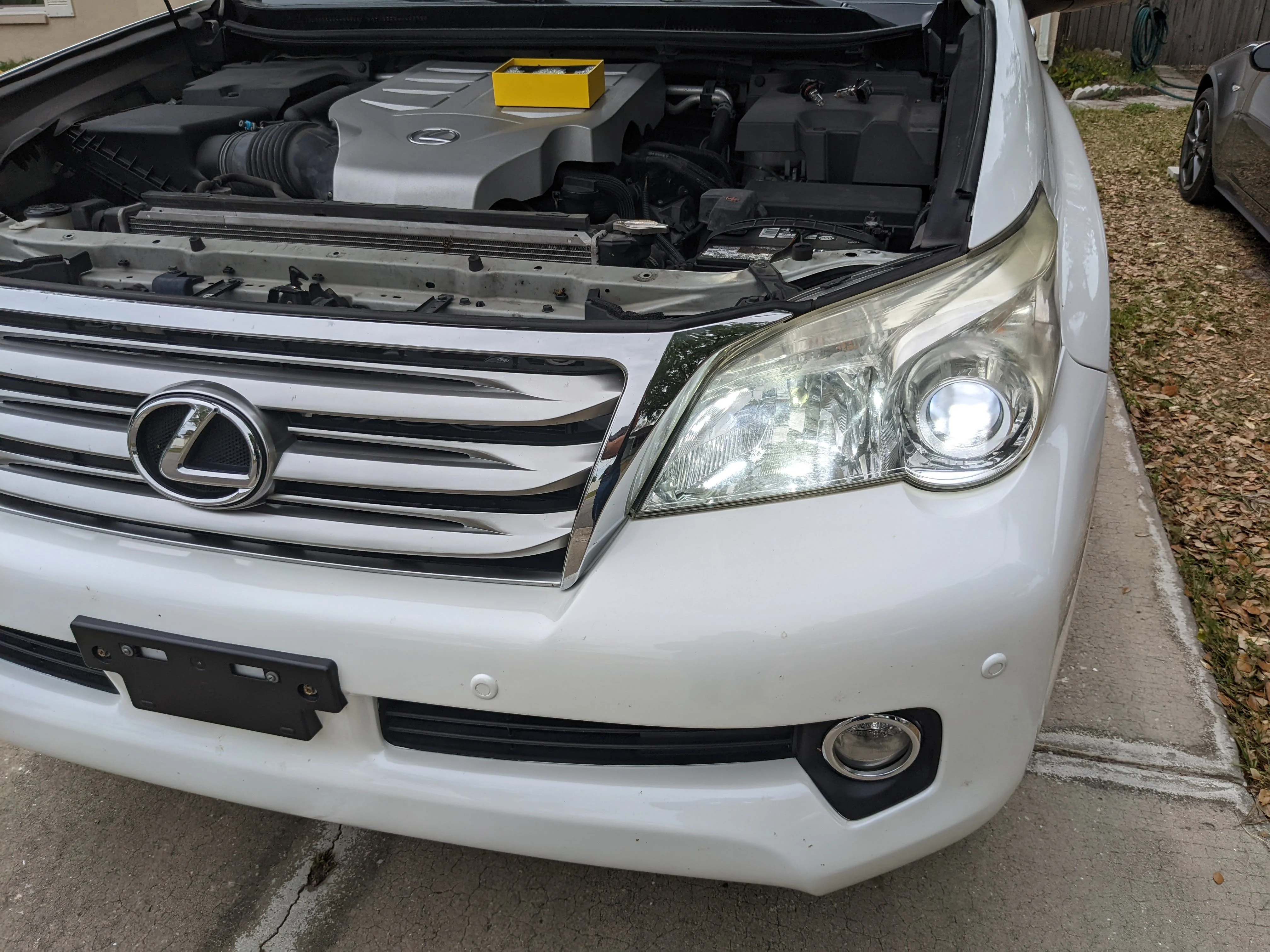

Installed Auxito DD-10S bulbs (size 9005) today. Above is a comparison between the new bulb passenger side and the old halogen on the driver's side. I just got my truck a few weeks ago, so I have no idea how old the original halogens were, but there's some brown stuff on the inside of the glass...
Anyway, controller and fan are all integrated into the bulb, nothing extra dangling out of the lamp housing. In DRL mode I couldn't see any flickering, but when I tried to take a picture with the camera there was a rolling effect just as when other CCD devices try to take a picture of LEDs:
Was it blinding in DRL mode? No. Because it's daylight and it's already bright out.
Does it step up in brightness in high beam mode?
To my eye yes, but I'm hoping it'll become more obvious when it finally gets dark out.
I bought direct from Auxito, after having purchased a bunch of stuff from Amazon, this particular set costed $55. The shipping label says it came from the "U SKY3 WAREHOUSE" in Hebron, KY, although the website has a bit of an Engrish feel to it.

So far I switched the fog lights and low beams with Auxitos; I started out with Auxito B3F (H11 size) for the fog lights, they were a bit of a dud in terms of brightness, about the same as stock but that turned out to be a good thing for fogs. That was about $25.
Amazon product ASIN B09BCNDL74
I then went back to the video posted previously and got the Auxito Y13 (also H11 size) for the lows, and those turned out much better/brighter, lamp housings are aimed a bit down and it's perfectly fine, nobody is flashing high beams at me.
Amazon product ASIN B07WD6G42D
I put in Sylvania LEDs for the front parking lights - $14.75 - I was going to buy them at Advance Auto Parts down the street, but Amazon was cheaper 🤷‍♂️
https://www.amazon.com/dp/B01BDWLZHU?tag=ihco-20
I used Oxilam 7440 bulbs for turn signals (front and back) - $22.50 x 2
https://www.amazon.com/dp/B07Q8RZRZV?tag=ihco-20
Finally Auxito 912/921 bulbs for the reverse light - $12
https://www.amazon.com/dp/B0728DYR9H?tag=ihco-20
So far, everything works, and everything has that modern, 6000K white color that really helps the truck look, in my opinion, great. I also can see significantly better at night.

Are these all plug and play?
I don't use my DRLs but have been incredibly happy with the high beam output of my VLEDs on my '12. Not cheap though
They're all plug and play. Pretty awesome.

Auxito DD-10S bulbs (size 9005).
9005 HB3 LED Bulb Forward High Beam Bulb 12000LM CANBUS Equipped with advanced ZES LED chips - https://auxito.com/collections/10s-series-headlight-bulbs/products/9005-led-headlight-bulb-52w-12000-lumen?sscid=41k6_syyzi&
Currently on sale I think for $50, I can't see any flickering from 10 ft in DRL mode, and good and bright in high beam mode, no error codes.
To be clear, I've got a 2013 GX, so DRL and high beam are the same bulb. The DD-10S is a plug and play solution, everything is built into the bulb, no dangling controller. I'm giving all of these until the end of the month, if I still see good performance I'll put them up in the Aftermarket guide thread.
