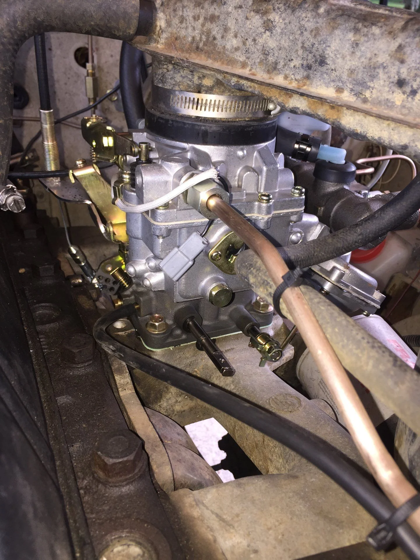

New carb - can't get RPMs down from 2500
Agree but does the '70 have a fuel solenoid (F engine)? This carb is really for the 2F, and this is my first time tuning/installing a new carb.
I see the wire on the carb, but see nothing it attaches to on the F engine. (I am off to the FSM to research the answer to this)
Assume I know nothing.
I will say I have it idling steady now. It's idling too high still. Tach meter on the first spark plug wire reading about 1650. Adjustments to timing screw and to mixture screw have little effect.

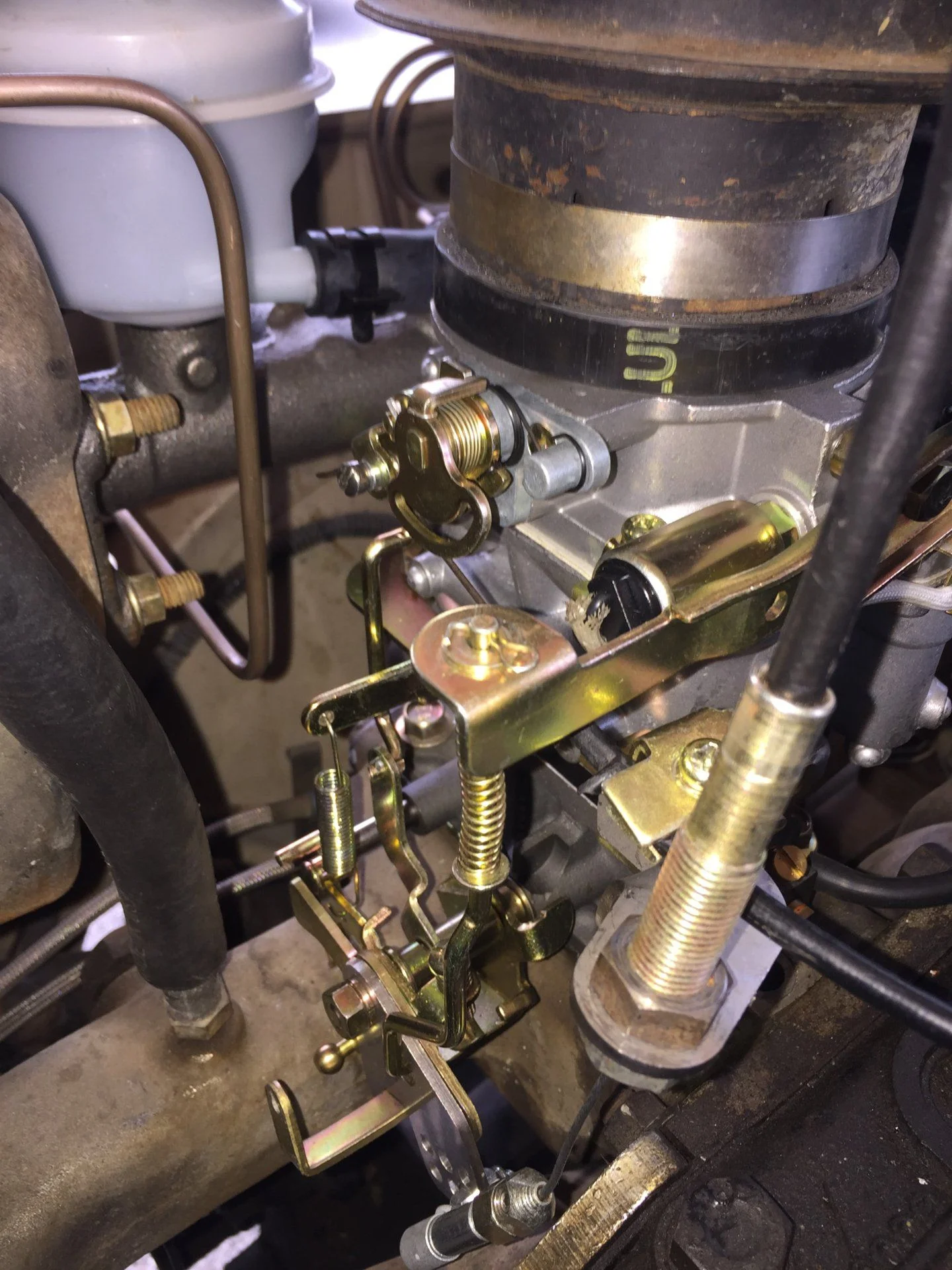

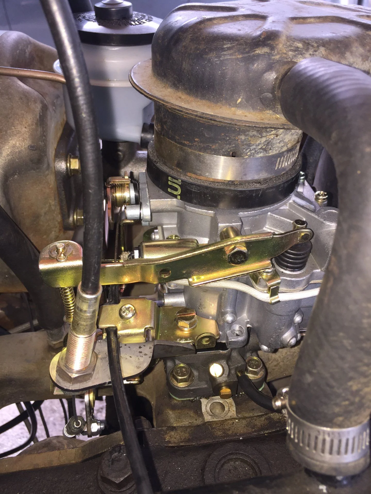

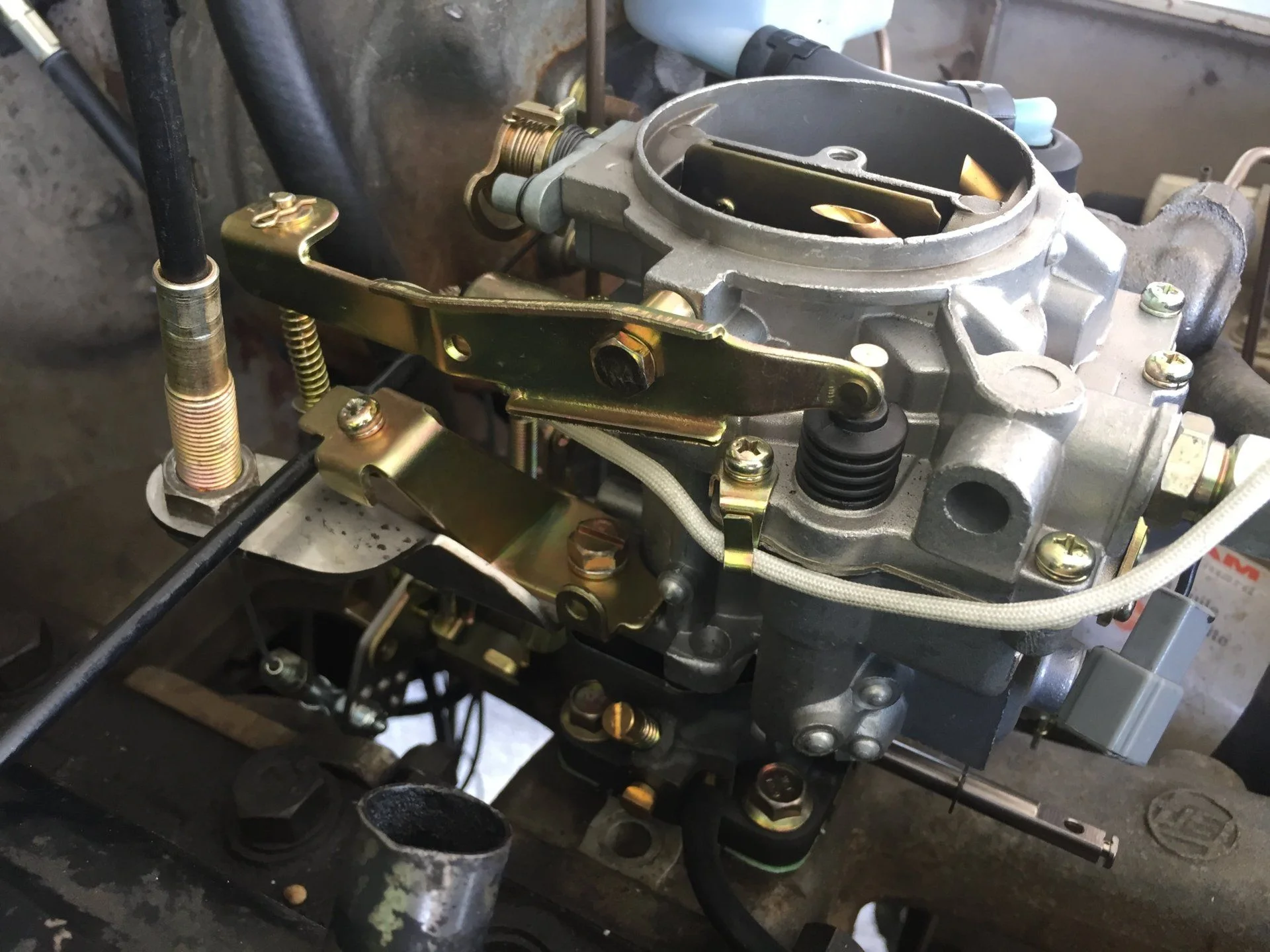

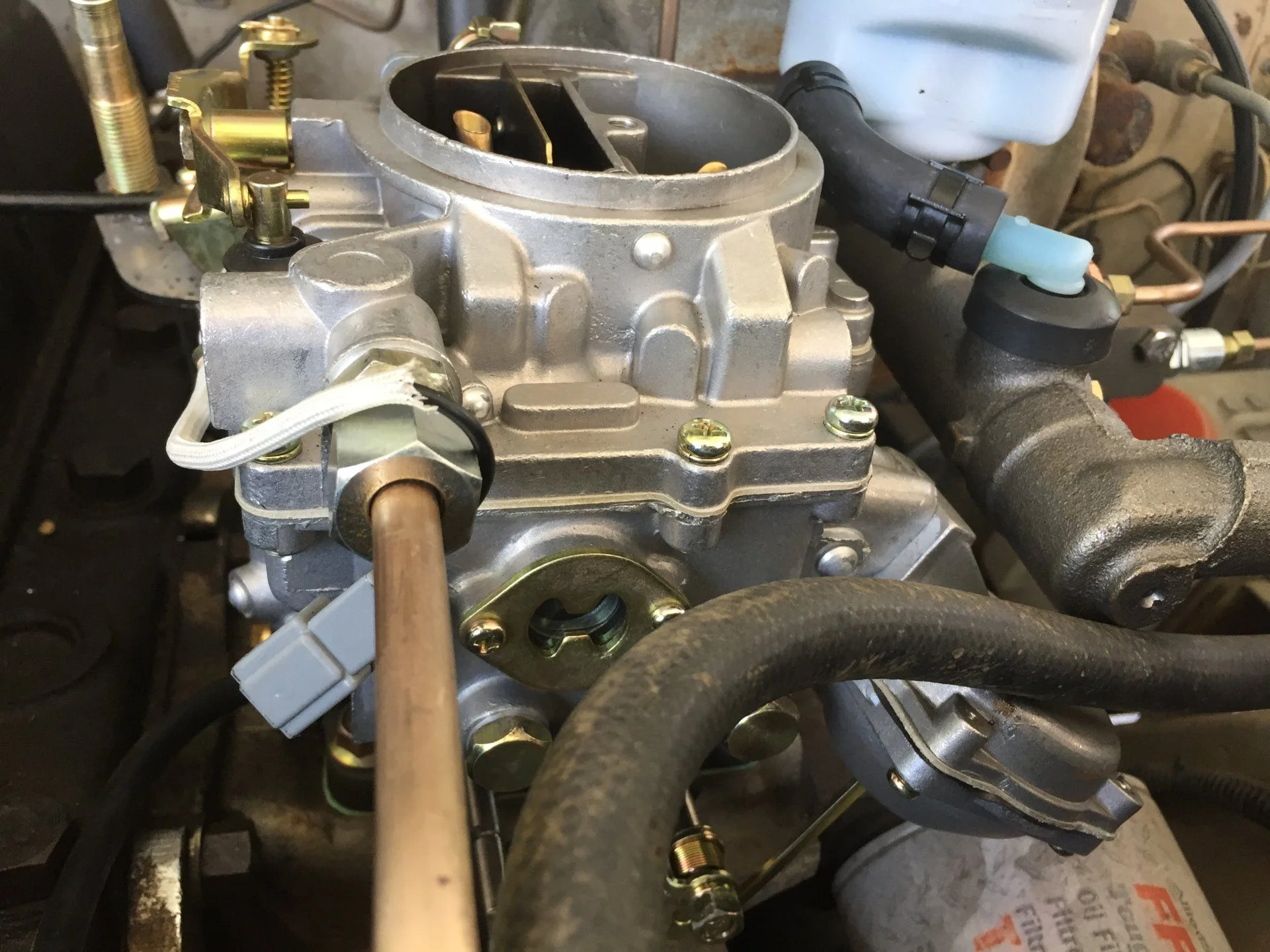

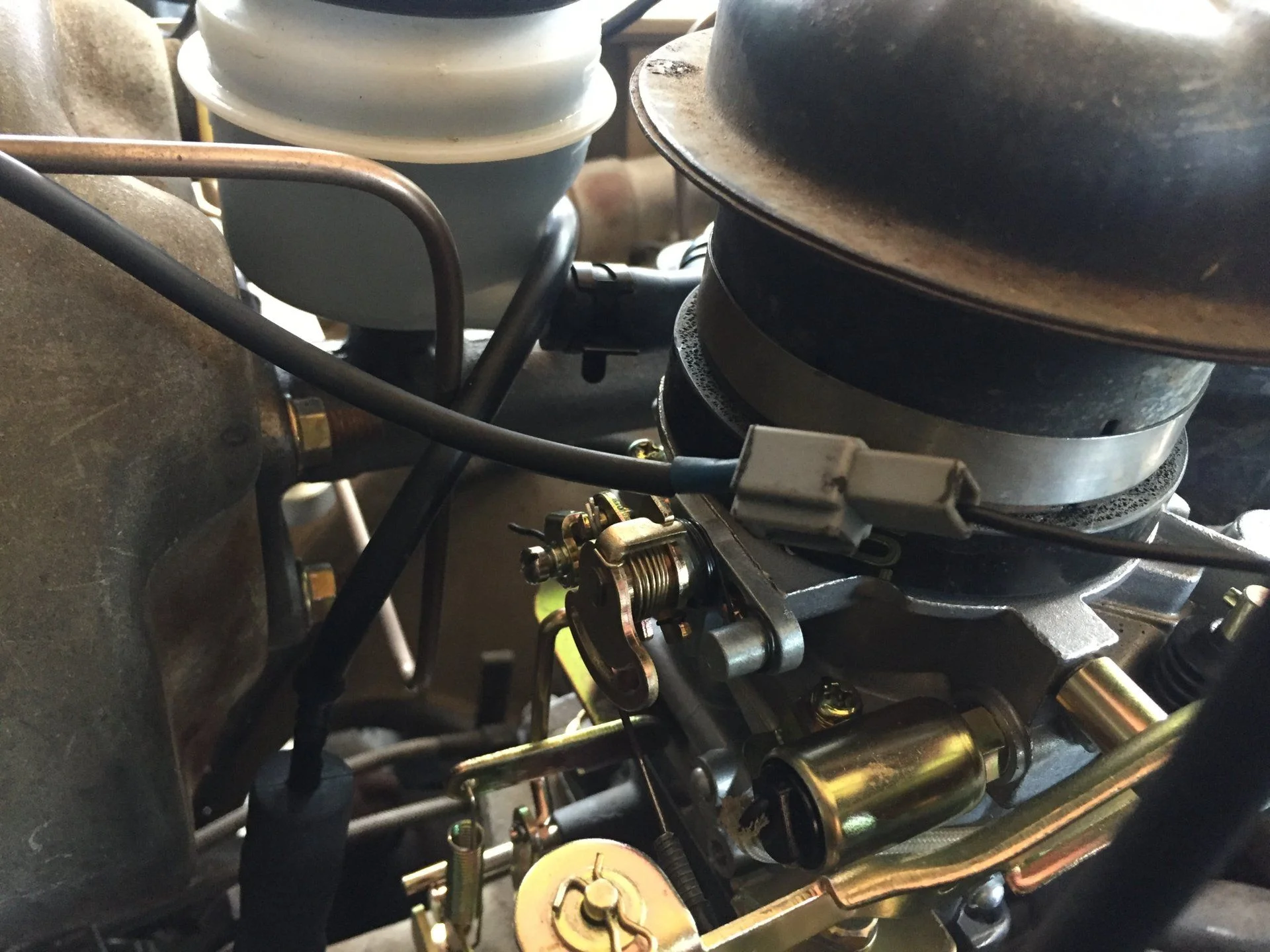

Hooked up the solenoid wire. Ensured it has switched voltage.

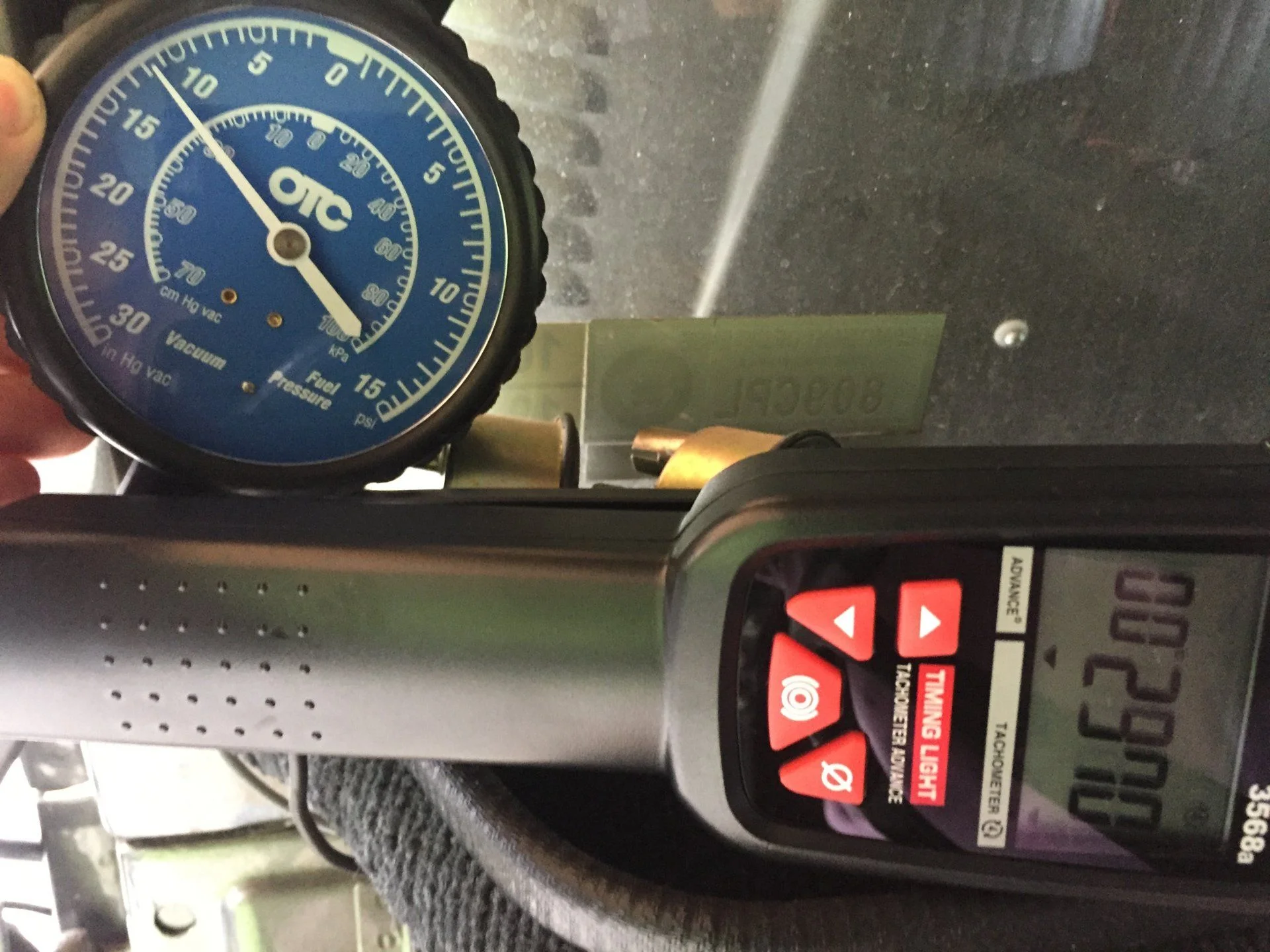

Now however I have RPMs at 2500 and vacuum at 10 in Hg (too low - must be a leak. Does that cause high RPMs?).
Can’t get RPMs to drop. I’m missing something.
Photos of carb were taken before solenoid hooked up
If you are trying setup your carb, vacuum is kinda moot when the rpms aren’t at idle (650-700).
Vacuum plays at idle rpms and when diagnosing tuning problems.

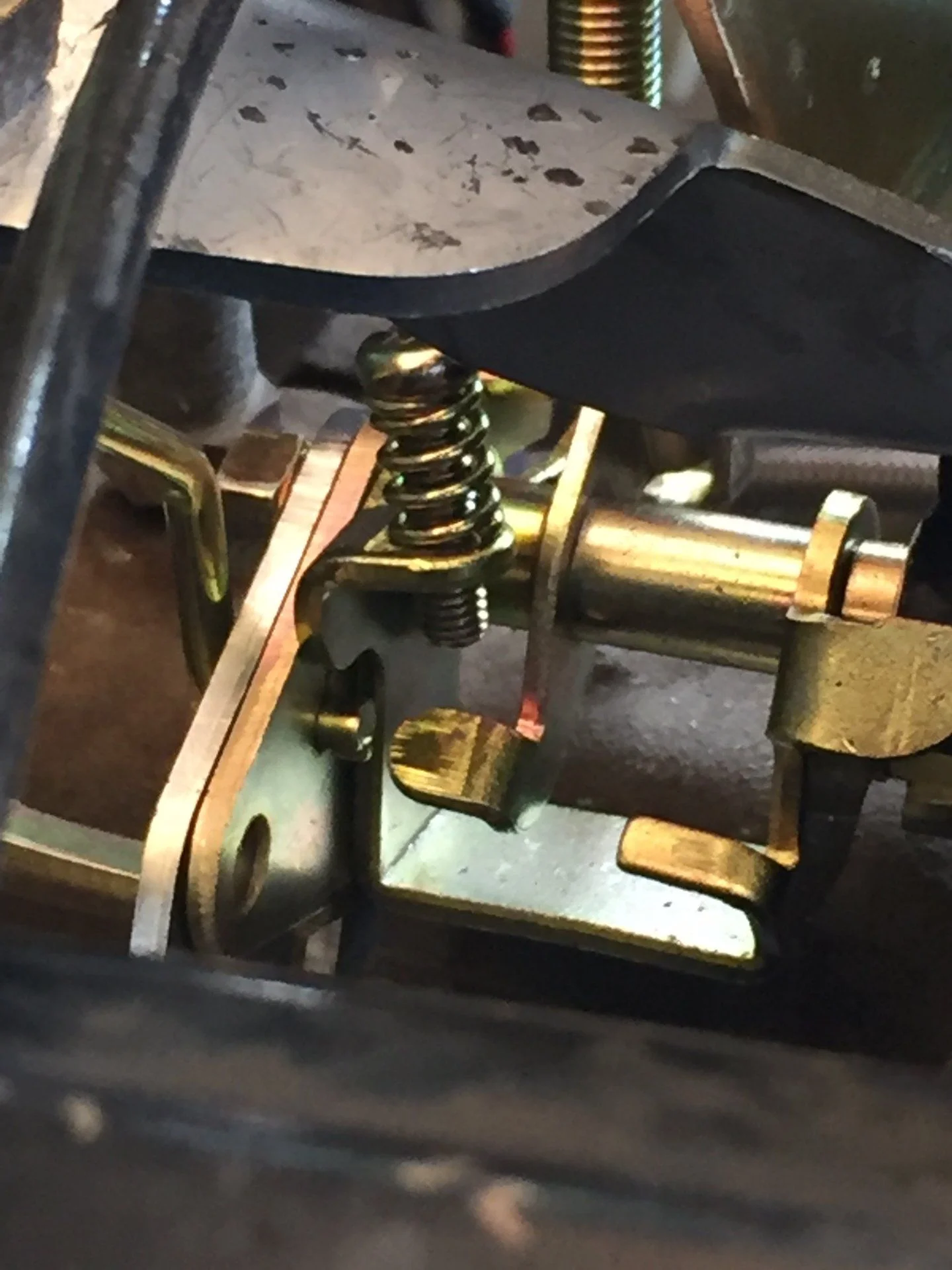

Make sure your linkage isn’t binding and that the fast idle screw is properly adjusted.
Perform the lean drop method, adjust the idle, repeat... repeat...
Read from post #3 HERE - lean drop is discussed, as well as carb adjustment screws... not sure how your’s relate to Aisan.
While vacuum “value” doesn’t matter right now, make sure you don’t have a vacuum leak... spray fine mist water, carb cleaner, etc. around vacuum connections, brake booster, manifold gaskets, base of carb, etc.—- if idle increases, you’ve found a leak. Don’t forget the dissy vacuum advance module, if you have one.
Is the fast idle screw supposed to be touching the bracket below it? It isn’t.
And with the choke in or out it never touches the bracket below. Is that normal?
I’m going to unhook the throttle cable and see if it drops the RPMs.
