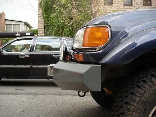

new bumper
Very nice work.
A little bulky for my taste but I'm impressed with the fab.
very nice work and welcome
wish i had the skills to be able to fab up my own bumper like that. it looks great!

That is a sick bumper. I'm definitely a fan. How is it mounted to the frame? and do you have more details on how it was made possible start to finish pics as someone else had asked. If you decide to make another one consider me first on the list, I'm in NY quite often.

Impressive bumper, you did a great job.

Pretty nice, looks like it would provide a nice approach angle as well.

Do you have any durring construction pictures, cause that is one of the sweeter looking bumpers I've seen - made by an individual or company.
I will round up the drawings and pictures I have and lay them out in some understandable way.
is this a helpfull angle?
Are there a lot of gusset points behind the bumper? Don't get me wrong, it looks great, but I'm thinking a strong winch pull could deform it without some lateral strengthening. Hey, I ain't no design guy, so what do I know.
BRKLYN1, I was thinking of more of a head on shot. Then someone could work with that to transplant a rounded hoop onto it , kinda like what Slee has .. or even Chris Geiger's, whose hoop angles forward slightly.
TY
Appreciate the effort .. can you fatten that out a bit more .. and round the corners, so it looks like tubing that is bent? Rather than square tubing.
Thanx

Look under Macneill's poser pics album for a look at the type of tube I was thinking of .. it's on his 100.
the winch is on its own independant mounting plate so only the force of the rollers is on the bumper. a plus to this desingn is that you can remove the bumper without removing the winch. as for thr guset points the front 3/16" plate is welded to the 1/4" mounting plate that contours the shape of the bumper. that combined with the strenght created by the folds it should be good. I will run tests in my finite element Analyses super computer that is in my glove box and see.(did i type that out loud)
