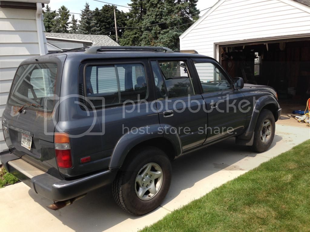

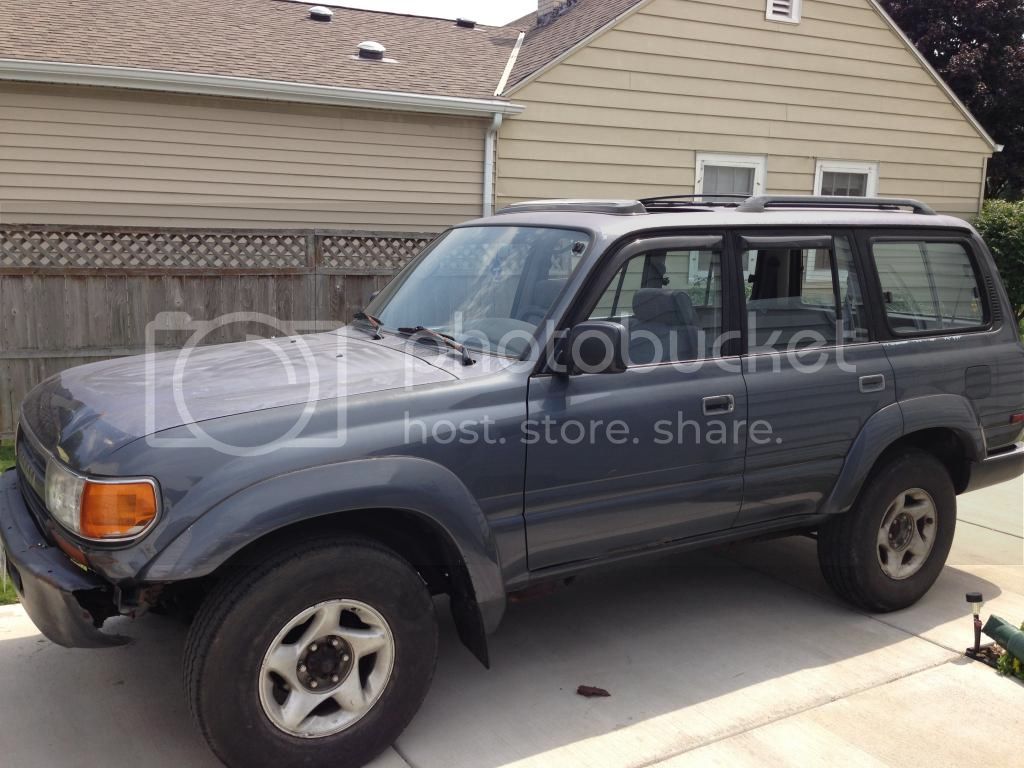

Hello my name is Brian and I live in Wisconsin. I've always liked old Toyotas and stumbled upon a landcruiser being sold by an agent of an estate sale on Craigs List. I went by casually to check it out. It was listed at $1700. I test drove it, for fun, really and an hour or two later decided that I needed to buy it. So, I bought the landcrusier for a little under $1500 USD. It's been really fun to drive so far.
Here are the pics...
